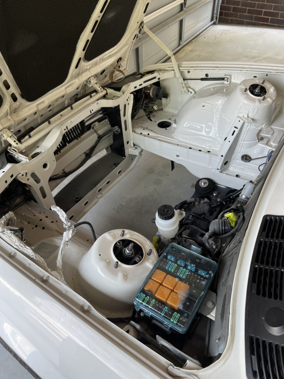

    A few more pics of the finished product.

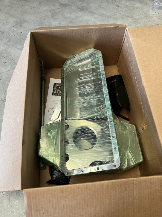

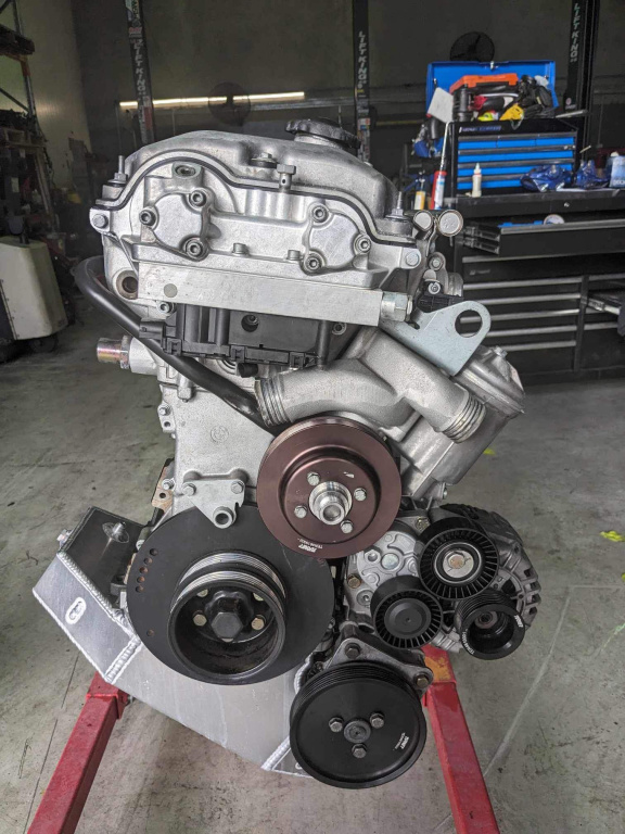

        Harper fab front sump arrived - next step is mock it up on the motor:

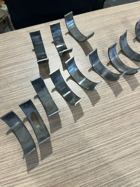

        Rod bearings/bolts have been replaced with ACL bearings and ARP bolts. Stock bearings looked ok:

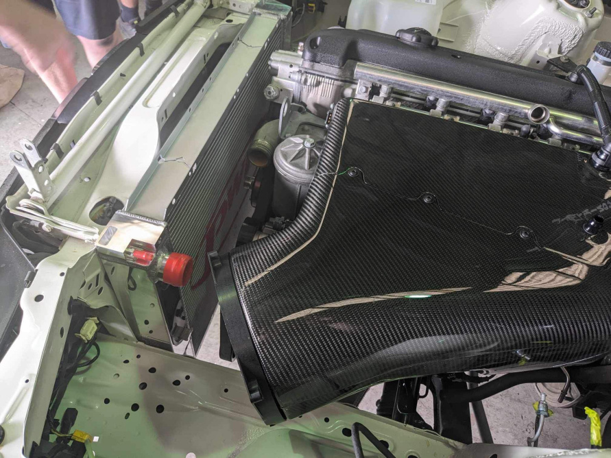

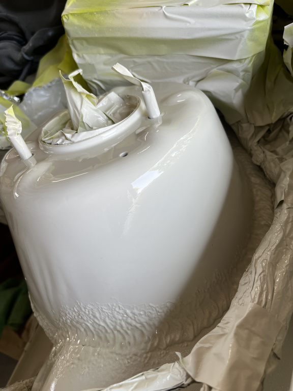

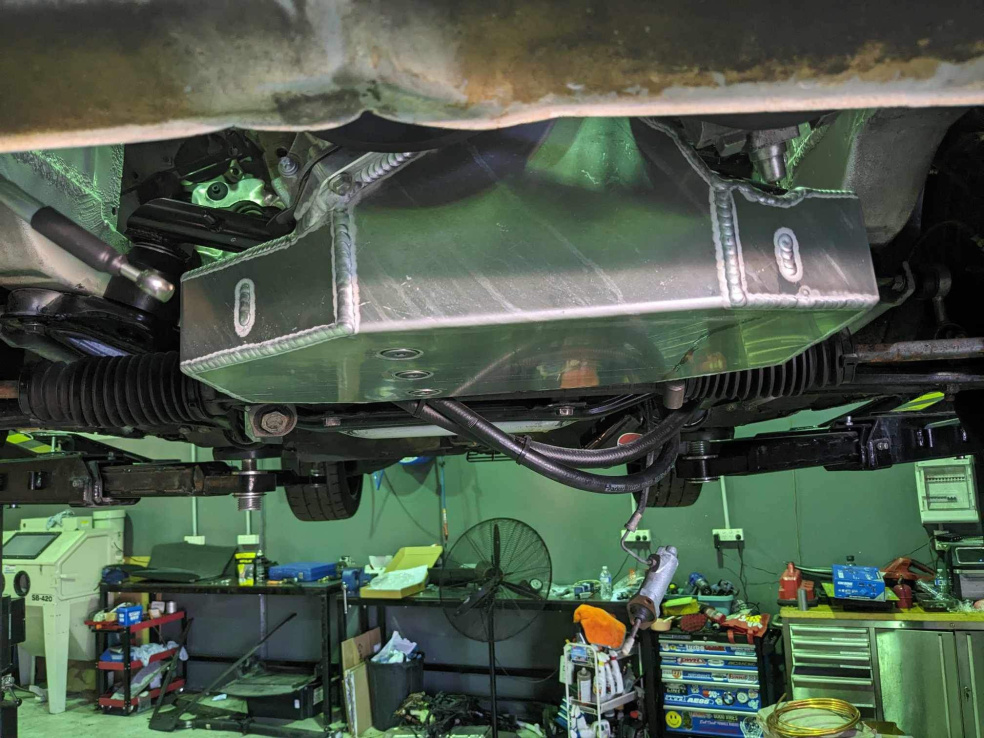

          Some good progress over at GreshM performance:
          - Harper Fab sump was fitted to the S54 (photo below showing it sits higher than the steering rack bolts)
          - RHD lightweight flywheel fitted to an OEM style 550i clutch for good street behaviour with the GS6-37BZ 6 speed gearbox
          - Motor fitted to the E30 using Revshift black (street grade) poly mounts
          - Karbonius airbox fitted to the motor
          - PWR radiator was also put in place​
          - New OEM washer bottle put in place - going for an OEM+ look

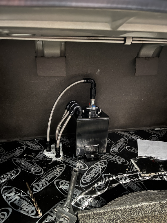

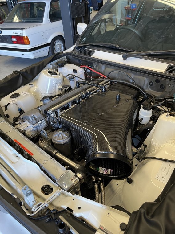

            Bit more progress on the swap.
            • Radiator plumbed to motor
            • Oil cooler plumbed to motor
            • Fuel surge tank mounted in boot
            • Brake booster moved over 25mm on firewall to clear the intake
            • Brake lines matched to Bosch iBooster
            Next steps:
            • Finish plumbing coolant res to rad
            • ⁠Wire in S54 ecu to e30 body loom
            • ⁠Build exhaust
            • ⁠Fit shifter and driveshaft
            • ⁠Tidy up boot carpet, engine bay plastics, etc.​

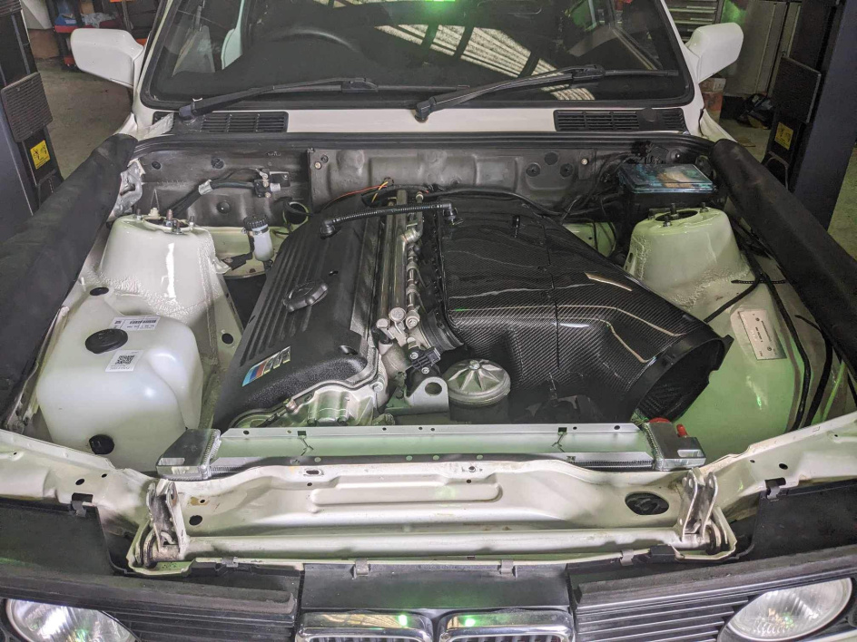

              #126

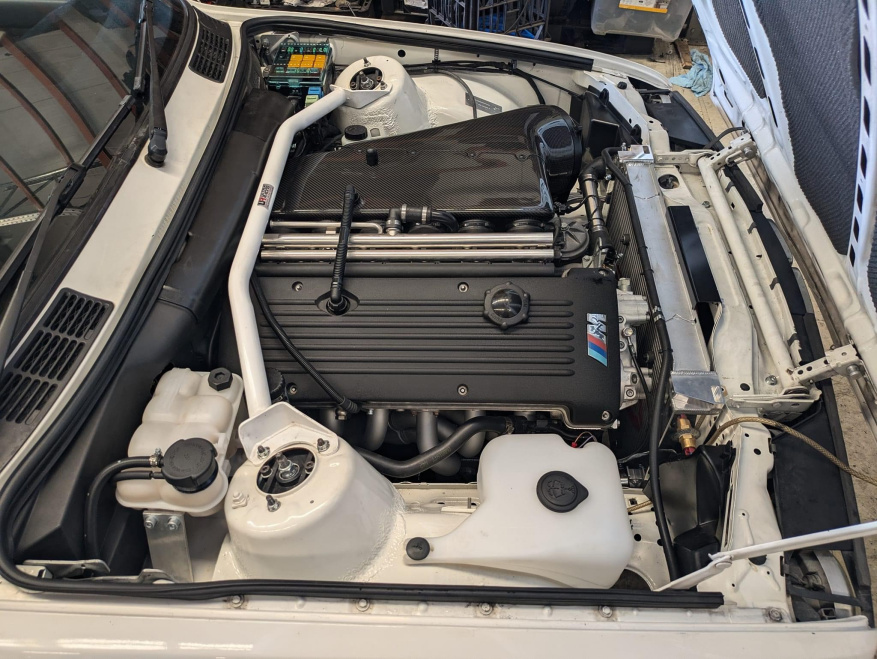

              The swap is done and the car is home!
              Everything was completed in terms of:
              • Plumbing coolant lines
              • Replacing fuel hoses, finishing surge tank, cutting carpet to suit, low pressure pump in-tank
              • Custom power steering hoses
              • Exhaust is a 3" mild steel single, 100 cell cat, resonator, tri-flow muffler - sounds great and no rasp that I can tell yet
              • Clutch is a GreshM kit using RHD flywheel - revs are very snappy but the clutch is light enough that I haven't come close to stalling yet
              • Motor mounts are 80A Revshift M5x swap mounts
              • Condor LCA lollipops to allow room for exhaust
              • CSL tune modified to suit
              The engine bay looks great, exactly what I wanted with an OEM+ feel.
              First drive was in less than ideal conditions: peak hour traffic and it had just rained so the roads were greasy, but it was pretty mental none the less. The car is a real animal, sounds incredible and feels great. I was only able to give it a short hit of WOT on the highway, but plenty of smiles were had.
              Looking forward to putting some K's on it over the next few weeks, then will take it back to GreshM Performance to have any teething issues sorted.
