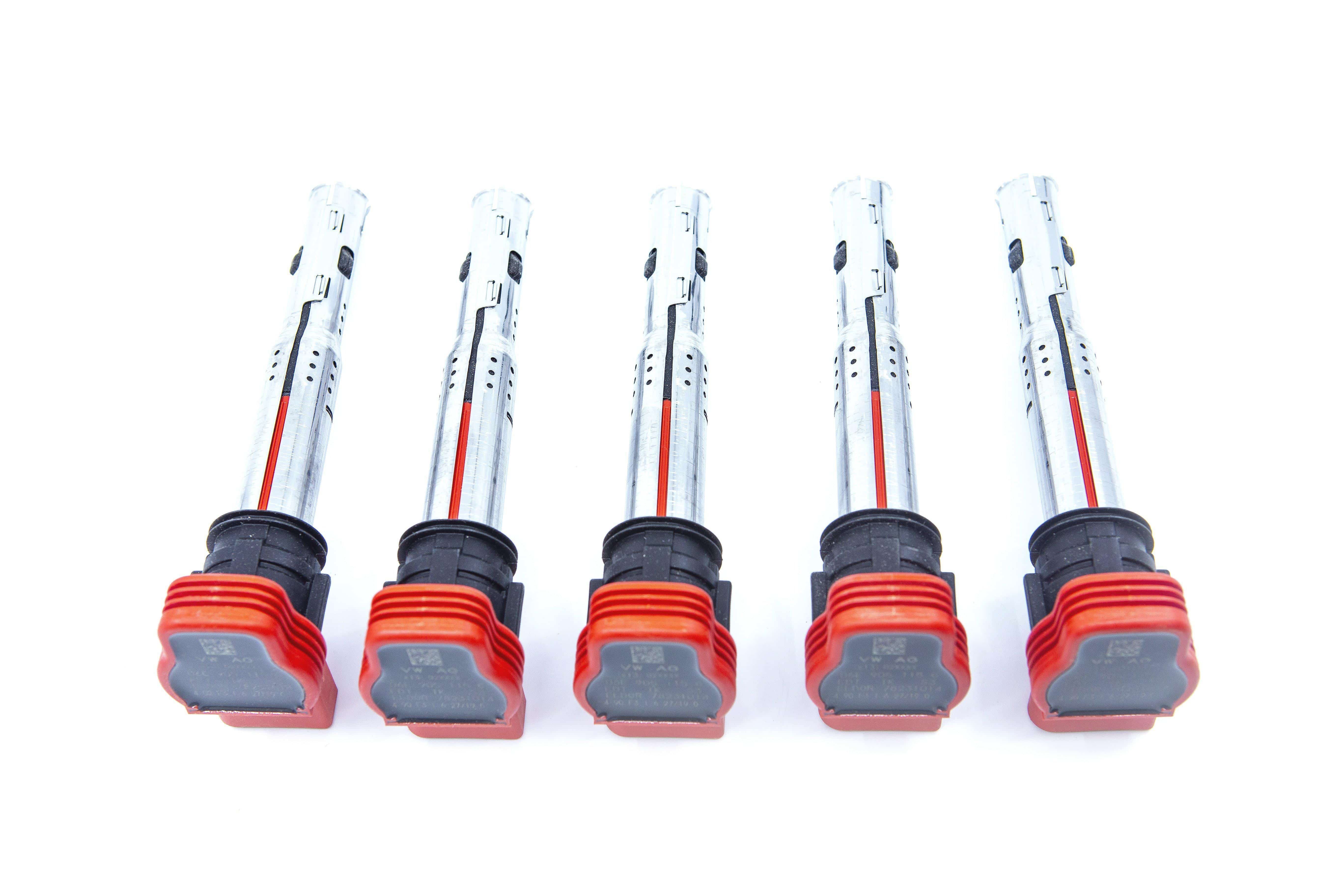

              Also for those wanting to do an SR20 conversion, Audi R8 coil packs are a nice option, and much cheaper than other aftermarket coil packs.

                  Those Audi R8 coilpacks from a few weeks back:

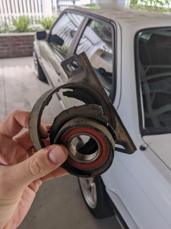

                            Replaced the tail shaft centre bearing, because it was wasted:

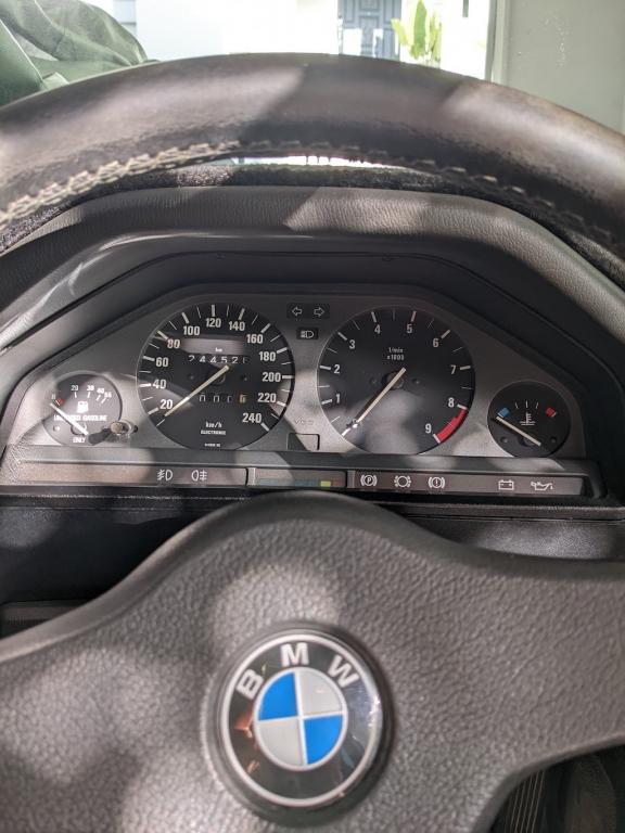

                            Had the tacho upgraded to reach 9000rpm in preparation for the 8400 rpm redline of the new motor:

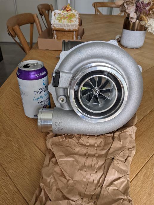

                            Bought a new turbo, Pulsar turbo, a knockoff of a G30-770. A friend runs these on his 800hp twin turbo LS1 with success:

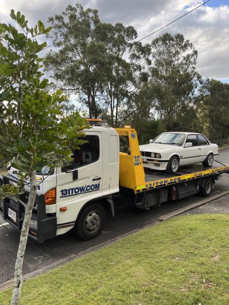

                              Anyway, off to GreshM Performance today to fix a major coolant leak from the water pump and a few upgrades..
                              - New clutch, tailshaft rubber coupling, water pump, 80'c thermostat, power steering reservoir and low pressure line, misc engine lines that have degraded
                              - Hillside Motorsport reinforced front & rear subframes, reinforced rear trailing arms
                              - Racing Diffs (Serbian company) billet dual mount, finned, diff cover for my 4.1 ratio medium case lsd
                              This will get the car reliable again engine wise, while I wait for my sr20 to be built, so that I can keep driving it around. The diff/subframe upgrades will be useful when the car makes more power. The original front subframe is currently cracking around the engine mounts anyway.

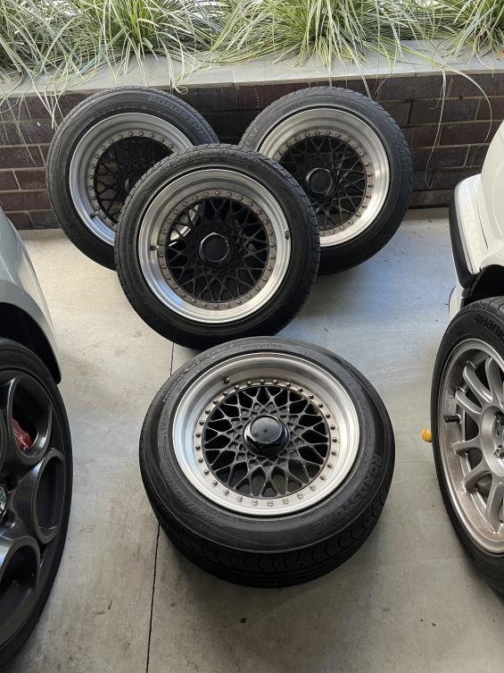

                              I also picked up a set of BBS RS 071 wheels in 15x8 +18 (front) and 15x8.5 +12 (rear) off FB marketplace. I had alerts running for 2 years before these turned up. These BBS wheels are built in the 80s for e30 race cars, so are the perfect spec.
                              I dropped these off last week at Dr Wheels in Yatala (Brisbane, Australia) to be rebuilt:
                              - Barrels painted black
                              - Centres & waffle plate painted nogaro silver
                              - Polish hex caps & lips
                              - Supply new valve stems and bolts
                              - Reassemble
