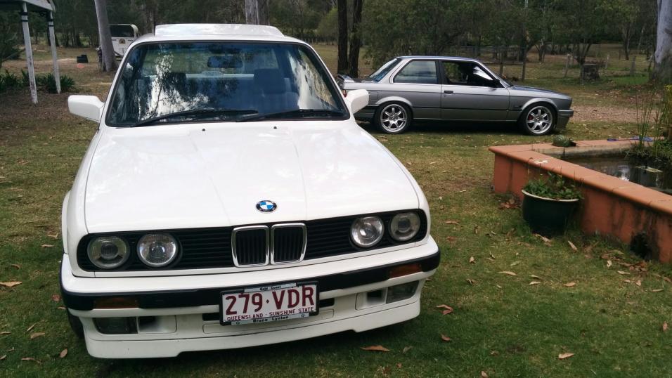

    Hi all, I've spent the last few months trawling through forums and car selling sites looking for an e30 in my area that was in reasonable condition, at a reasonable price.
    Today I brought home this 1990 318is, in white, coupe, with a sunroof and power steering. The paint is in great condition, there is almost no rust (tiny bit under battery and around sunroof joints), new brakes, bilstein shocks, h&r springs, 15x7 wheels I think, as well as a Turner Motorsport coilpack conversion and tune of some sort (not sure on details of that).
    Just the one pic from today:

    Immediate plans:
    • Fix anything obvious that needs fixing, eg not all dash lights work, aircon
    • Make sure the trim is up to standard - so new steering wheel is in order
    • Buy remaining parts for the sr20
    • Insert sr20
    • Profit
    Thanks for reading, please feel free to jump in with anything along the way, all opinions welcome.
    Cheers,
    Tim

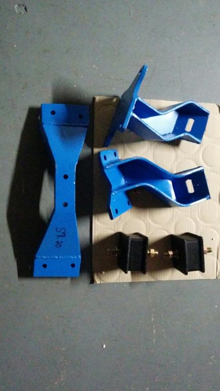

        eBay e30 to sr20 conversion mounts arrived today! Hopefully they fit ok.

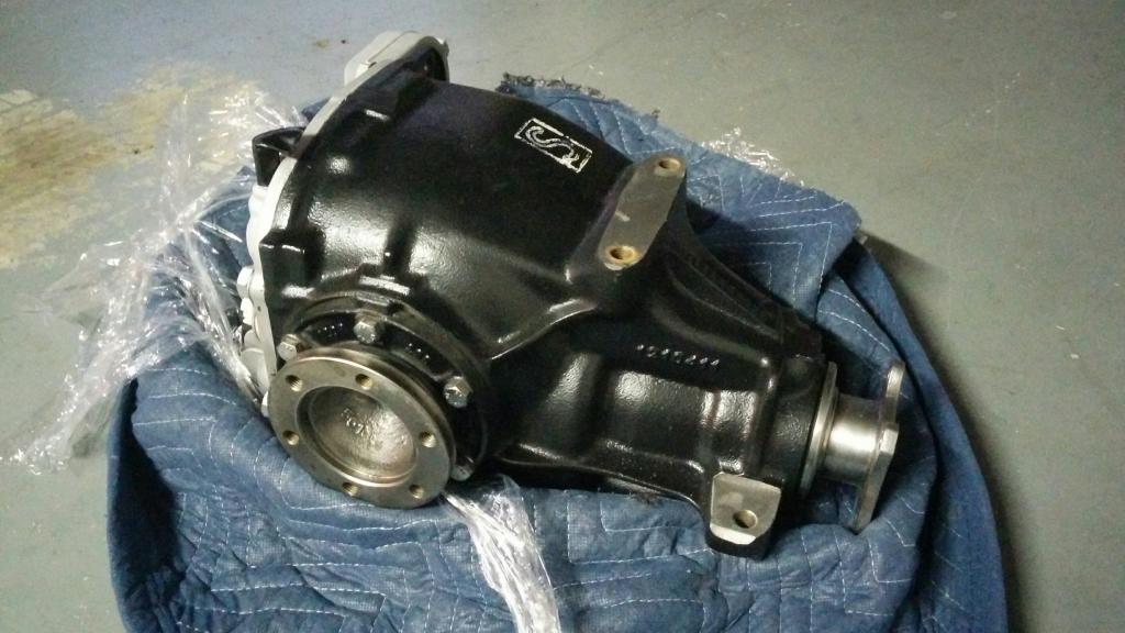

                          So I bought the e30 with a leaking 168mm 4.1 small case open diff.
                          Had a bit of a read and decided the 4.1 ratio was good to stick to - meant not having to mess with the speedo, and it would suit the sr swap.
                          Bought a 188mm 4.1 medium case LSD today from the wreckers, was delivered to my house by the time I got home from work.
                          Should be able to handle everything I throw at it:

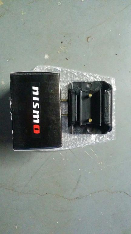

                              A few more bits and pieces came in the mail. First is a Nismo trans mount for the sr gearbox.

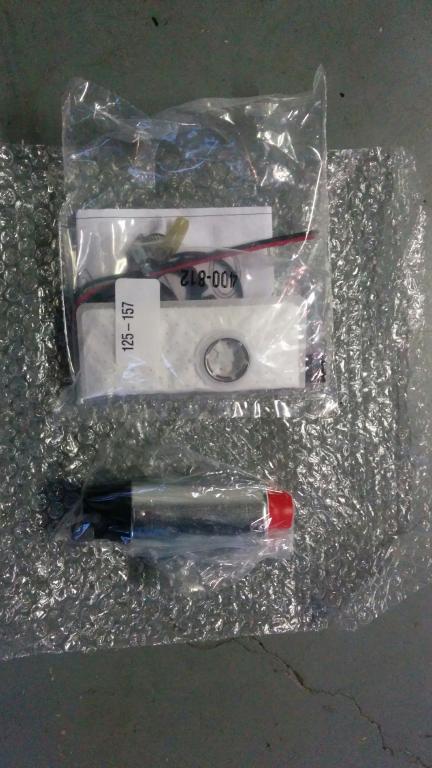

                              Also a Walbro in-tank GSS340 fuel pump and fitting kit for a '97 Mustang (found a how-to using this kit - almost direct swap just with a bit of soldering). This pump is rated at 500hp - hoping it works ok!
                              The new diff is going in Wednesday, then I'll have a go at the fuel pump when the fuel level is low. Pretty keen to get as much done and still drive the car before I pull it off the road and take it apart!
                              Nismo trans mount:
                              Walbro fuel pump:
