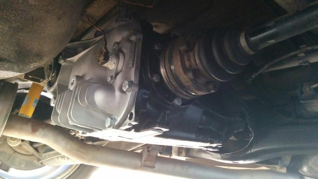

    Today the old diff was pulled out and wrapped up. I'll spend some time cleaning it before selling it. The new diff went in, minor issue with the speed sensor plugs not matching, but ended up using the old sensor, which is working great.

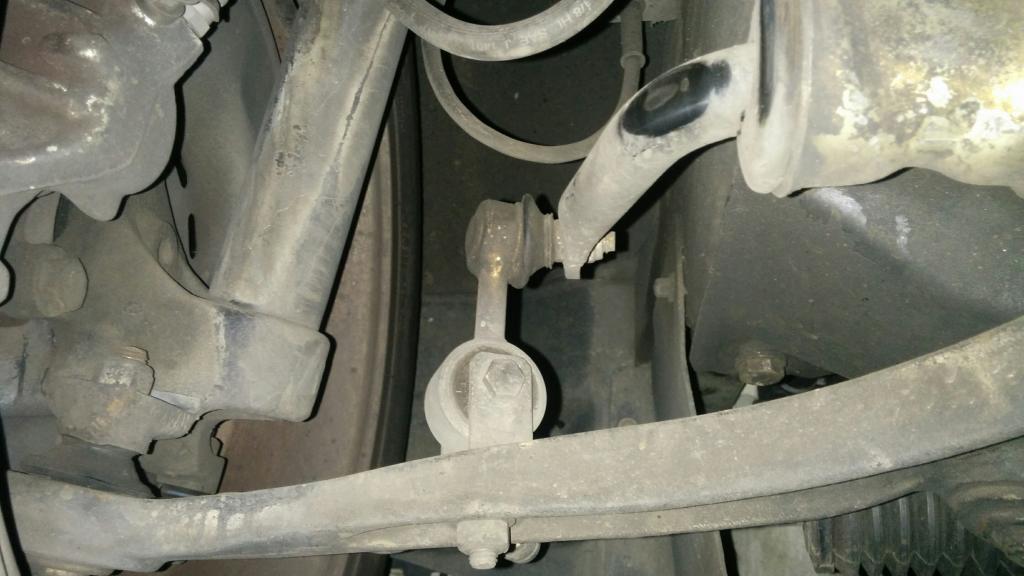

      While I was messing with the car I thought I would take a look underneath and see if anything looked dodgy. On the passenger side sway bar I noticed some fresh rubbing marks, and the drop link bushing looked to be on a wack angle - thinking it might need an alignment of sorts? Hopefully that will sort the rubbing (on full look I can hear it when parking at home):

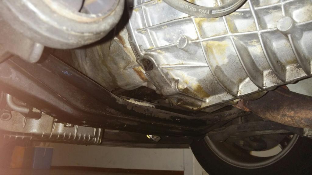

      And now I can see why the PO had cleaned the gearbox before I inspected it, looks to be leaking slightly, but not enough to drip onto the ground where I park the car. Good thing I won't be using the gearbox anyway after swapping motors:

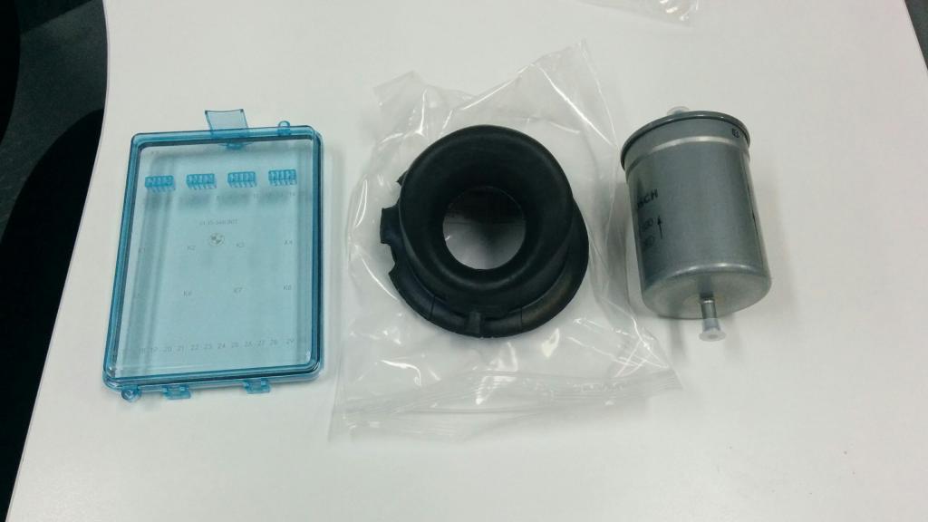

                              Met up with some friends to work on the cars, plan was to change the fuel filter and some other bits, turns out my fuel filter isn't the stubby one under the left rear side, it's actually in the engine bay, so I'll be ordering a different filter now.
                              I had cracked the battery cover when the new diff went flying around in the boot, so attempted a quick fix. Bit of plastic glue to piece it back together:
