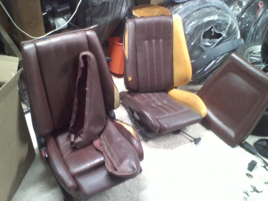

                      Thanks to Zach I was alerted of a set of taurus sport seats at the upull on the single e30 in denver.
                      Ironically I was already in denver and din't have much going on. I jumped over and grabbed the pair as one would be a great donor for my split driver side.

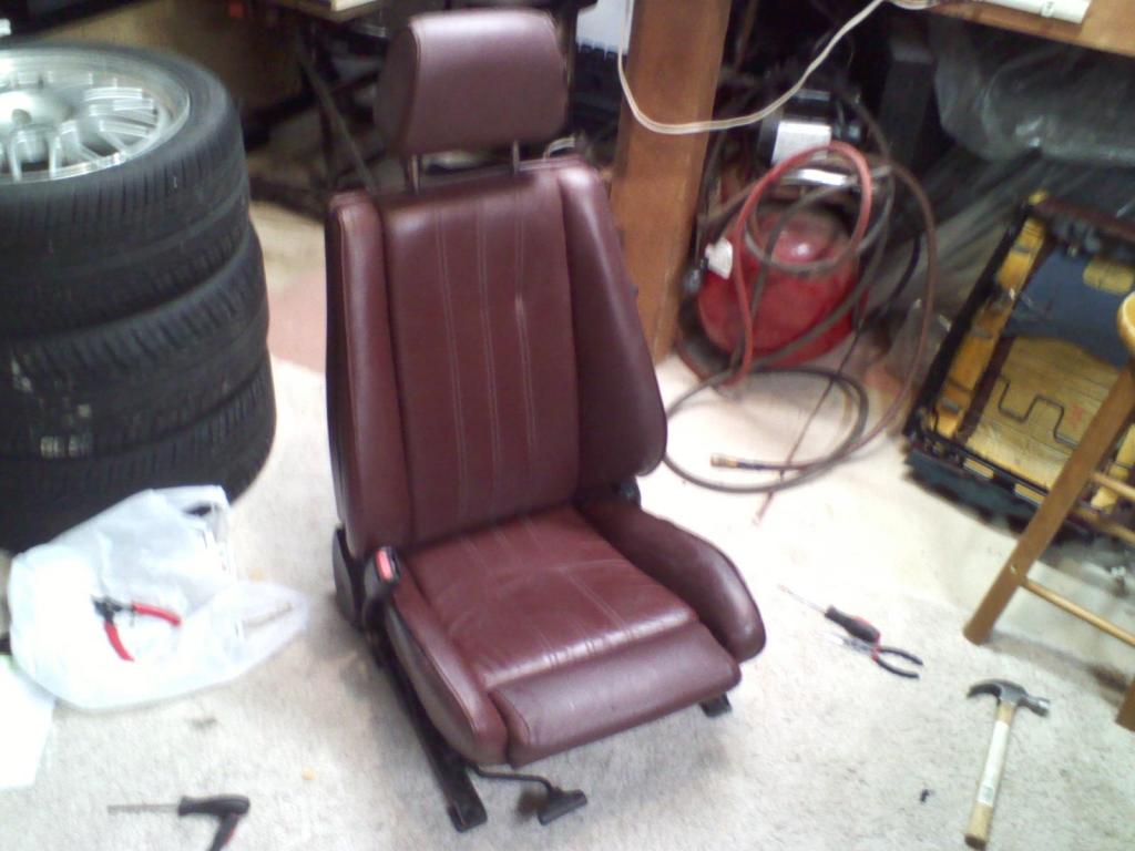

                        And good as new drivers seat

                          Ill just leave this here. Just for mock up at the moment.
