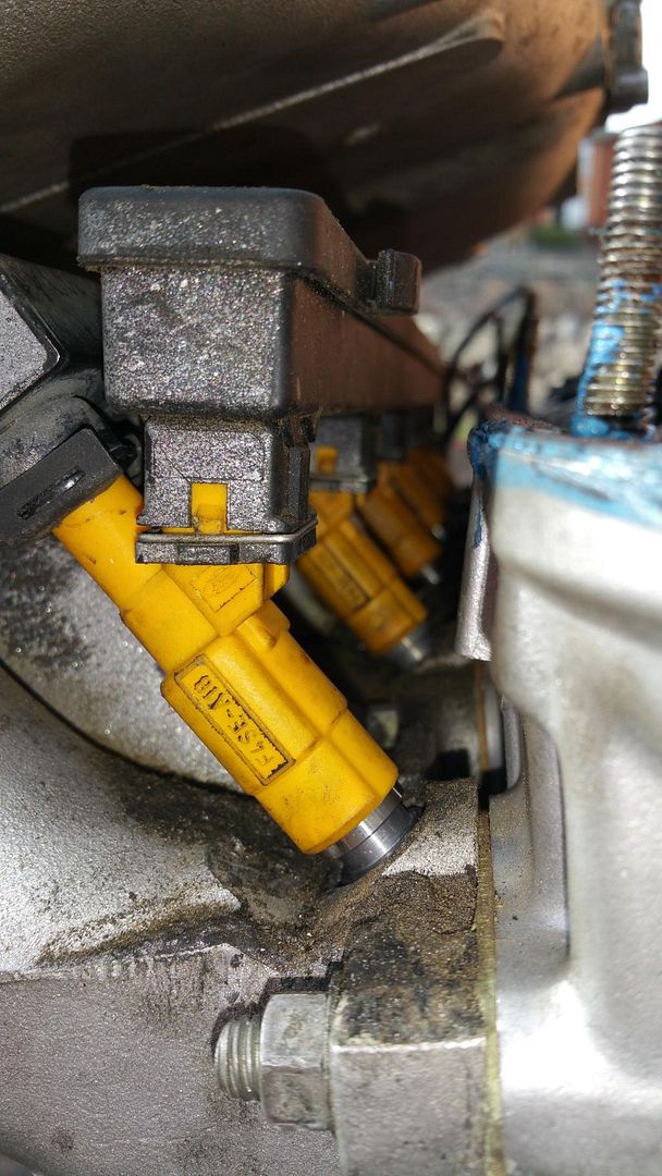

              I installed a new fuel filter the one I pulled off looked like it came from 1989. I also finished installing the stainless steel brake lines. I didn't finish them because the soft lines going from the body to the trailing arm was too short so I was mad about it.
              Installed my 19lb injectors as well

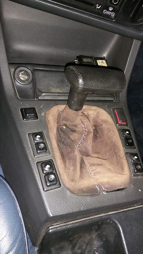

              I also thought it would be cool to put a shifter boot on my auto Haha looks cool. The boot is old and sun bleached.

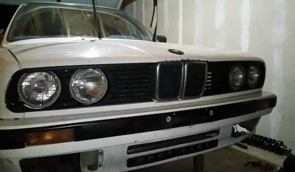

                          So I got a few updates.

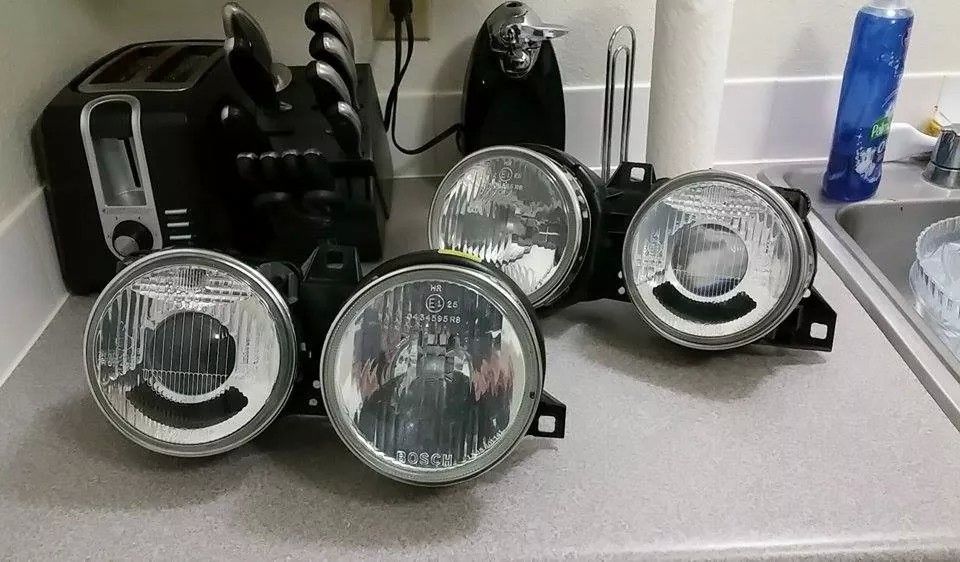

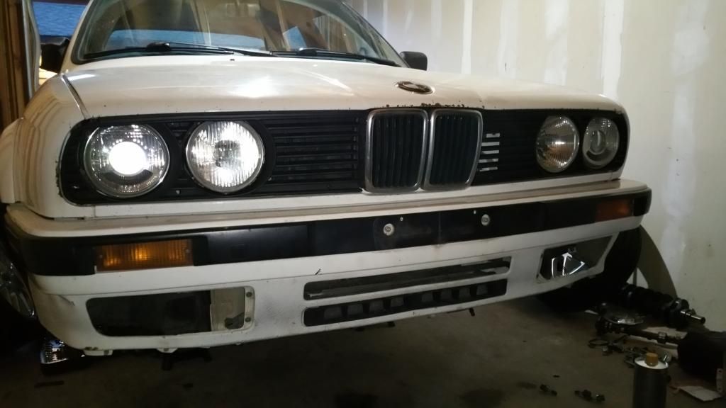

                          First is the one that I am excited about most. Bosch smile headlights.
                          Installed

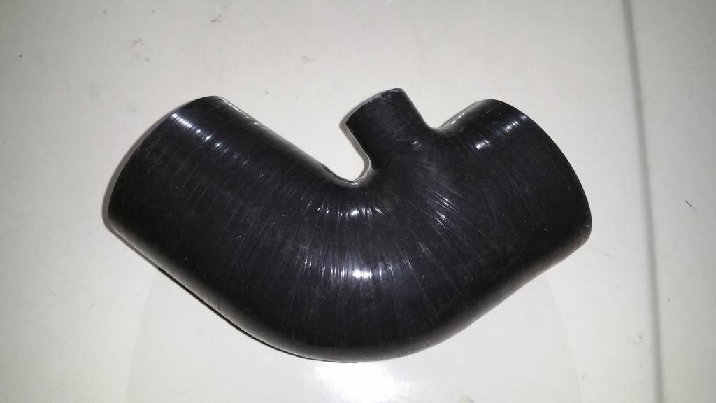

                          German engineering silicone intake boot

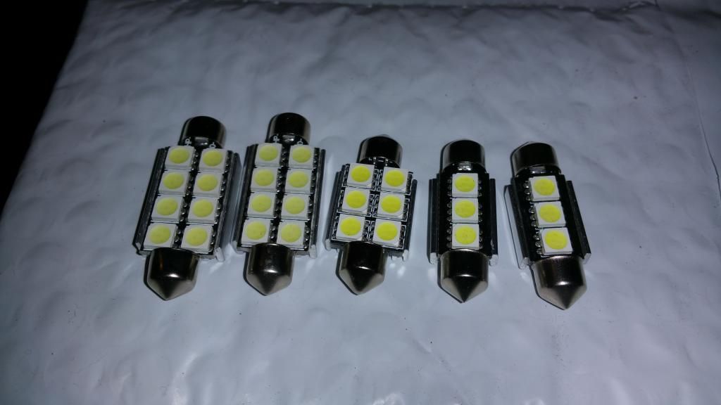

                          And my new trunk, dome and, license plate led lights.
