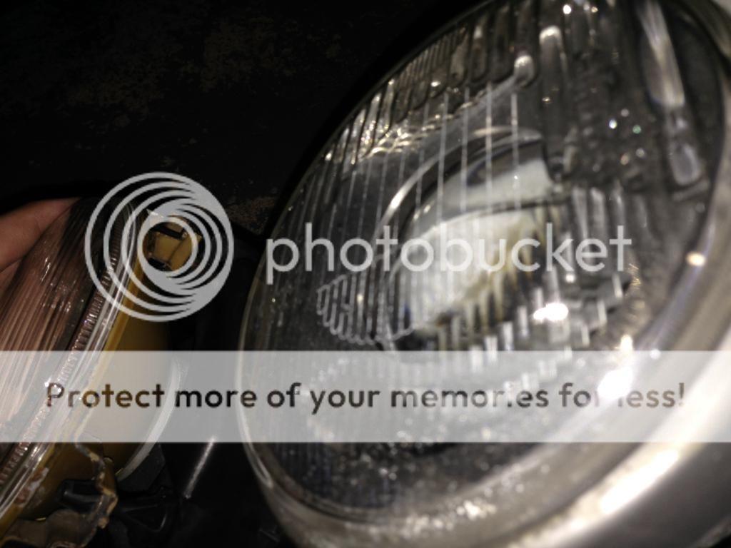

    Headlights:
    The factory sealed beams may as well be fireflies caught in a jar. They're terrible. So I bought some Euro ellipsoids with the intention of converting them to D2S bi-xenons, something I did to my E36 using E70 X5 projectors and custom brackets. Being that I had some spare headlights lying around, I figured I'd see what fit the best on the Euro headlights:
    Euro headlight:
    BMW donors:
    The projectors were cut out of these headlights (from various newer BMWs) and compared against each other:
    Oddly enough, the best fitment came from the E70 projector that I salved from my one surveying headlight out of the E36, which I went and found a mate for:
    Euro projector vs. E70 projector:
    Rough mockup:
    As you may be able to tell, lots of cutting will be involved to get the lens to sit flush like the OEM projector does:
    OEM projector's fitment for comparison:
