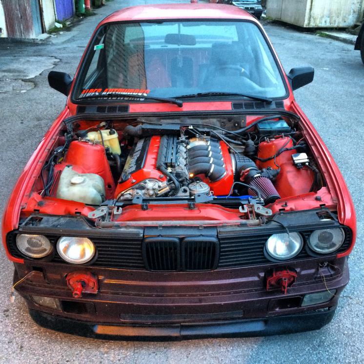

This was less painful than I'd thought, but then again, no exhaust and no transmission were attached tot he block at this point:
Clearance between the new E36 rack and the oil pan was... tight:
Same with the plenum, which most certainly has to be modified:
... And the headers:
The headers foul both the subframe and sway bars, and with me being lazy, I figured I could simply bang in the headers to get them to fit. The problem spots marked in black:
Still no good:
I've since dented them a little more, and will likely notch the subframe as well. If they still don't fit, I will cut and reweld the one header that's causing the headaches.
Next - and prematurely, I fear - we fitted the transmission to the engine and began the ball-aching task of shoehorning it in to the bay. It was a disaster. Suddenly, the engine that had been so accommodatingly easy to place when we were test fitting the exhaust became an uncooperative bitch. We pushed, pulled, jiggled, and jived the damn thing but couldn't get it to sit on both engine mounts. Only the header that didn't collide with the chassis was fitted, so that couldn't be the issue. At this point, we were beginning to lose our momentum and daylight, so left the engine resting on the mounts as opposed to being bolted to them.
Some pictures to illustrate the butt-clenching ordeal:
