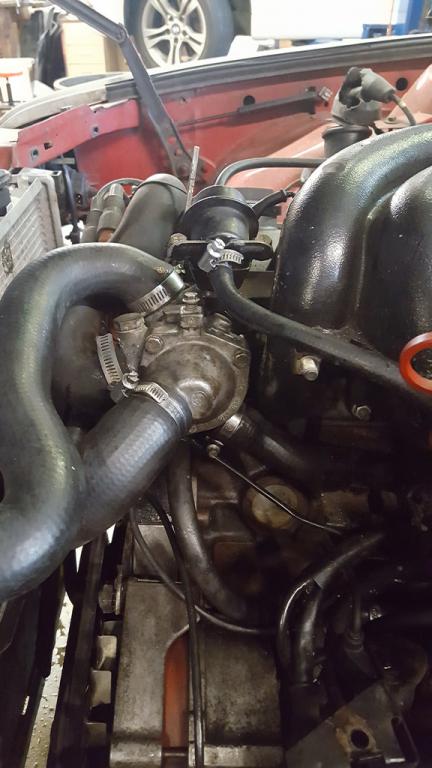

                    I'm enjoying the e30 and having 3 pedals again. She's holding up pretty well, and put a bracket on the exhaust so it won't fall off again. I have a few things to tackle, but the main issue is no heat. I've replaced the Thermostatic Bypass valve, and made sure the hoses to the heater valve were correct. I've bled the cooling system twice. I've unplugged the heater valve plug to supposely leave the valve open. If it comes down to it, I will drill out the valve if it's stuck.

                      Might be your heater core's gunked up too...

                        Fellas, we have heat!
                        I went sliding earlier tonight,and headed off to dinner. The windshield was starting to get foggy,so I turned on the air, and heat came on. This is gonna make the next few weeks easier on me. Cars and Coffee in the morning.

                          I thought so too after I used compressed air in the heater valve and it pushed out a bunch of gunk. I then proceeded to filter water through the system, and it came back clean. I repeated the same for the heater core.

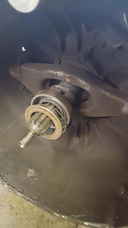

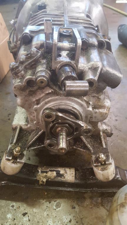

                            Welp, after 8k miles (in my possession) on the original clutch,it finally gave out. Since I have no knowledge of the motor's history, who knows how many miles are on it. It was given to me with the shell, and apparently raced. I took time after work during the week, and got the job done. I found out my throwout bearing exploded, and my old clutch had some uneven wear. Also, I ordered the wrong clutch kit since I discovered a eta single mass flywheel instead of a dual mass. Twas a fun week. I did the selector shaft seal along with the output shaft seal. I fixed my coolant leak at the thermostat housing after I drilled a broken bolt out followed by retapping. Click image for larger version
