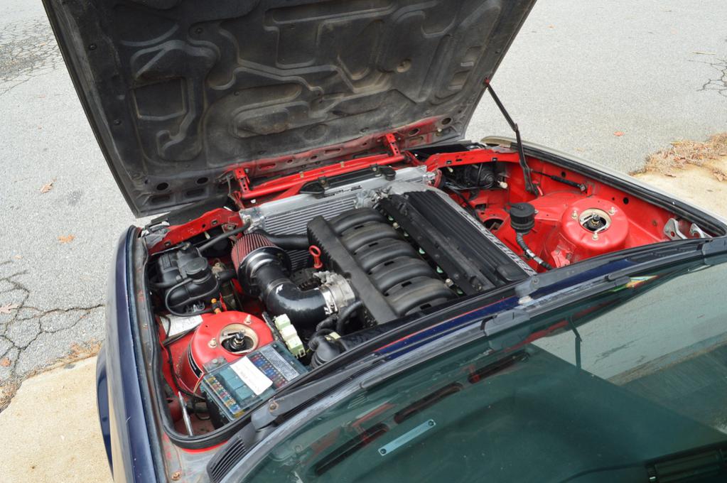

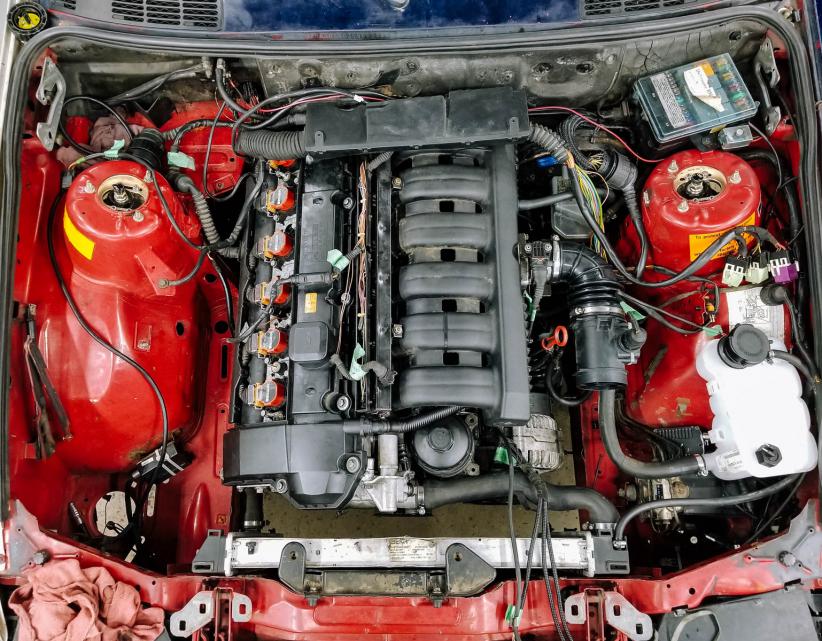

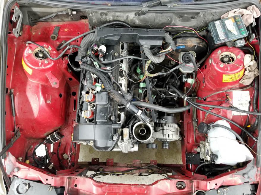

    I've been working on the e30 till dawn the past 2 days sorting out various things. I'm glad I went the obd 2 route since it made diagnosing my cps fault code 83 easy. I made a dumb mistake and forgot to hook up a plug on the accessory harness to the main engine harness. Finally got that sorted out and the e30 turns on with no issues. I had to find a maf since that code popped up too. I found the correct driveshaft from the bone yard for 17$. U-joints felt great. I sorted out my wiring to the e30 body side and only ran the necessities for the swap. This took some time for me to sort out since I have a 1986 325e and cross referenced multiple places to ensure I wired everything correctly. I'll admit, I probably went overboard for 11 wires, but I'd rather be safe than sorry. Also, I sorted out the m20 coolant temp sensor. I don't have much to do except finish building the exhaust, rebleed the clutch and brakes, tidy up the engine bay some more, and install my spal fan. Hopefully, I can drive it tomorrow.

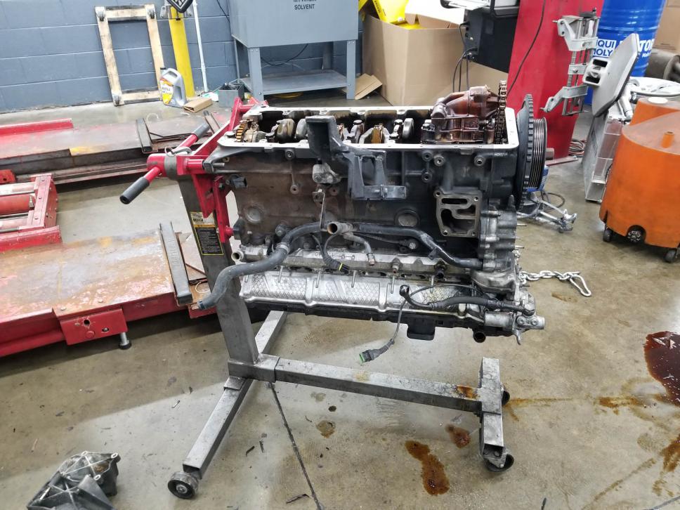

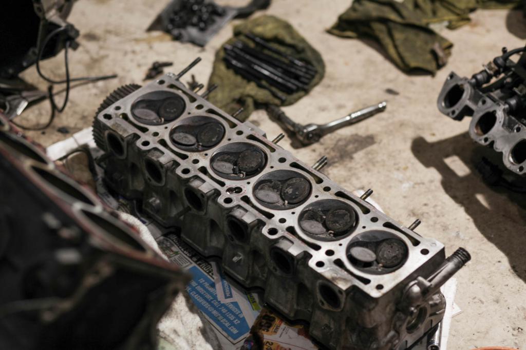

    Also, on a side note, I tore my m20 2.7i stroker apart and found the top end had no visual damage. I think my metal on metal clacking noise issue resides in the bottom end.

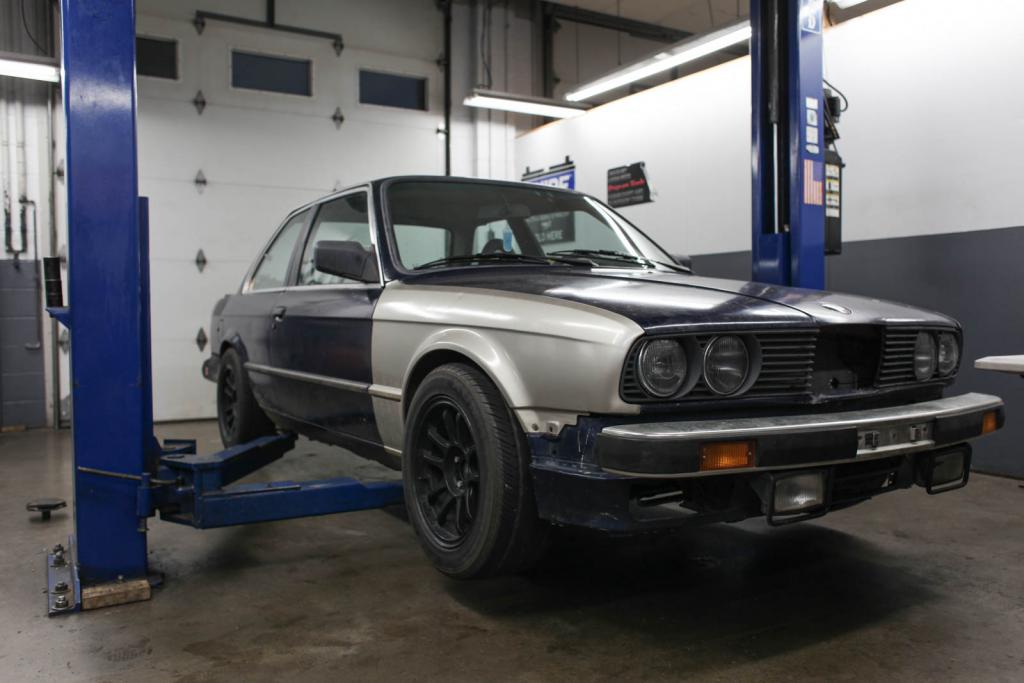

          I think we've reached the end of the obd 2 m52 swap. I solved my rear main seal leak,power steering issue, and slave cylinder issue a few hours ago. We're gonna put some miles on it tomorrow. I plan on scheduling a dyno session to see where I'm at. Time t o get some more seat time in the e30 this year, so I can actually learn how to drive the car at it's full potential. I have a few things left on my mod list. Also, enjoy a shot I took of a friend's newly acquired e46 m3!

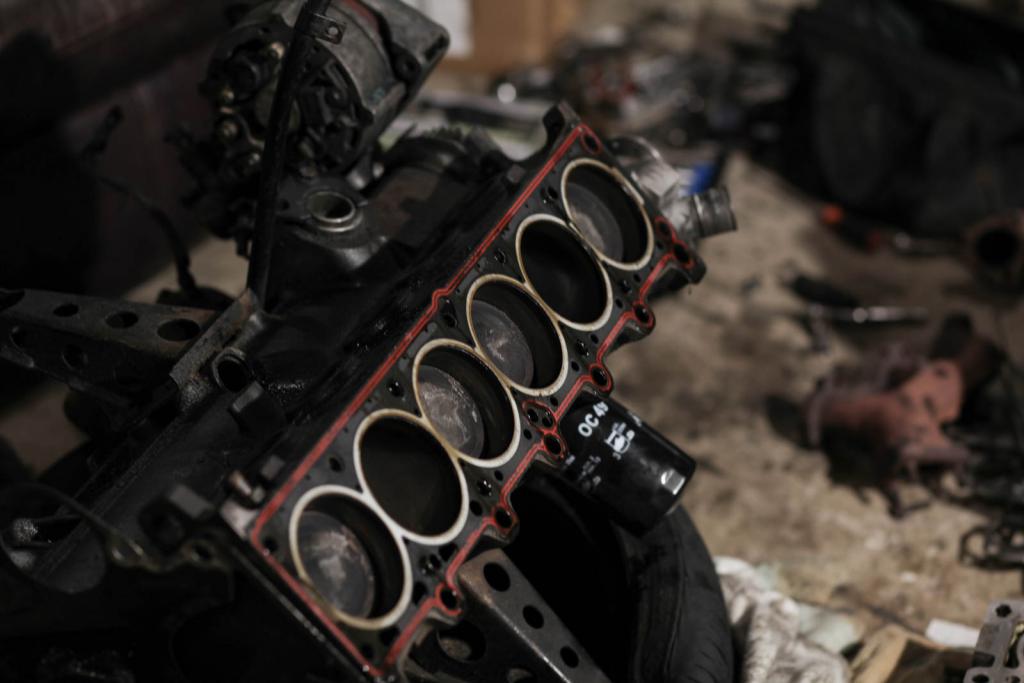

                    Tore down the m20 and definitely drove her into the ground. Rod bearings took quite a beating.

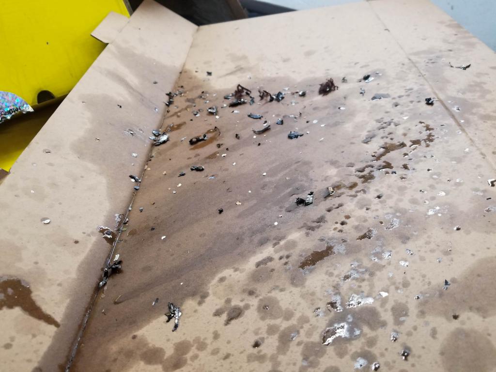

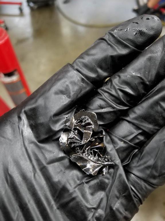

                        Sad news then good news

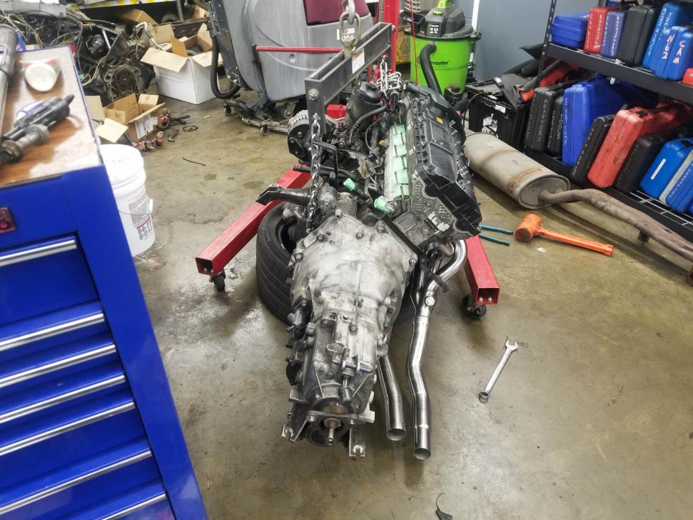

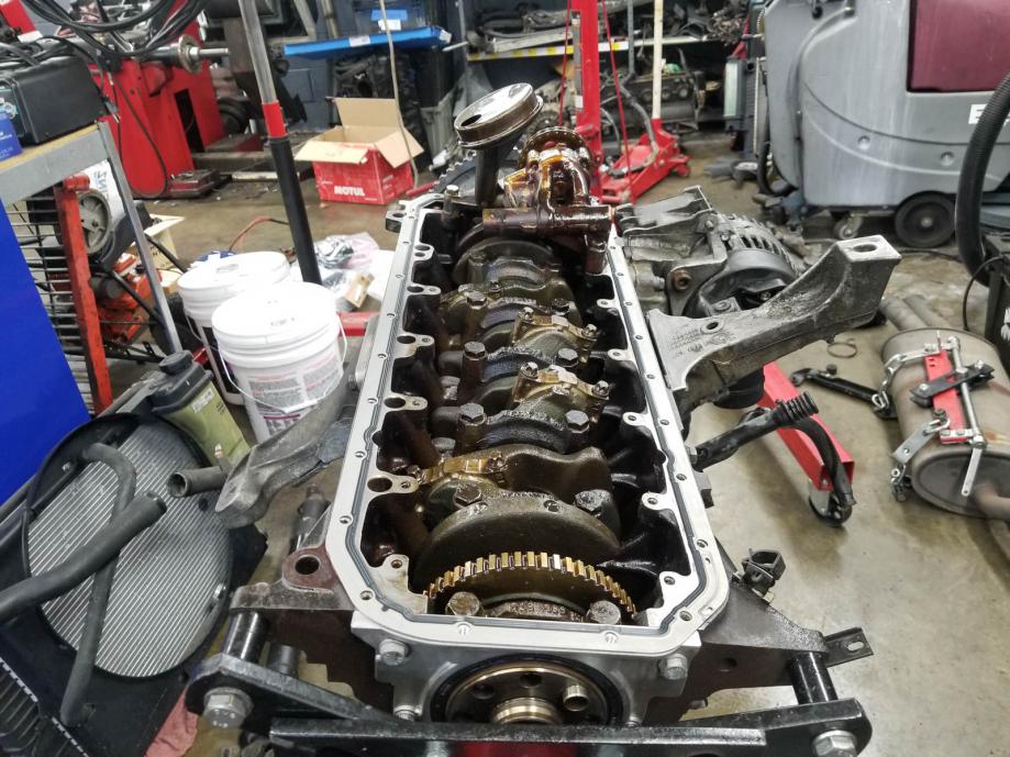

                        Unfortunately, the m52 made it 2k miles. I started hearing a knock noise the other week and my oil was a glitter party. I found huge chunks of bearing material in my oil pick up tube which is probably attributed to my low oil pressure at idle. The good news is, I had a spare m52 and it's in the car. Buttoning it up today and hopefully hear her come back to life. Engine is fully resealed and oil pump nut welded. Definitely thankful for everyone who helped me these past few days.

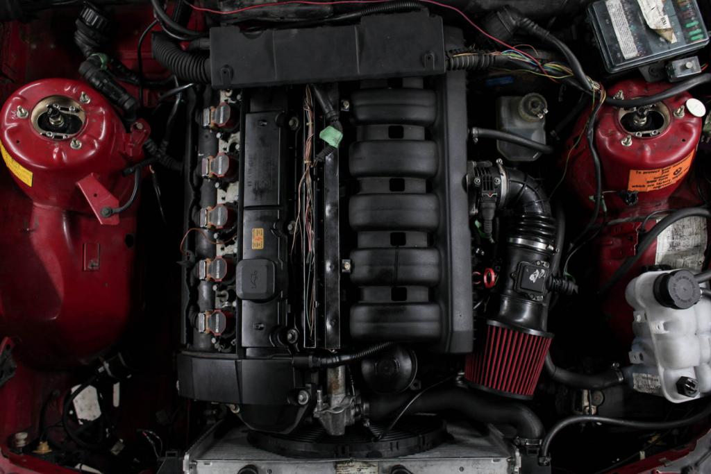

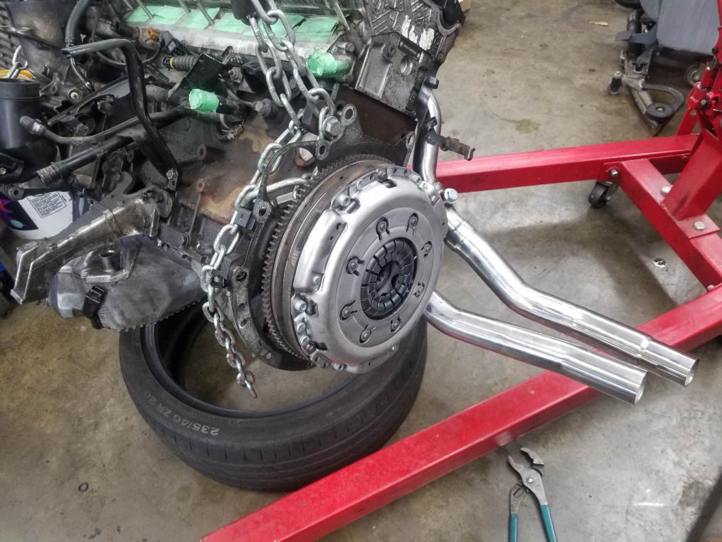

                              The s52 cams did not survive unfortunately. I pulled the caps for cylinder 3 and 6 only to find scoring. I spoke with Kassel Performance who were kind enough to reflash my ecu so I can properly hoon the e30. I'm gonna finish building the exhaust today for dd duties. I may upgrade the ansa catback at some point. I have some finishing touches to do and the e30 should be street worthy and ready to head back to the dyno at flim flam speed.
