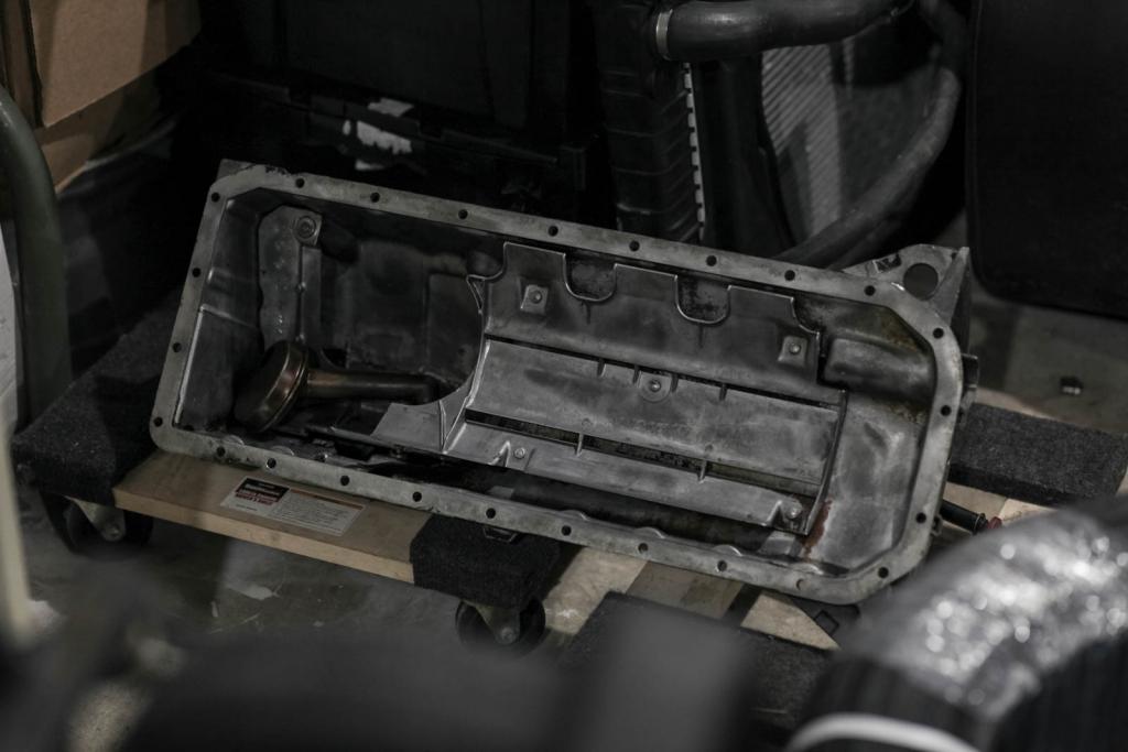

            Round 3
            Alright guys, I think my m20 2.7i is on the way out. I started getting this clacking metal on metal noise a few weeks ago that got progressively louder. I tore down the front of the motor and found the tensioner failed. The timing belt walked off toward the cover leaving quite the groove (at least 25% of the belt lost), and found slack in the belt. I threw on another belt and tensioner as a bandaid. I got numerous opinions, and the major rules that I may have had piston/valve contact unfortunately. The e30 is still running for the time being, but now I'm kicking the m52 swap into high gear. I picked up s52 cams, an e34 oil pan, pick up, dipstick tube, m50 intake manifold, and fuel rail for roughly 430$. Tomorrow, I'm pulling the m52 oil pan off to see why the motor lost oil pressure. Hopefully the oil pump nut backed off otherwise a new oil pump will go on.

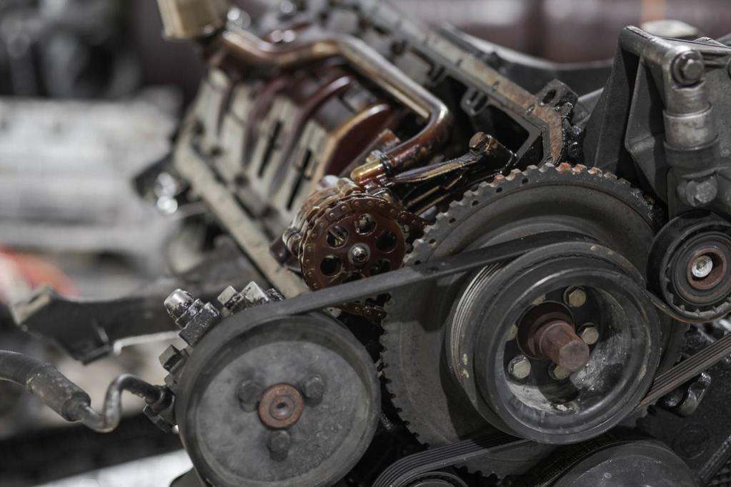

              Oil pressure loss problem found
              After taking apart the m52, this is what I found. Oil pump nut backed off. I'm gonna check the bearing and throw it back together.Click image for larger version

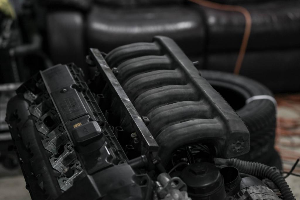

                  #83
                  Parts, Parts, Parts
                  Almost have everything for the swap! Click image for larger version

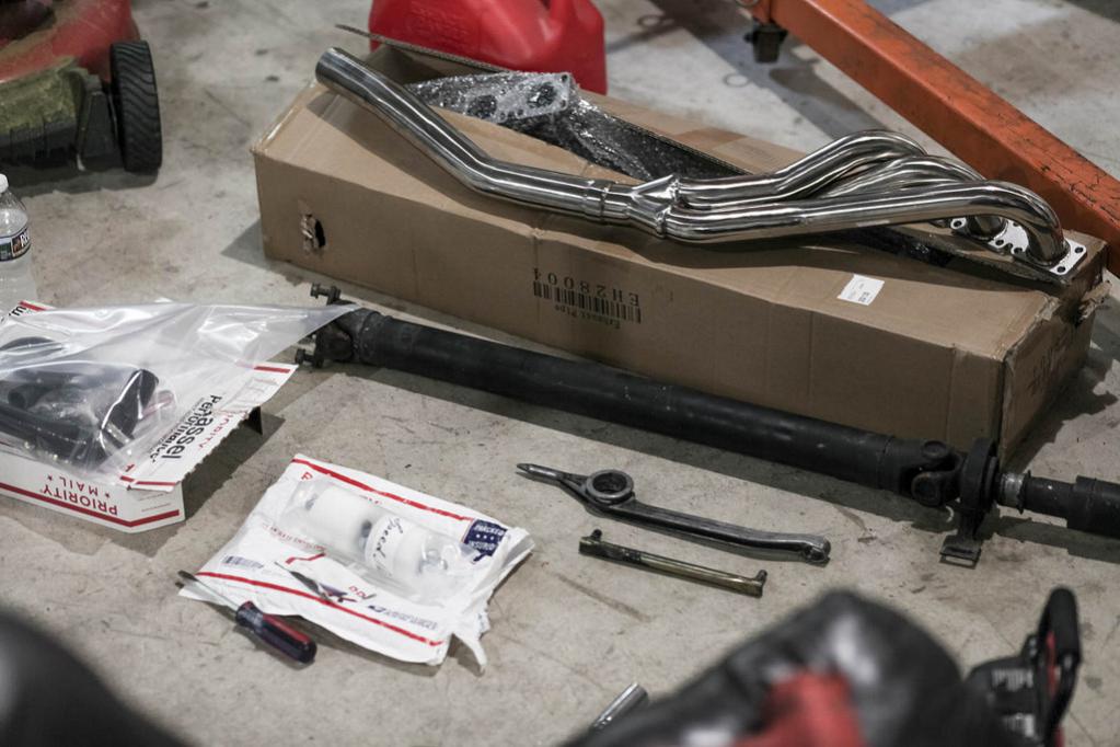

                    Prep work. Trying to get everything ready to drop in Sunday. Dyno day is 16 days away.

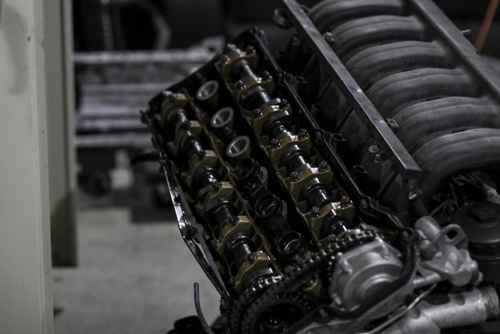

                      #85
                      3 days off work meant E30 24v fun continuing. Got the stock brake booster relocated. Resealed the m52 and cleaned my engine bay. I was getting ready to drop the motor in until I realized I was missing some pressure plate bolts. Hopefully Tuesday or Wednesday this E30 will move.

                        What exhaust headers are you using?
                        Hank Ahrens
                        1984 Alpine Coupe
                        1978 911sc
                        • Tougerunner01
                          • Apr 2014
                          • 237
                          #87
                          Some 61$ eBay specials.
                          Sent from my SM-G950U using Tapatalk
