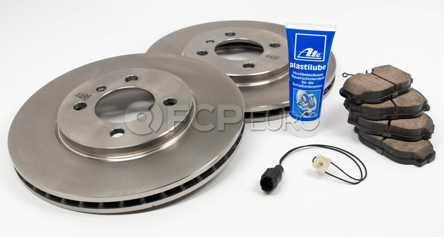

            Front brake kit:
            Front hubs were a bear to find!
            Reman brake calipers arrived:

                Akebono pad w/wear sensor:
                Front axle nut goes on at ~220ft-lb:
                Front brakes on:
