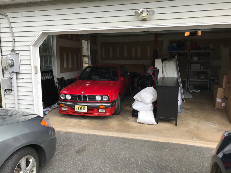

Took some time off for the holiday and did a few things, moved the e30 into the garage and immediately noticed a trail of fluid dripping.
At first I thought it was a leak from the gas tank but with a quick looking under the car, saw it was dripping from the back of the motor, then looked up on top to find the gas squirting out of the fuel supply line to the fuel rail.
This excessive heat wave possibly expanded the supply line. I tightened up the hose clamp to stop the leak. I’m glad it let loose in the driveway not while driving.
Will definitely be looking to replace that line and clamp, don’t want that to fail again and will be adding a fire extinguisher to keep with me at all times, just in case.
