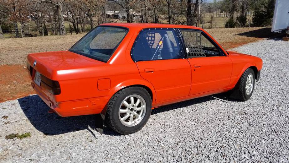

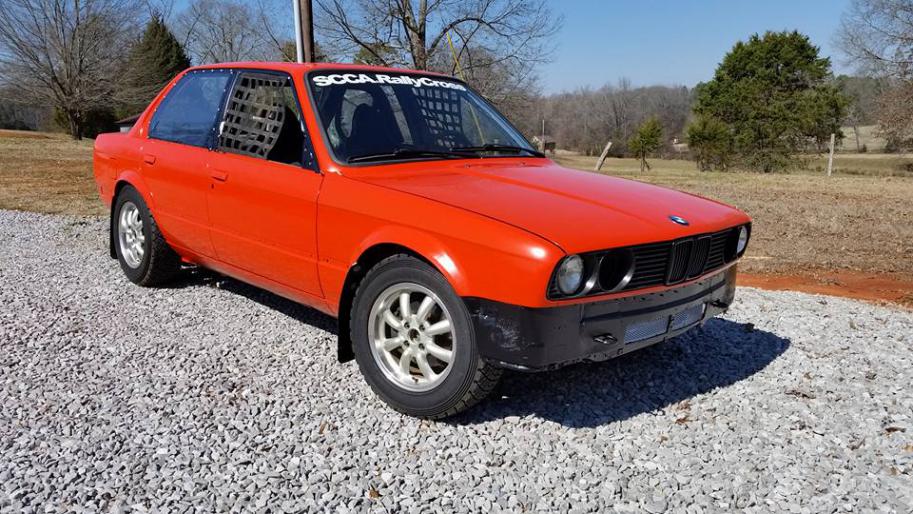

        I thought I'd update Scotty's thread.
        I bought it from Scott last year.
        Car runs and handles great - very light with plenty of power. This is a picture from the last SCCA TVR Region event at Hollytree.

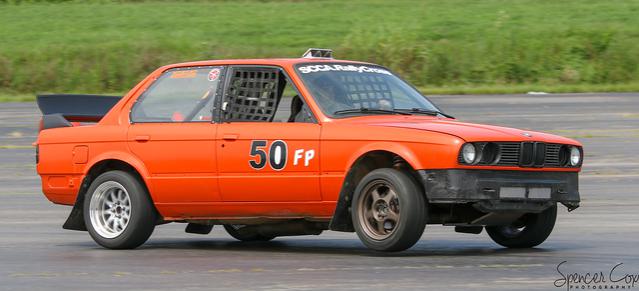

            Two from the day I bought it and an AutoX event - I was experimenting with tires and seeing how it would do on pavement. It handled very well and had plenty of torque. I did two AutoX events but no more...bought another E30 for that. No power brakes is okay in the dirt...no so much for quick AutoX stopping. Also, being gutted puts it in FP. I'll find an engine and interior pic so you can see how it turned out. Very minimalistic. Very light. Tidy and roomy engine bay. Now that I have a stock E30 325i I see how much crap was removed - amazing!
