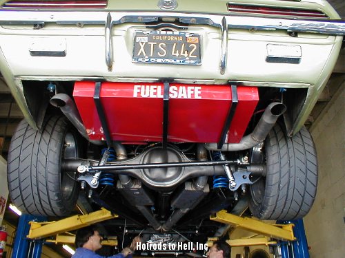

        Quick question for some of you racing guys, I have my fuel cell the frame is made for it, as you probably have seen in my last update...but what I am wondering is if simply straps is enough to hold to fuel cell in...
        Reason I ask is a see crazy contraptions like this posted on the interwebs
        As opposed to simply straps like these setups
        The first ones seem a tad overkill and truthfully probably weigh a lot. I was planning on doing two straps. But not sure what to think with some of the crazy mounting contraptions I see out there.

          Well, I might not be the person to ask, but IMO, your straps are probably fine. The stock fuel tank was held in with straps, wasn't it? The tank on my Datsun had two straps holding it in. Done right, I can't imagine why it wouldn't work. And yes, those cages are going to add weight. It's interesting that some people will remove the stock tank for an aluminum one for "weight reduction" and then mount it to a cage like that, which weighs a ton. Additionally, the straps you have there look like they're pretty thick. I'd say they're quite a bit thicker than the ones on my Datsun, as well as wider. Only thing is I'd put some rubber between the straps and the tank, and some straps to go over the top as well. As is, doesn't look like there's anything holding it down, just the two straps keeping it from falling out.

            Those cages around the fuel cells is to protect them in an incident, and a lot of times cells are added as per competition rules (and/or extra capacity) not necessarily to save weight.

              Yea I think straps are ok for me, since this isnt really going to be a racecar but rather a weekend at the track sometimes car mainly fun streetcar...but I may play around with a different design than the current straps...well see
