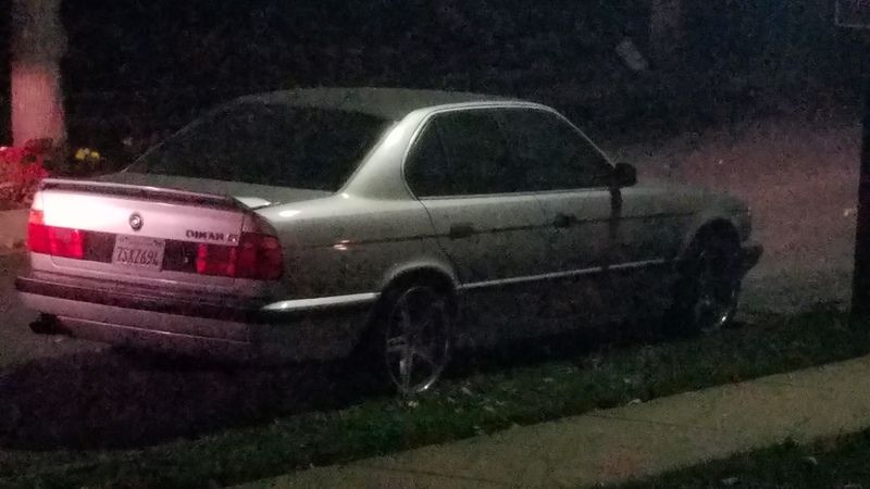

    Then this arrived:

      Hows the e34. Is it everything seller said it was or another Ebay horror story?

        You are fast! Will update other thread.
        Reworked the thread title after a comment it should be an S5. Well, it is not an S3 nor S5.
        Idiot lights come on, fuel gauge works, no tach or speed.....
