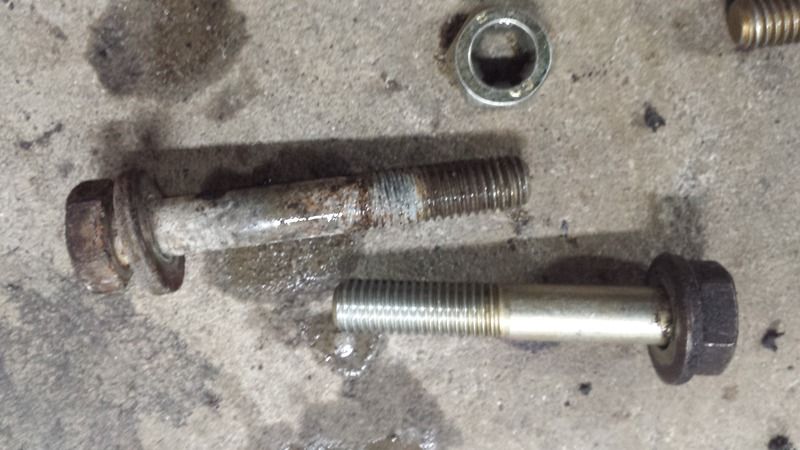

        Nice progress throughout today.
        With my prep work, Kershaw was able to drive out that LCA spindle with a whack of the sledge. We ended up taking the front strut assembly out to get a better whack at it. It worked! Thank you!!
        After seeing some dirty strut tubes... I figured take out the other one, too, for a good paint. Now, both are in the trunk where they will be chauffered to the local self serve car wash for a good scrub. Gives me time to get the LCABs pressed into the lollipops... thank you again to Kershaw.
        Now the steering rack is out.... I just may see if I can find that E46 steering rack. This project stuff is tricky. I don't know when to say no. Just get it while the getting is good! I need the motor in... I need to get this thing on the road... but I just want to do everything right along the way. From a simply strip and clean, or restore threads or totally replace or upgrade..

              Banging out the LCA meant removing the strut assembly. Once that was out, I figured clean it up and paint it. So I removed the other side, too. They were wore wheeled, pressure washed and scrubbed, taped off and wiped down for a good spray of rust preventative and a gloss black to match original sheen.
              Front end components are looking clean! Get the LCAs back and start putting things together.
              Soft brake lines are cracking. It would be best to replace them. Another $100. This is getting silly now. Also, will subject the brake calipers to electrolysis, then paint. Thinking silver. May do gloss black.

                      Using the thread restoring kit on all the bolts being reused. Fresh or refreshened hardware makes me smile. Simple pleasures in life.
                      Subframe back in. LCAs attached at all the points. Steering rack back in place (still may swap so I did not attache TREs). Brake calipers are in an electrolysis bath and will be cleaned for paint. Likely just a silver ... maybe gloss black. Rehang them with new lines. Sway end links are new and in place. I stopped at the sway bar. The new bushings are of course fat and for fitment the bar will require wrangling. Save that fun for later.
