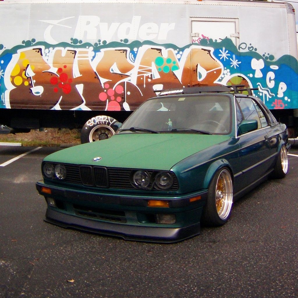

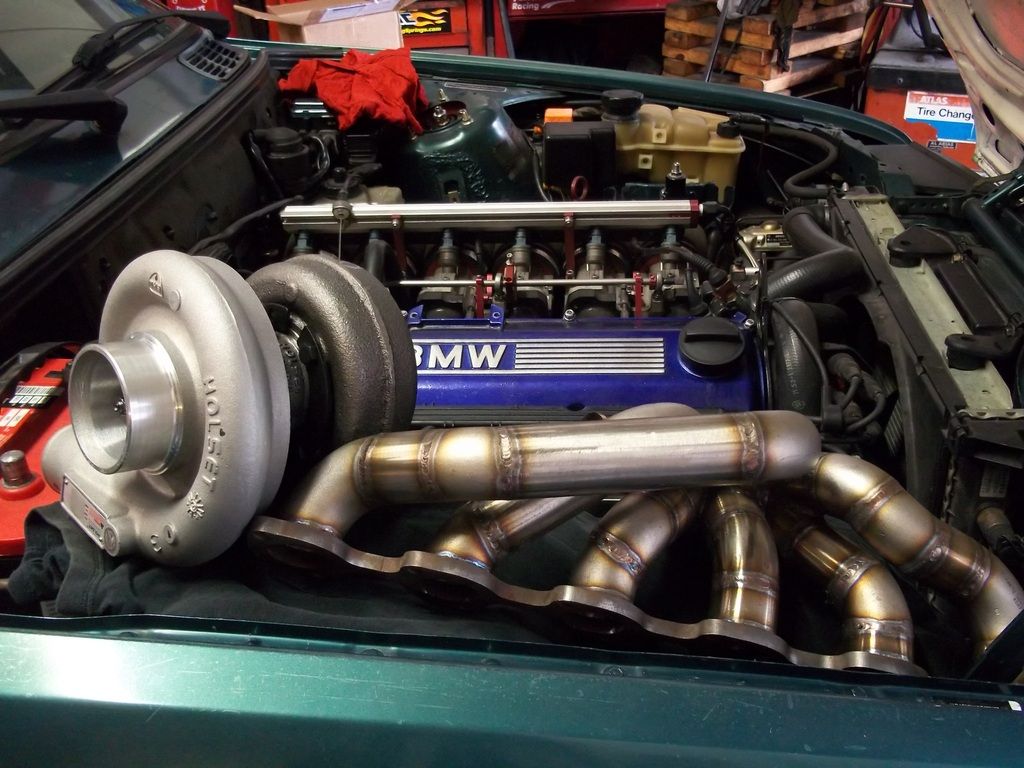

We have been working on this car for some time.
Bear with me for pics and build info, but here's a quick rundown:
WOT-Tech rebuilt head with 272 cam, HD rockers (Thanks IE and Skifree aka Andrew!)
Extrudabody ITB's (45mm)
E-level management with a mix of bags/struts from Air Lift (Thanks Open Road Tuning!)
Manual swap Bottom end re-seal, stock m20b25 (no rings/bearings [yet])
Whodwho Plug and Play MS2 (currently 180whp N/A [Thanks Keith!])
Race Skids
Good & Tight manifold (thanks Otis!)
Teaser pic...
