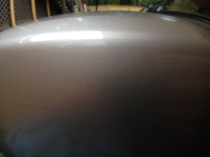

    So I decided to cut the paint a bit harder. I did 105 and 205 on the pass side with result I am very happy with, i also started the driver quarter. What do you think?
    Here is a close up of before:
    After:
    Amazing the difference alittle love will make.
