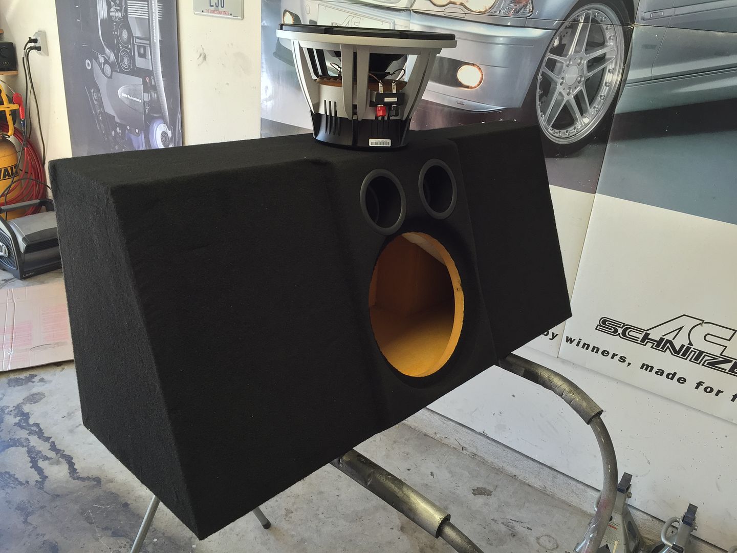

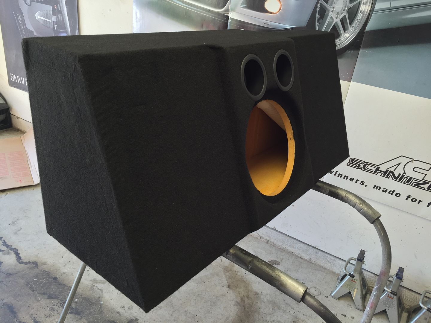

                              My special edition "MOSS" E3010 from German Audio Specialties showed up. Very nice construction here, Luke upgraded me with a fully sealed (waterproof) coating on the inside and out of the MDF box. The MOSS edition box has a recessed amplifier cubby, LED lit and fan cooled. The trim panel finisher should be here today or tomorrow.
                              Woofer is a JBL 1014D.

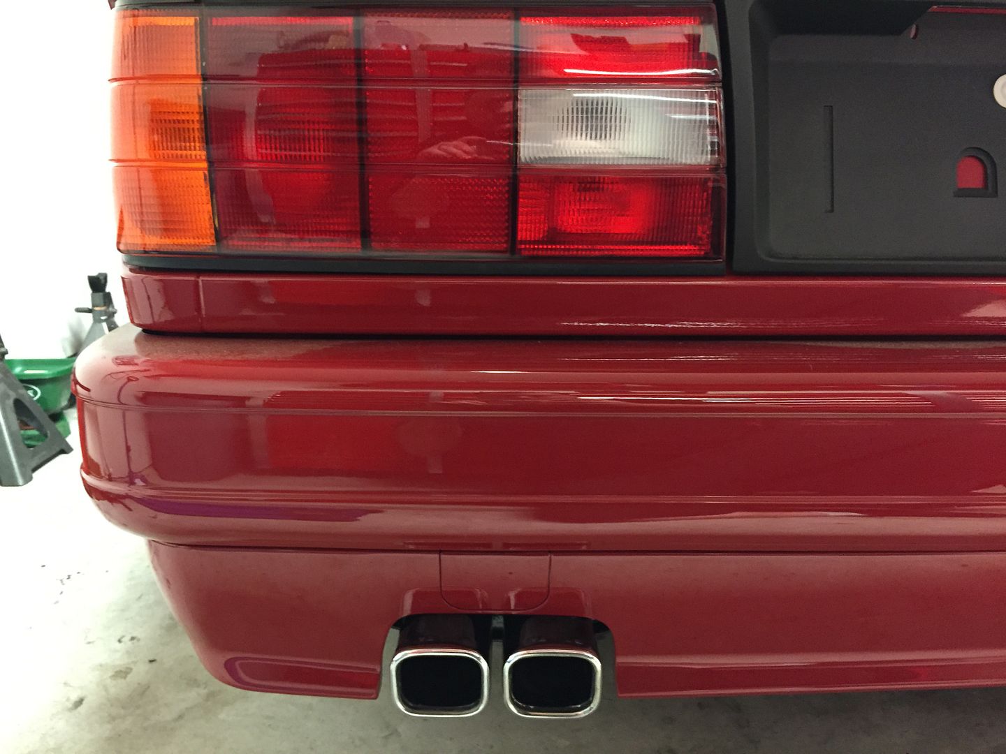

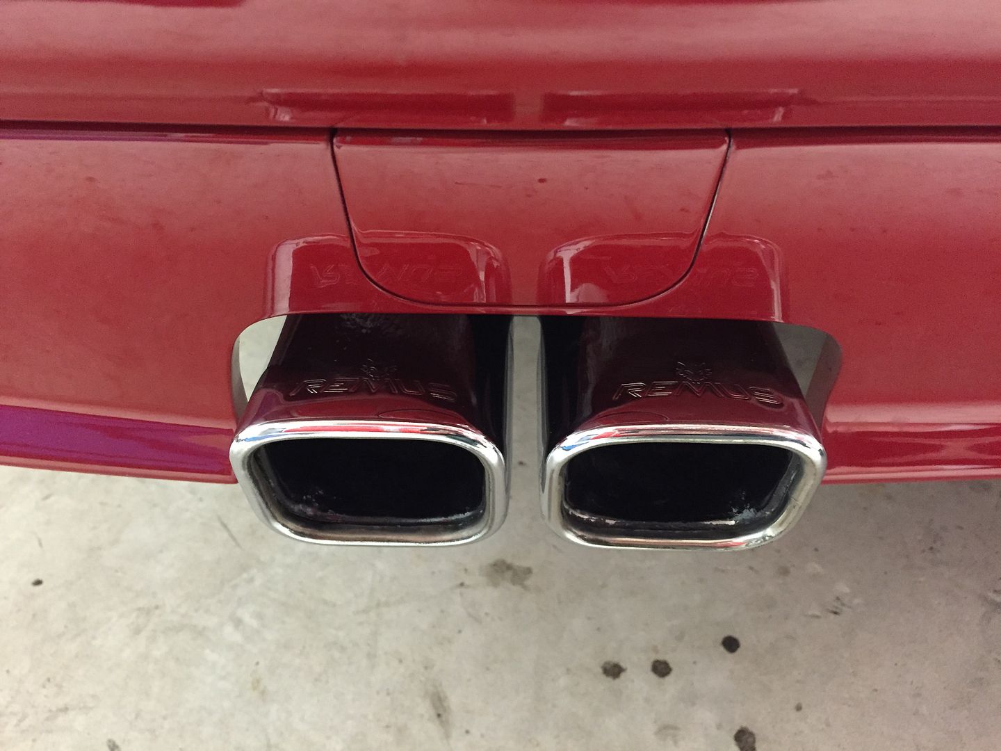

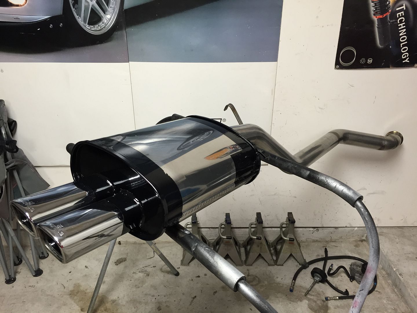

                              I also finished up the catback exhaust fabrication this week, as seen tacked and ready for TIG in the second to last photo above. I brought it over to my friends Wil and Alex at IDB Racing and they TIG'd it up while I hung out.
                              Finish welded, can resprayed in original style as supplied from Remus.
                              Installed on the car:
                              Car is much much quieter with a muffler now. Still sounds great, but much subdued.
