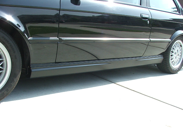

          Should I run these Mercury Sable skirts?
