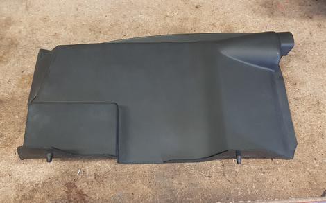

    3D printing probably isn't the right process for that piece. It being a thin and complex part there's no way to print it that will take advantage of the material's strength, and layer adhesion will always be a factor no matter which orientation it is printed in. It'll work it would just be a lot of print time due to support requirements and the part will probably be fragile and prone to warping. What's the foam tape you have between the radiator and core support? I need to get my hands on some of that.
    Well, damn. But that makes alot of sense. Thanks for the insights. I guess I'll need to consider laminating the piece over foam mold or something like that. The foam tape is self-adhesive closed cell tape made of soft EPDM. It's a pretty universal product with different companies making similar products.
      Perheps printing a piece, and then putting carbon or fiberglass over it.

        I increased the thickness to 2 mm and added stiffening ribs to the part. It's now in the process of being printed.

          BMW made a part very similar to the one you are making. Have you tried it already? Part #1714106
          Edit: There is one in Slovakia ebay right now for $29.00.
            https://www.ebay.com/itm/BMW-e30-pla...UAAOSwdTRexkuq
            Thanks for the tip. I wasn't actually aware of that shape of plastic. I knew there was the M3 plastic cover:
            Click image for larger version  Name:	20190225_123832_470x.jpg?v=1551745344.jpg Views:	0 Size:	27.1 KB ID:	9929564
            And the M40 engine version:
            1714106 is the plastic mold number for the part you posted. After a bit of research the actual part number seems to be 12521714106 and it was used in US 318i and 318is and the European 324 td. It might be better shaped for my purposes than either of the above but it would still require modification so I'll stick with the 3D printed part. But thanks for the tip. It was interesting to learn about that and if there was no 3D printing possibility, I would be thrilled about that. I've done a bit more consulting about 3D printing and in case there's problem with the filament printing, I can easily have the part made with laser sintering technology for pretty cheap.
