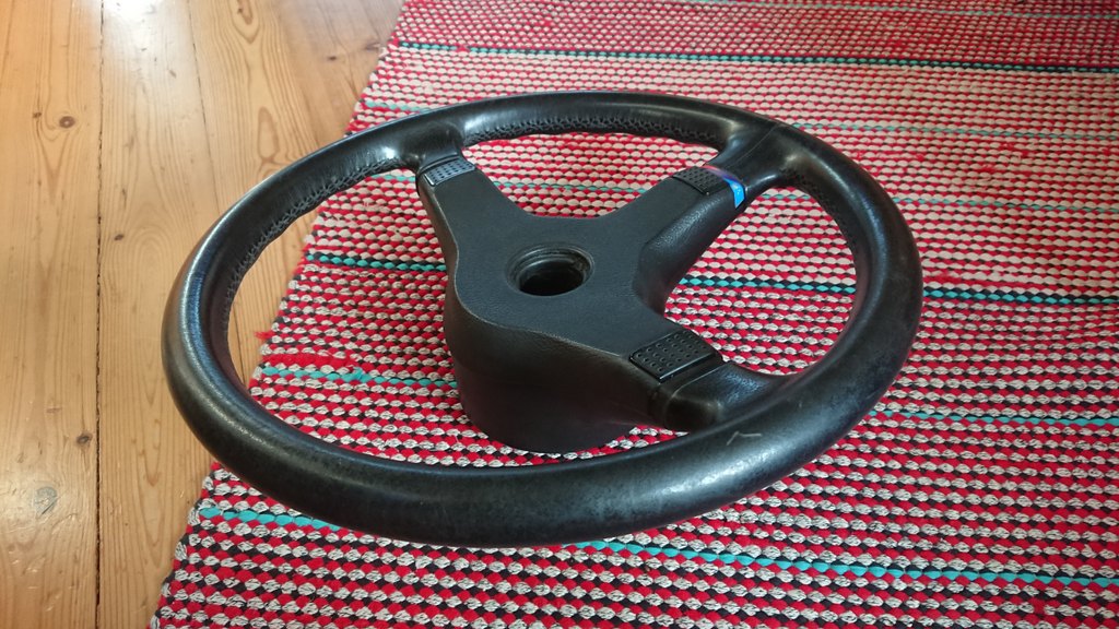

      Last weekend's small project was restoring the steering wheel. It wasn't that bad even to begin with:
      The leather was in pretty good condition except the finish had worn through where the left hand rests. It also had a few assorted scratches and the stitching had ripped above the left spoke. As the first step I refinished the leather meaning I wiped it with degreaser, sanded it matte with 320 grit sanding paper and gave it four thin coats of Furniture Clinic leather paint. It improved the look tremendously. Next I took care of the worn stitches. I figured out the stitching pattern by looking carefully at the intact areas. Then it was just a matter of grabbing black stitching thread and a needle and copying what I saw. Before closing the leather I spread some glue under the leather where it had detached.
      It turned out pretty well. Not quite as even stitch as originally but not bad for a first try. When pulling the thread tight to close the seam you need to be careful not to snap the thread. It helps if you use the other hand to squeeze the leather together and then just take in the slack in the thread. I should have repaired the stitches before painting the leather. When stitching, I left some scuff marks on the leather so I gave it another coat of leather paint to tidy it up. The M-stripes at the center spoke were pretty worn with the paint chipping at the blue and the red stripe so I mixed up right colors and gave them a touch up.
      The end result is pretty nice
      It's a little shy of an actually reupholstered steering wheel but repairing something old and doing it all myself is just very satisfying for me. Still I might buy a new M-patch for the wheel as I just learned that they are available individually.
