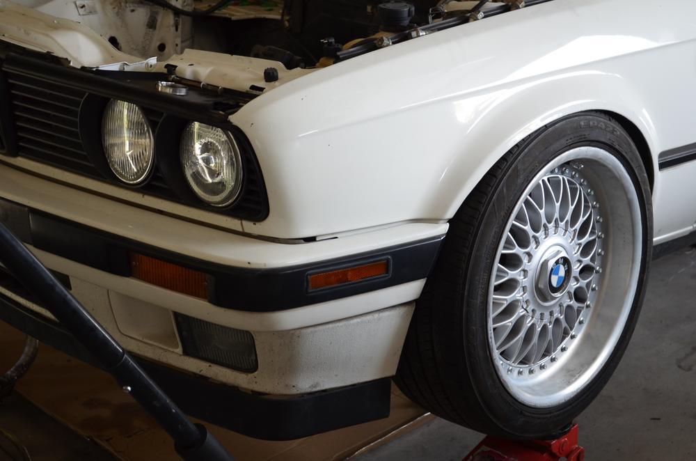

                                Some small updates and teasers.
                                I bought a square set of 17x8 RC090's and i'll just tease you all with this test fit shot

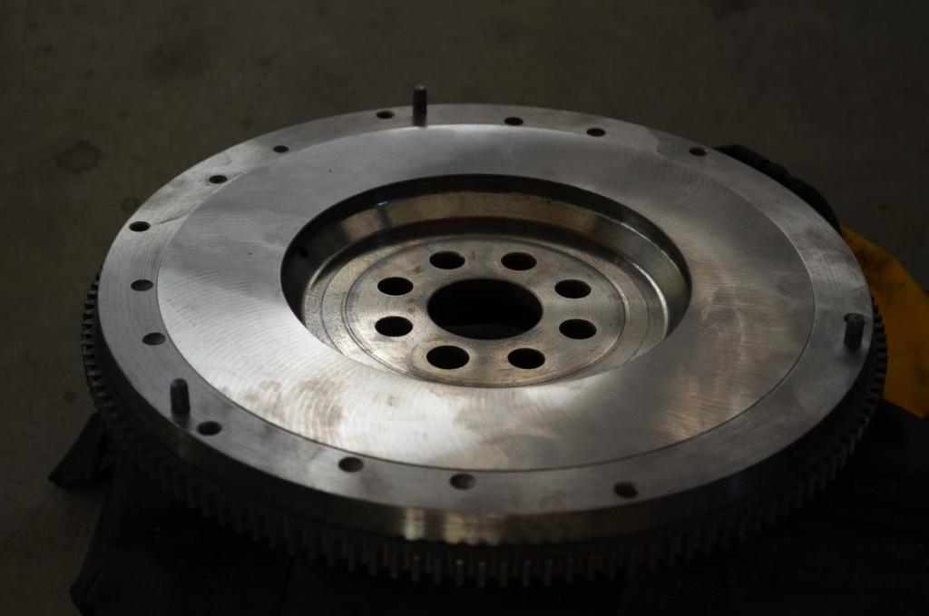

                                I also finally got my flywheel back, its been lightened and resurfaced.
