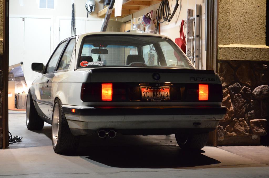

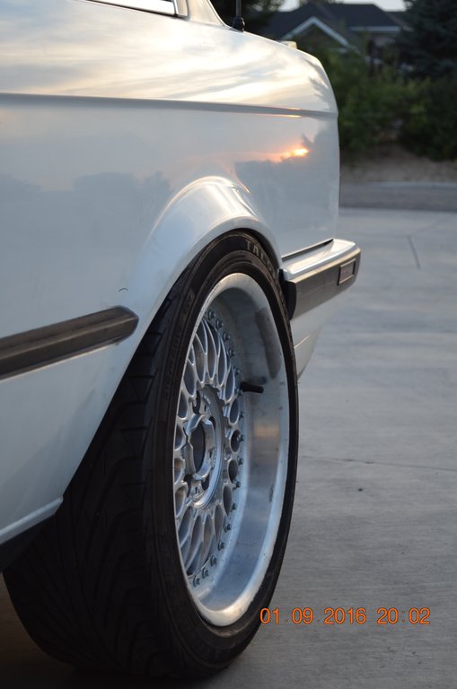

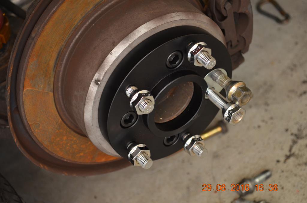

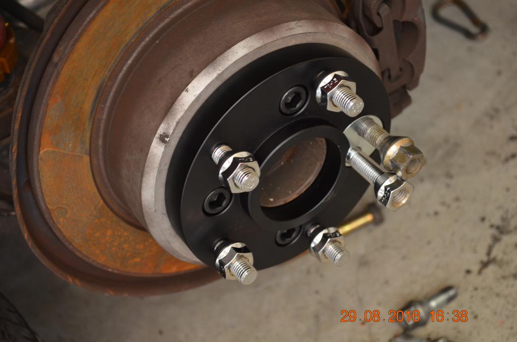

        I got around to putting on my adapters from Mushi, and rolling my rear fenders, (thanks for the roller "Big Willy.")
        215/45 with 18mm adapters = super sexy stants.

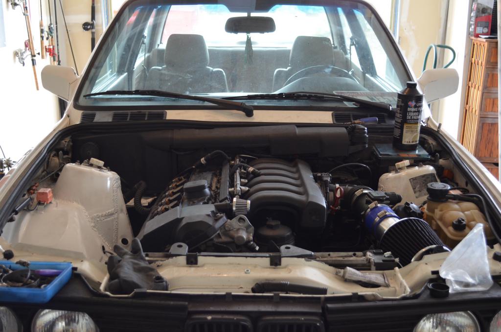

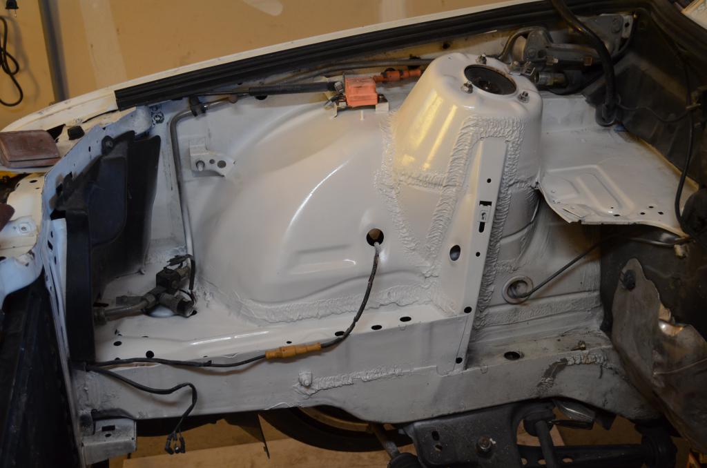

          Welded the oil pump nut and threw the e34 pan up.

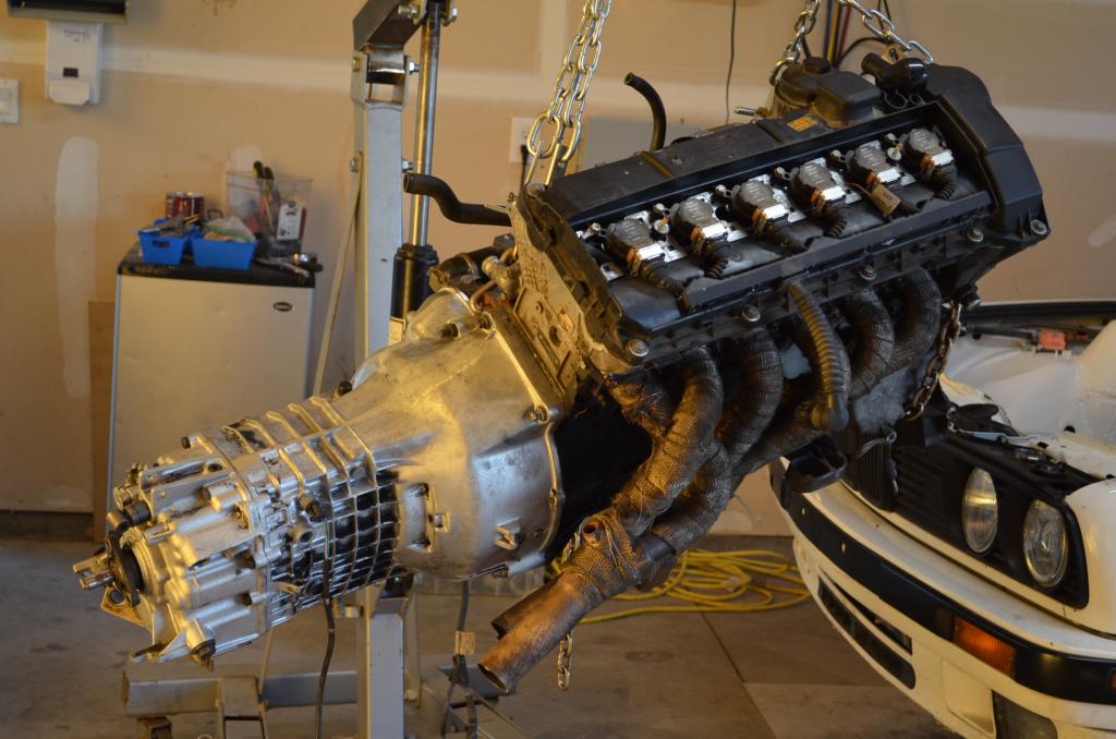

          Ended up mating the g260 along with the lightened flywheel, spec stage 2 clutch.
          But I forgot the pilot bearing so I pulled the motor out.
          I threw a new pilot bearing inside, but before I did I decided to do a bit of shaving and repainting.
          Motor waiting to go in, I cleaned up the transmission and wrapped the headers too.
          Motor sitting in on condor 24v swap mounts, and custom mount spacers I made.

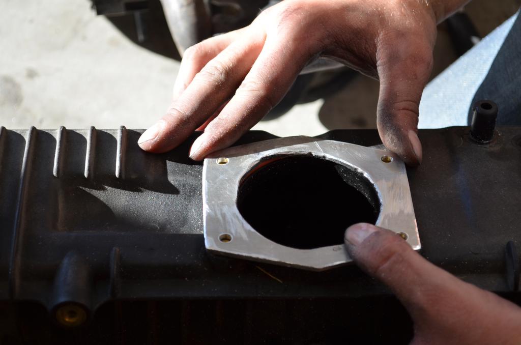

          M52 throttle body to m50 manifold metal gasket.
          More updates coming soon.
            215/45 with 18mm adapters = super rub a dub dub all the time.
              Way to be a debby downer.

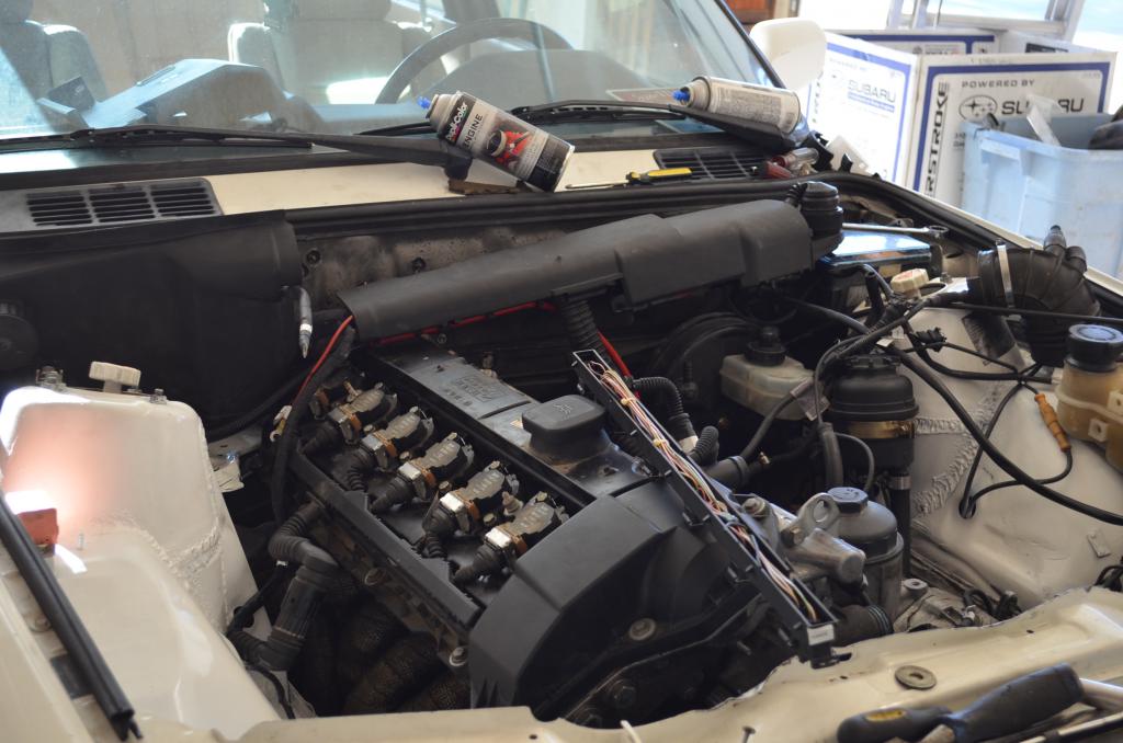

                I finally buttoned up all my wiring, and started the car.
                Having my harness modified by Kadunza was definitely a game changer.

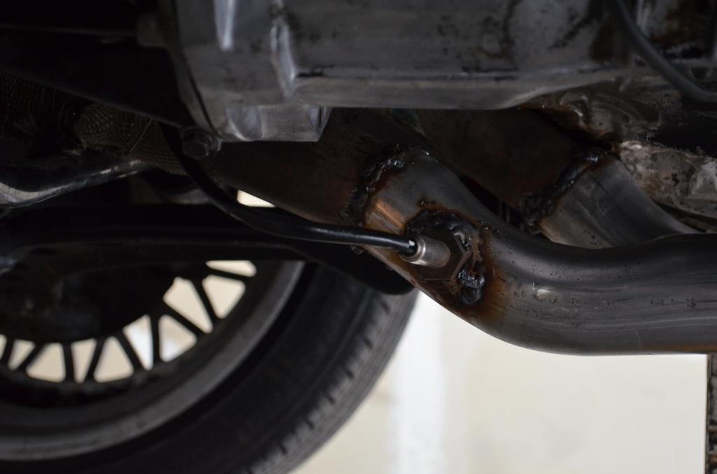

                Welded up my 2nd o2 sensor because I couldn't fit it on the header bung.
                (the welds are crappy, but they work.)

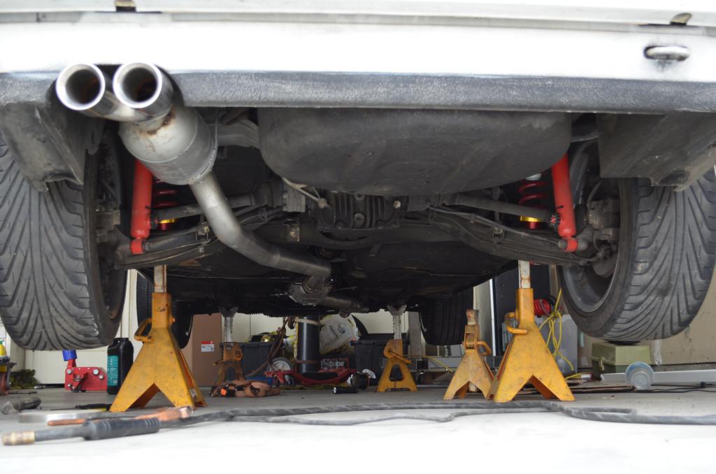

                My Dad welded up the rest of the exhaust and everything looks great.
                Specs are full 2.5' piping with eBay headers, aero resonator, and a gutted cat.

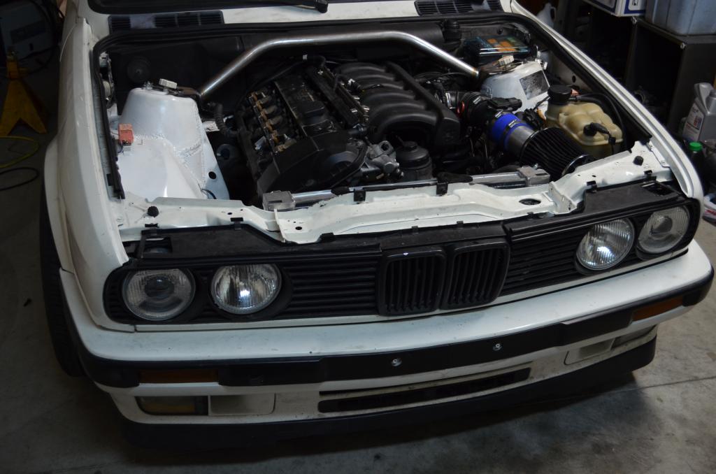

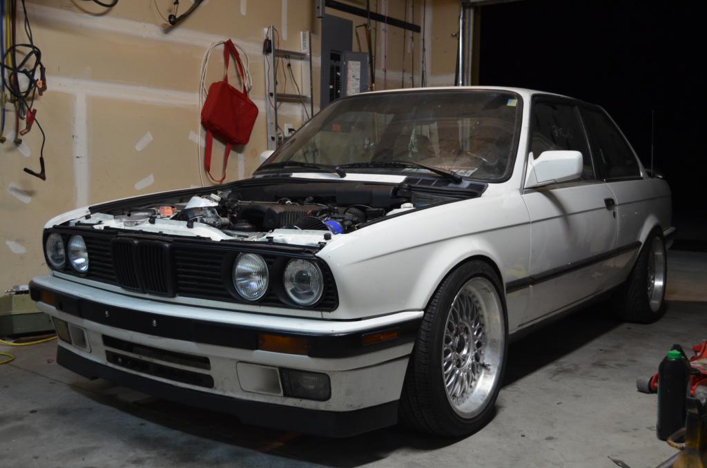

                      Well its done, I didn't exactly get it fully functional before my 18th birthday but I almost met the deadline.
                      Other updates include an eBay mishimoto rad, e30 m3 fan switch, and a few other goodies you all should stay tuned for.
