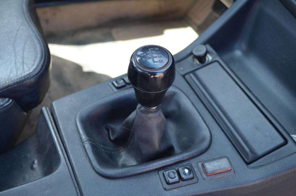

        I found the reason my car was so difficult to get into 2nd and 4th gear (my shift carrier was not connected to the rear bushing, thanks obama.)
        So I used the garagistic delrin shifter rebuild kit to replace all my worn out shift carrier bushings, I also threw on a Z3 lever and it feels great.
        (excuse the ghetto shift knob, I need a new one.)
Name:	3 - uYlyTEi.jpg

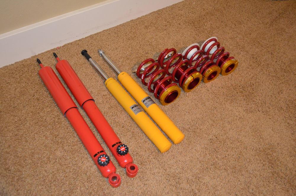

        Now things are spicing up, I decided I wanted to build real coilovers so here is what I chose to fullfill this desire.
Name:	5 - s3WOBxj.jpg
        - GC conversion kit.
        - Front Koni 325ix insert's.
        - Rear KYB AGX camaro shocks.

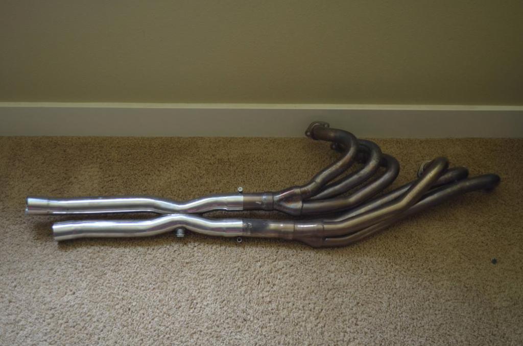

        Ebay headers I picked up cheap.
Name:	1 - DAcIzTe.jpg

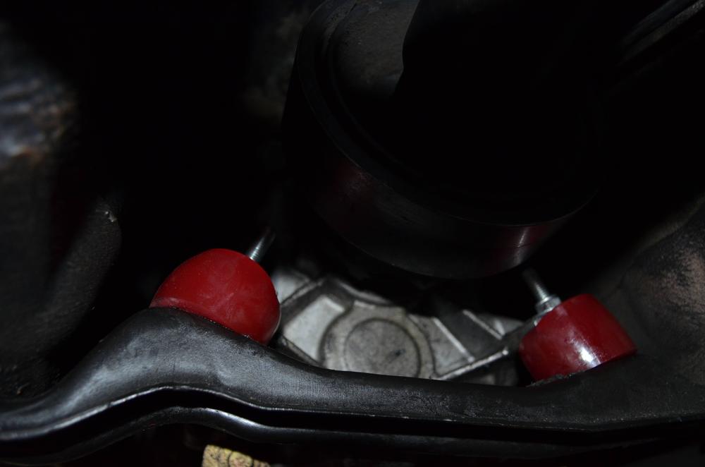

              Installed Garagistic transmission mounts today!
Name:	2 - ryvavj7.jpg

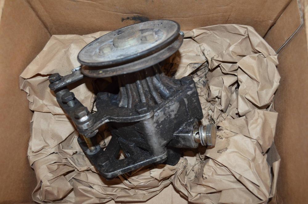

              I also swapped out my power steering pump with an e28 pump which I had to bend and cut the brackets to make fit.
Name:	3 - ktGC9d0.jpg

                Why the e28 PS pump?
                    I got a great deal on it, I put atf in the car and I got it bled out in two minutes.

                      • phenryiv1
                        • Jul 2009
                        • 3246
                        I was just wondering because I am swapping an SETA 2.7i from an e28 into my e30 and it currently has the E28 PS pump on it. I did not know if there was some advantage to the E28 PS pump.
                        Did the lines all route like normal to the e30 reservoir location?
                          Yes the lines routed up just fine.

                              • White325is
                                • Oct 2006
                                • 5947
                                [ATTACH]106605[/ATTACH]
                                Them mounts look all fudged up. Why are they so deformed?
