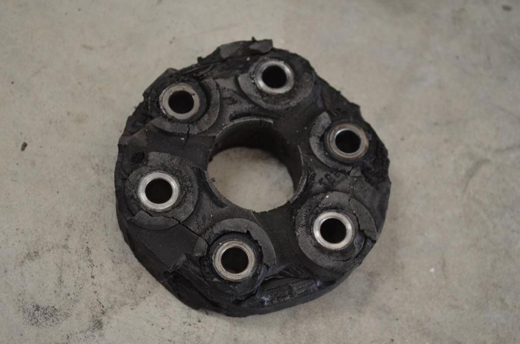

            I'm expieriencing a small problem, maybe one of you can shed some light or give me helpful input on to what is causing this.
            When I am driving and I accelerate past 4,000 rpm's, the car starts shaking from around the transmission it seems like.
            Also in neutral when the clutch is depressed it makes a chattery funny sound.
            Are these problems interrelated? I think it's a throw-out bearing but I've been wrong before.

              #36
              Sounds like TOB but could be the guibo or CSB failing.

                #37
                Car looks great. Hope to see it at the next cars/coffee:).
                Check you guibo and if that is shot, check the csb; most likely it is shot too.

                    #39
                    I would say sounds like opposite of TOB to be honest, usually they are noisy when idling in neutral, but go away when the clutch is depressed. I know my current TOB is on its way out, and thats the sounds it makes.

                            #43
                            Headers installed, & with the help of my dad, I was able to build a 2.5' full exhaust for the car.
Name:	ONNPhU6 - Imgur.jpg
                            Smiley's wired up.
Name:	1 - aaR9WPz.jpg
                            Old guibo.
Name:	3 - poZrZJt.jpg
                            New guibo.
Name:	4 - IWU0mWt.jpg
                            New csb, the old one was pretty much non-exsistant.
Name:	2 - gxeFFmD.jpg

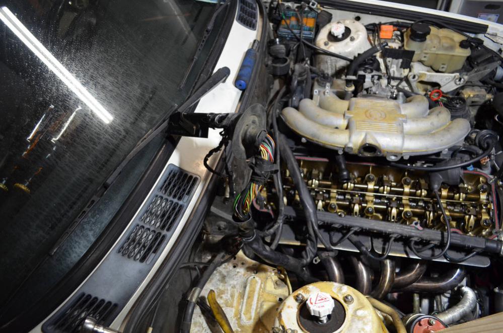

                              More Updates.
                              After I put my driveline back up, I changed my oil, topped off the coolant and let it run then I drove it and it was a blast.
                              The next day I checked my dipstick and it looks like I have officially blown a head gasket because my coolant and oil have mixed hard.
                              If you look close enough you can see the coolant/oil mixture at the bottom.
Name:	2 - bDysOex.jpg
                              I decided its time for a 24v, so I started pulling my harness in order to pull the motor out.
                              It's m50 time folks, i'll be collecting parts for the swap starting now.
Name:	1 - mWfupmJ.jpg

                                #45
                                Found the cause of my blown headgasket.
                                My head-studs where only torque'd to 20ish lbs.
                                The motor I'll be receiving is a
                                M50b25tu out of a 1993 325i.
                                The engine has been maintained, and has great compression.
