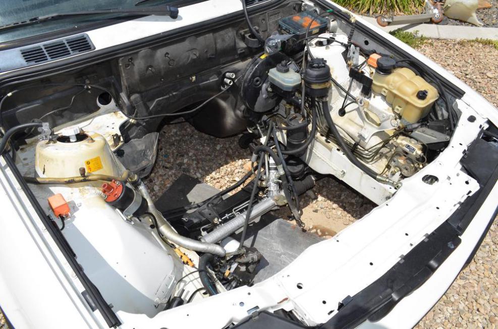

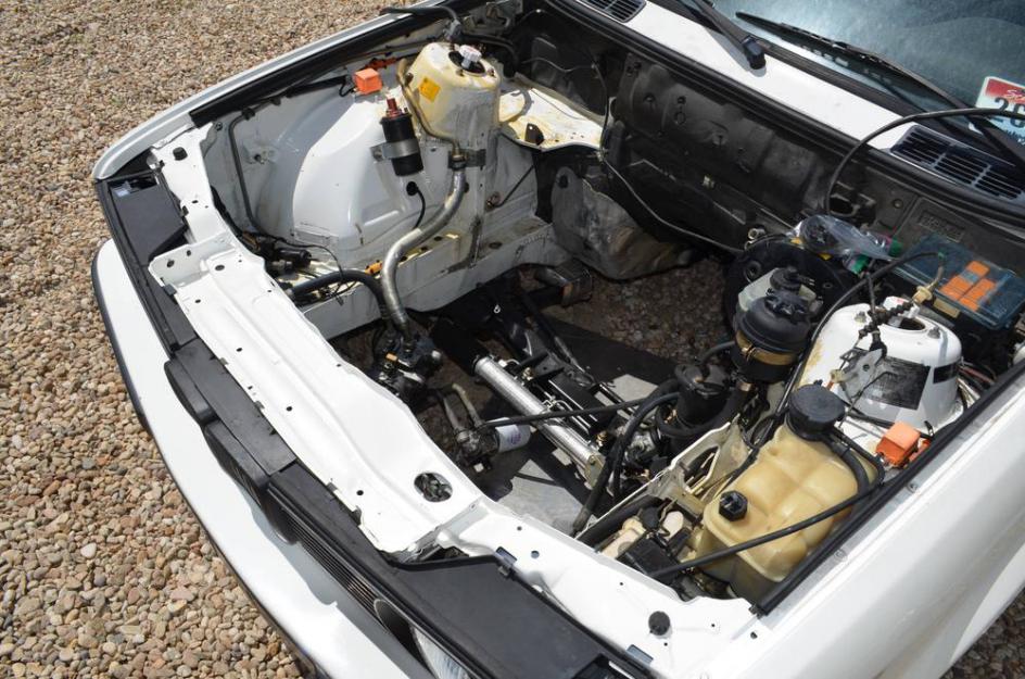

        M20 is out
        M20 is pulled out, so that means I have to drop something in it.
        I'm thinking that maybe I drop a few mixtape's and a big bonfire inside the bay before the 24v arrives.
Name:	1 - Qx6VCWn.jpg
Name:	2 - xBzsV7d.jpg
Name:	3 - q2rwJBG.jpg
        Pressure washed and degreased, I think it came out great.

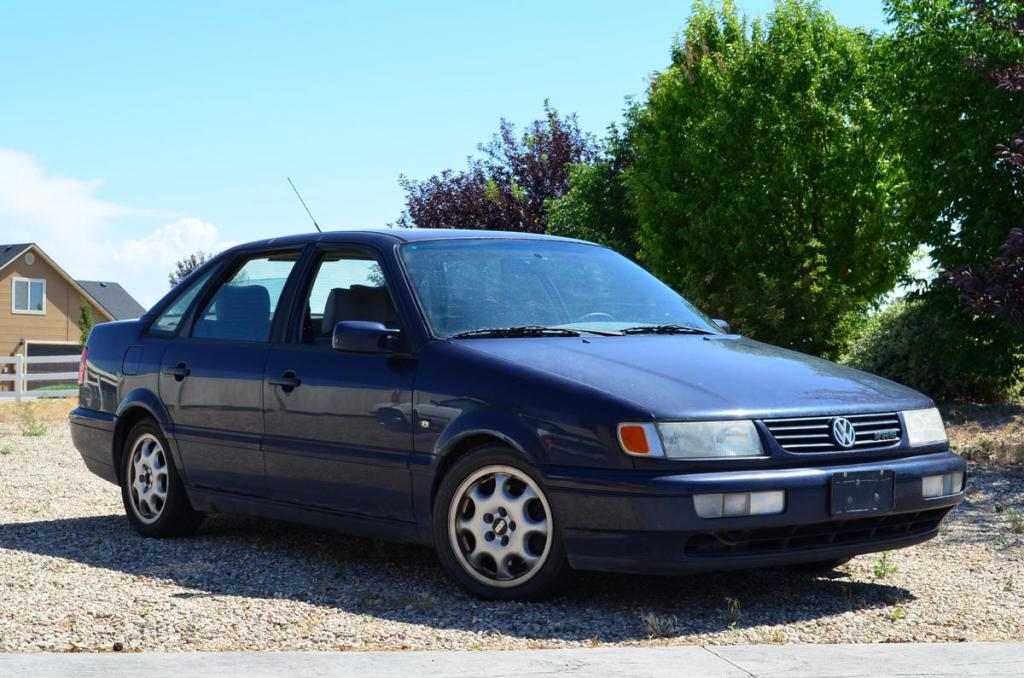

                                I finally sold my avid wheels today and I should be shipping my harness and ECU out to kadunza . I'll be going with a 944 booster for those of you who are wondering.
                                And since cash is short, I've picked this bucket up to sell and hopefully make a coin.
