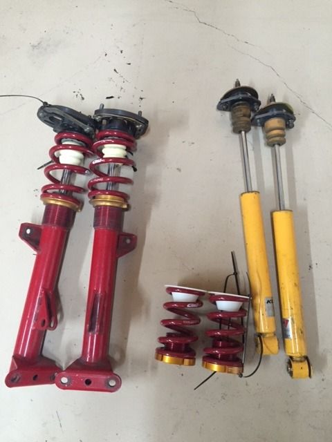

    Some of you may recognize the car for what it looked like up until about a week ago. Over the course of the past 4 years it has changed only a small amount and I was beginning to crave something else with it.

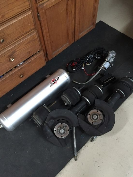

    Here we are in 2016, hoping to take the car a new direction. The old build thread is missing a bunch of information and pictures so we might as well start fresh here. I sold the complete airride setup and wheels to completely redo the suspension underneath the car. All of the bushings in the rear end were original to the car and needed some attention badly. The car was still fun on air, but as most can probably guess, the car can only be driven so aggressively and I was looking for something a bit more. I had the air on the car for 4ish years and it was practical for what I was doing with the car at the time, but now left something more to be desired.
    New setup:
    -Full GC/koni 5 lug conversion 550/750
    -e36 M3 front spindles
    -New e36 M3 control arms
    -AKG 95a poly offset cabs
    -New Tie rods
    -AKG 95a poly subframe bushings
    -AKG 95a poly trailing arm bushings
    -318ti rear trailing arms
    -new wheel bearings front/rear
    -Diff flush
    -AKG 95a poly diff mount
    -New FEQ axles
    -ST 22/19 sway bars with reinforcement tabs
    -Style 5's with 235/40's
    Looking forward to this year. Would also like to see an s54 in it at some point. Maybe down the road!

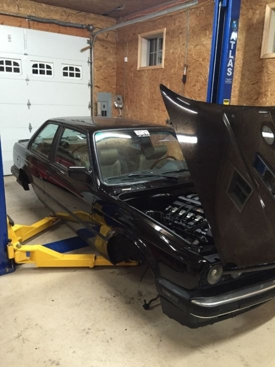

    Getting ready to tear it down
    All suspension removed

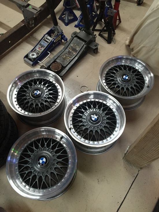

    Wheels off and sold to a fellow R3v'er
    Air off and also sold to a fellow member

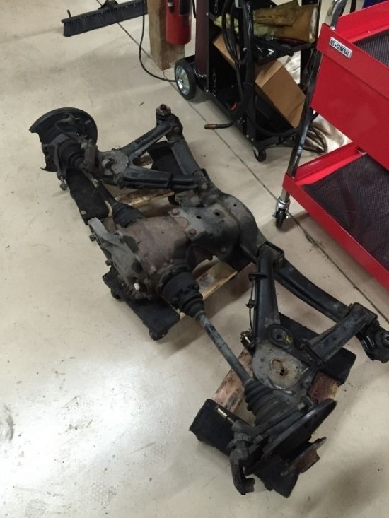

    Old, tired subframe out

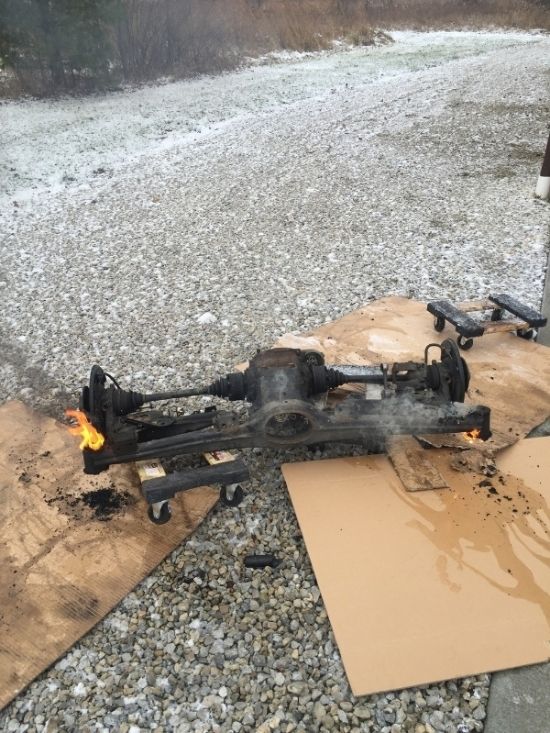

    Bushing removal the fun way

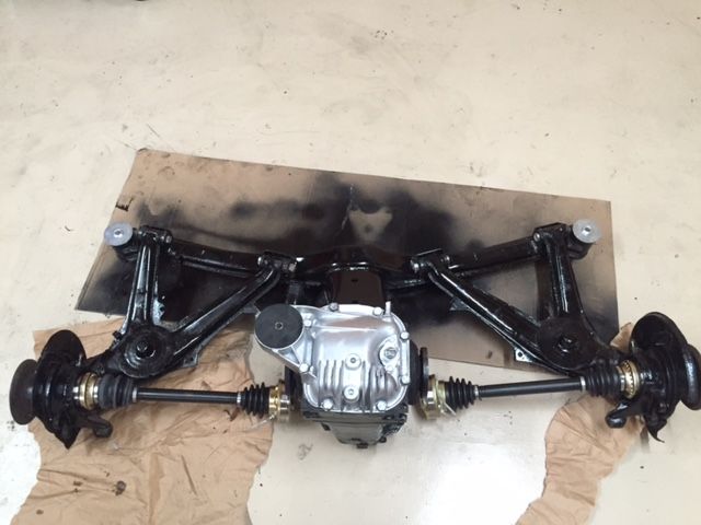

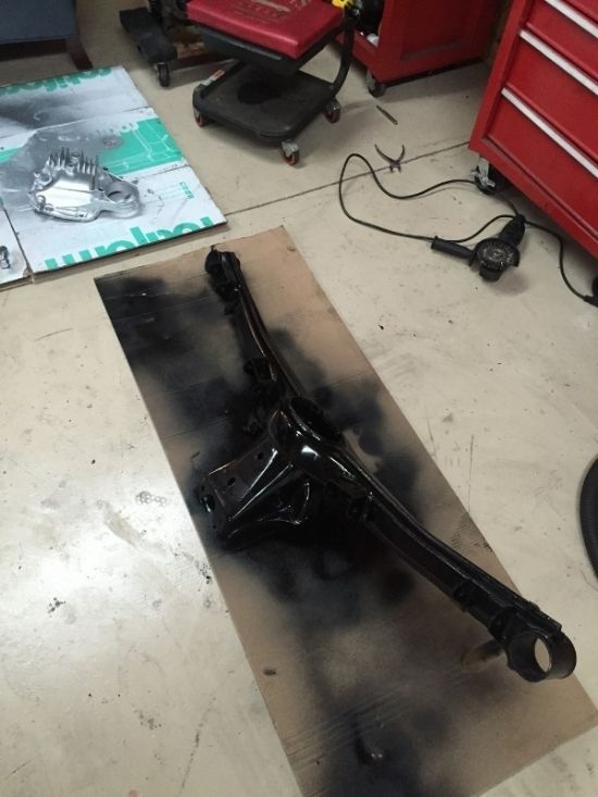

    Subframe with a coat of paint along with diff cover

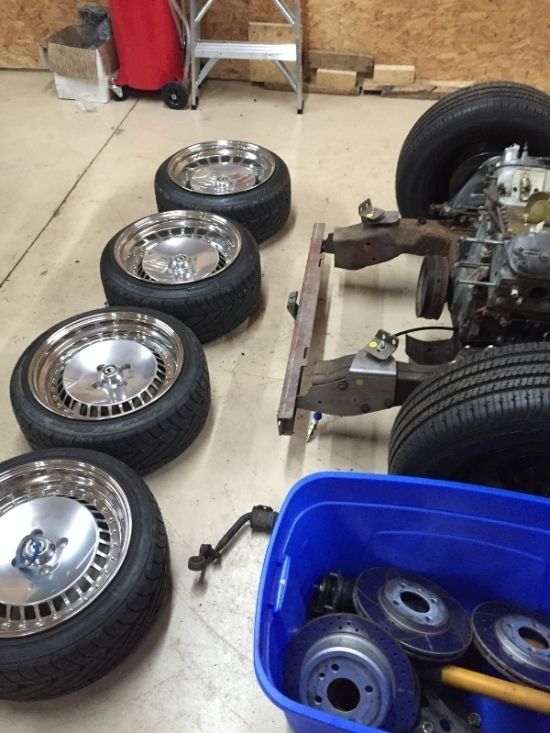

    Style 5's I picked up

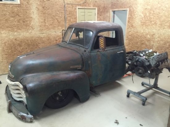

      S10 frame I see, 50's truck going on it?

        Thank you sir! Haha you have a good eye, long term build I work on when I have the time.

                  Jealous of your lift! Gonna be sweet, I hope you got the struts shortened or that they already are shorter with the 5lug conversion. Mine is almost bottomed out with stock height struts
                  Me likey the LS swap chevy truck!

                    They are shortened from GC. Just noticed your truck in your sig, ill have to check out the build!
                    Rear end all put together with the bushings. I opted for AKG's trailing arm bushing tool and it worked great. With a 1/2" impact the job was cake. Highly recommend it.
                    Waiting for the diff to dry before I bolt it up.

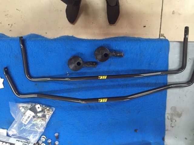

                    22mm front, 19mm rear ST bars and the poly offset cabs pressed into the lollipops. After doing this, wish I would have just gone with the treehouse setup but I wanted to save some money. Would of saved me some time and smacking my hand with the hammer a couple times and cleared up some room for my headers but oh well.
