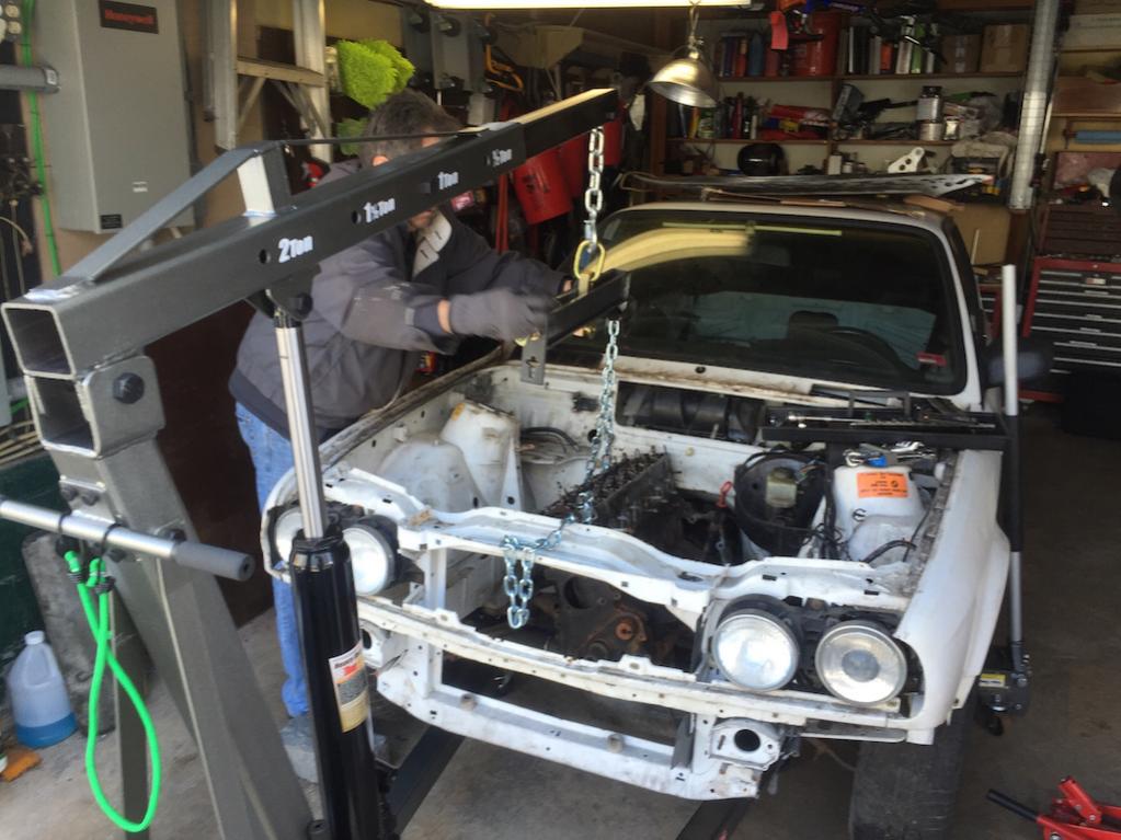

    So today we took the engine out. Was a little cold since we were standing outside with the crane. Took us two tries, as we hit the top of the garage doors right before it cleared the first time. So we unbolted the transmission and tried again which thankfully worked.

    Engine has seen better days.

    We used ratcheting ties to support the transmission and keep it from twisting of the jacks under it.
