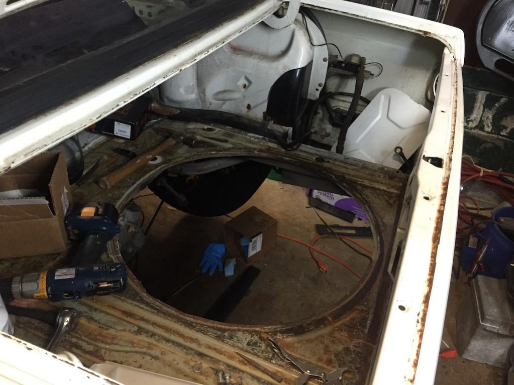

Got some more welding done ( sunday/ tonight).

Sorry for the lack of updates guys, e30 has been taking a bit of a back seat while the csl airbox was going in. Then my truck exhaust started falling off so I ended up replacing that, only for that to turn into a nightmare (pos toyota bolts were rusted to shit). I had two nuts left on the last header only to have the stud snap when the bolt was half way off. But so now the m3 is tuned, the truck runs again (tho still with a snapped stud), and the e30 is back on the menu. I welded a bit more on it prior to starting the csl conversion, but nothing major, plan on finishing the corners of the driver/passenger footwell this weekend. If I have time, I want to start the trunk as well, tho that might not get touched till next week/end. Once those are done, ill be ordering the engine to start fitment (plan is to turn the car into a run stand to make sure it works, then work on fitment of everything like brake booster etc).89 325i - s62 swap, 5 lug
