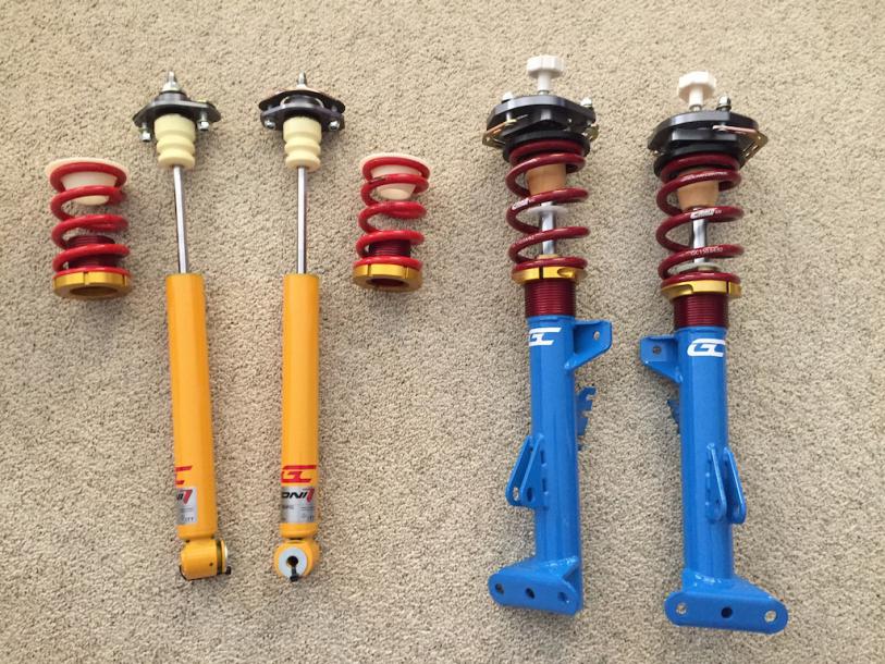

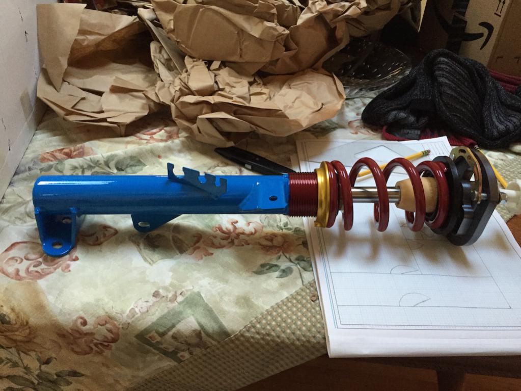

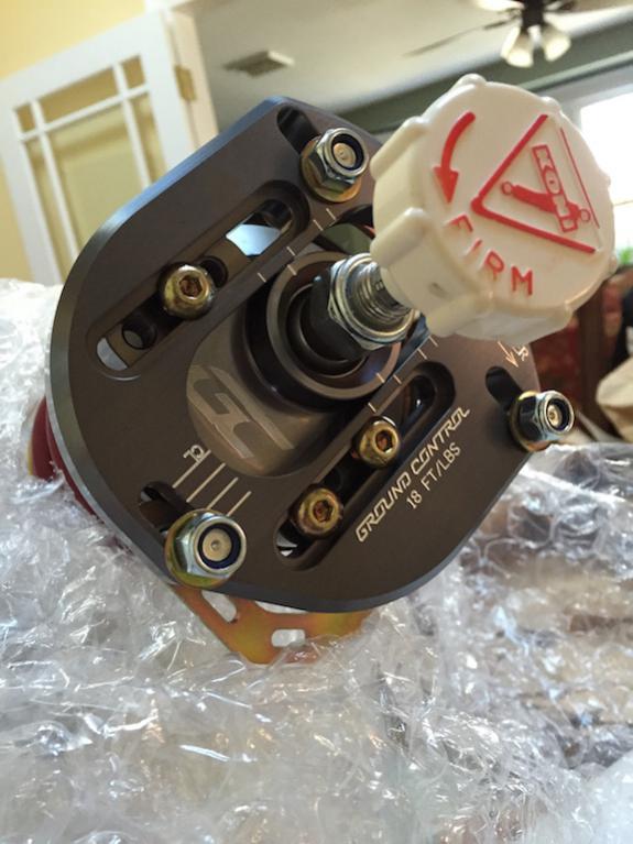

                      Had some mishaps with ups, but a neighbor way down the street came over this morning to tell me that she had my coilovers and welder sitting in her house.
                      Ground control coilovers specifically for the e36 m3/mz3 5 lug option (they fit 318 and z3 as well.

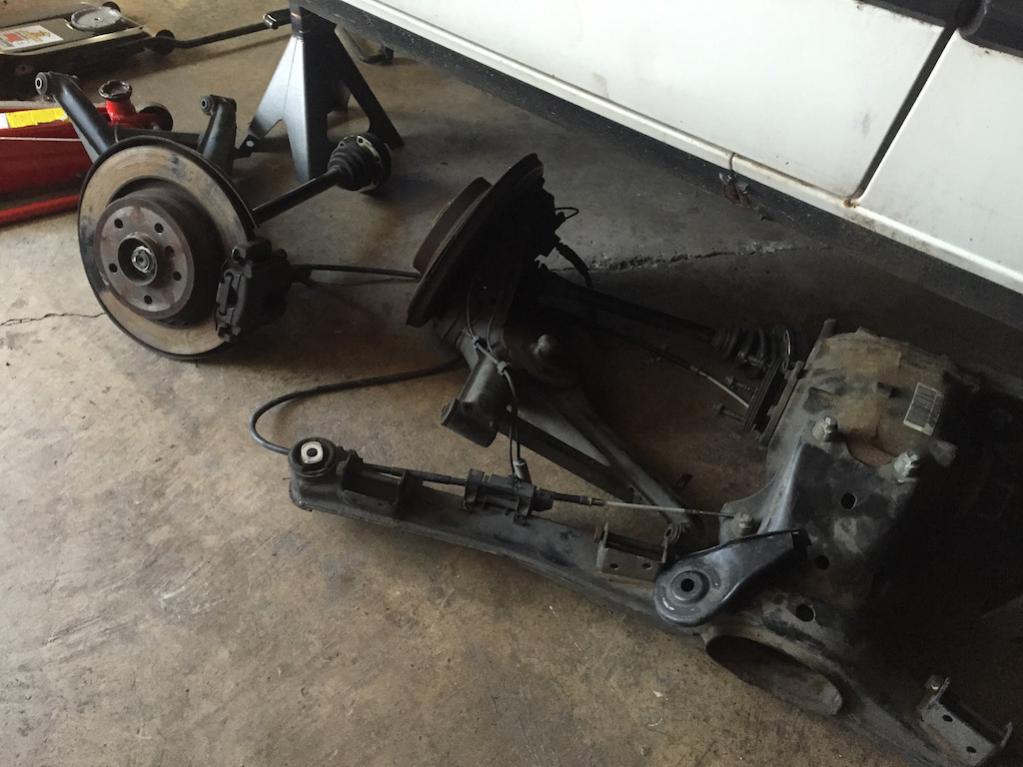

                        Drove out to connecticut this morning to pick up a full mz3 rear from a front end totaled 80k mi car. Plan on putting this, along with the coilovers, on the car tomorrow.

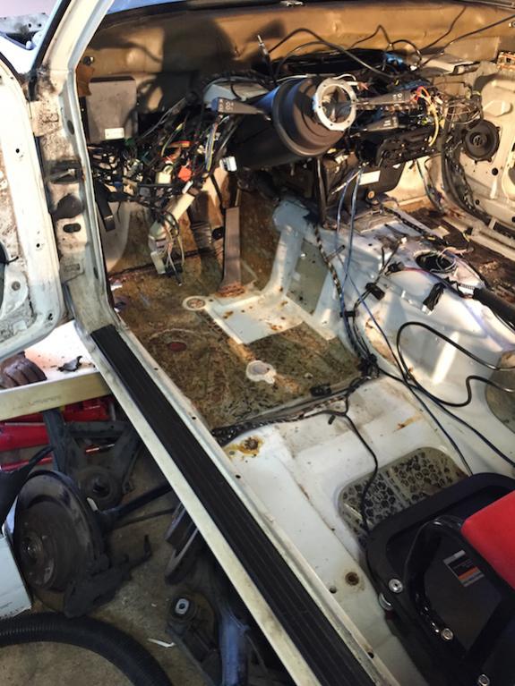

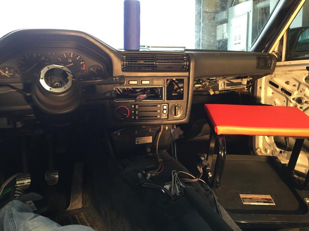

                                Last weekend, my dad took a spill on his ducati (his shoulder is a bit sore, bike is fine too), so I did not have the extra set of hands to do the 5 lug swap. Instead, I began pulling the dash apart.

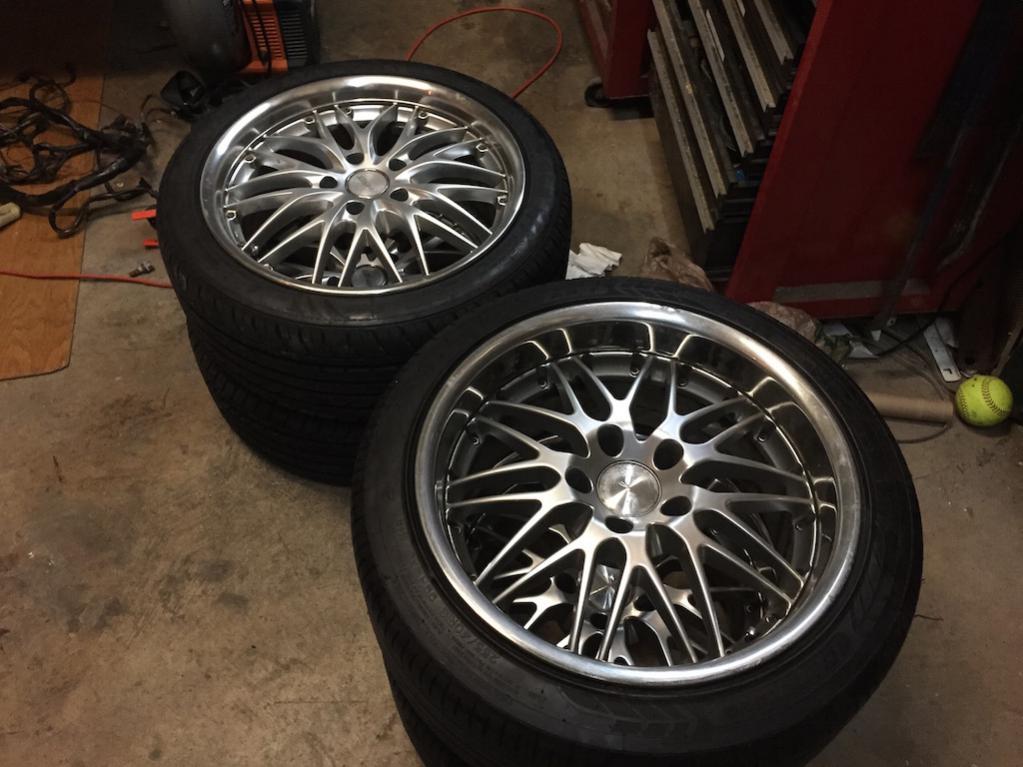

                                During the week, my dads buddy hit us up about a set of wheels he was selling. Figured use these to push the car around on until I decide on what wheels to get. They are 18s, so they might end up on my m3 eventually.

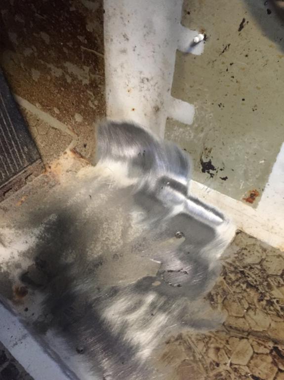

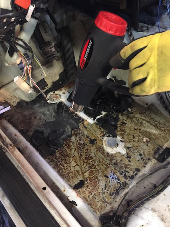

                                Pulled the rest of the interior this weekend, as well as removing the sound deadening. I finally got a good look on what needs to be repaired on the floor (actually less than I originally thought, so its good). Ground down a decent bit of surface rust and removed some shitty patch stuff the previous owner used. Some holes, but luckily mostly pitting. I will def get some good use out of the welder I bought.

                                Moving forward, I will continue to work on the interior. I plan continuing to strip what needs to be welded this week/next weekend. Depending on how my dad feels, the 5 lug stuff might go on the car next weekend as well.
