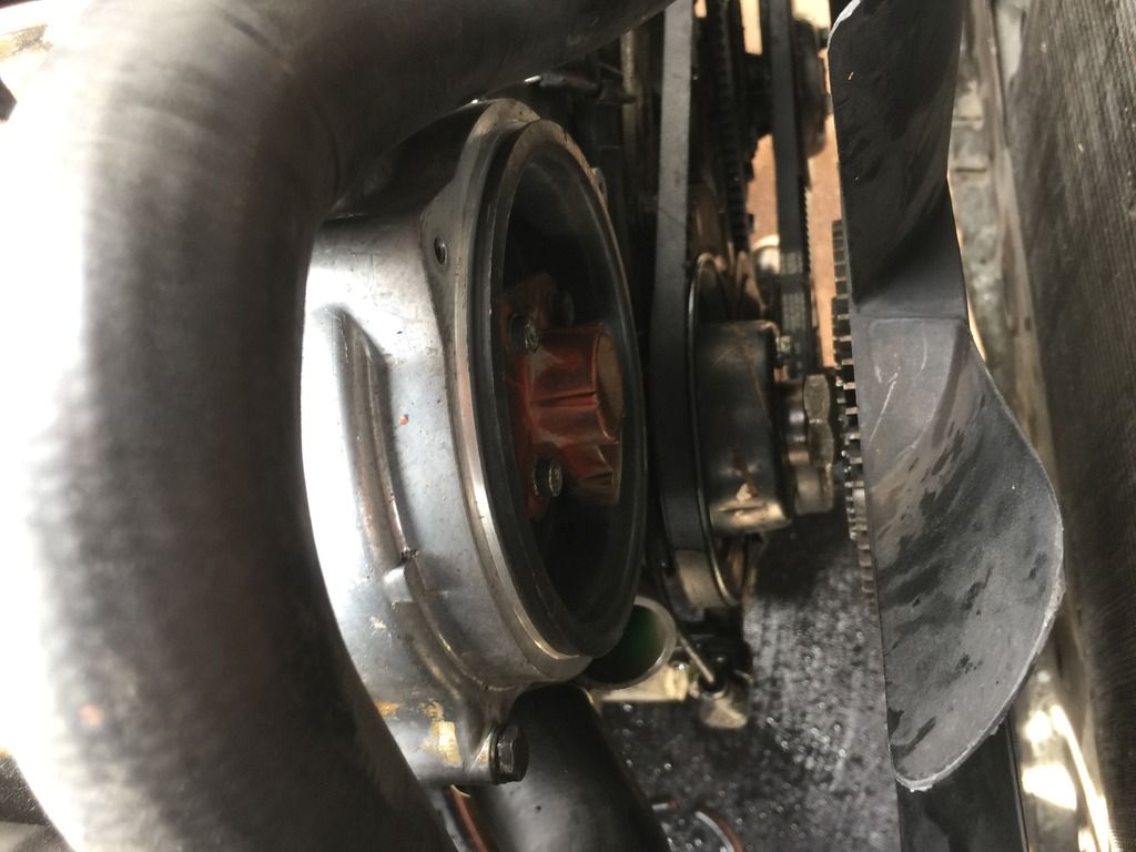

        Looks like I need a new rotor too..
        Definitely need a new cap..
