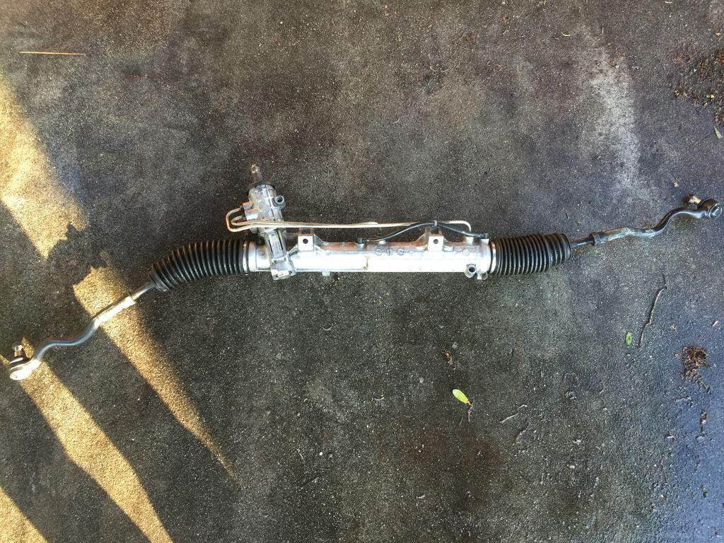

          Last weekend I decided that I am going to go ahead and tackle the steering rack swap.

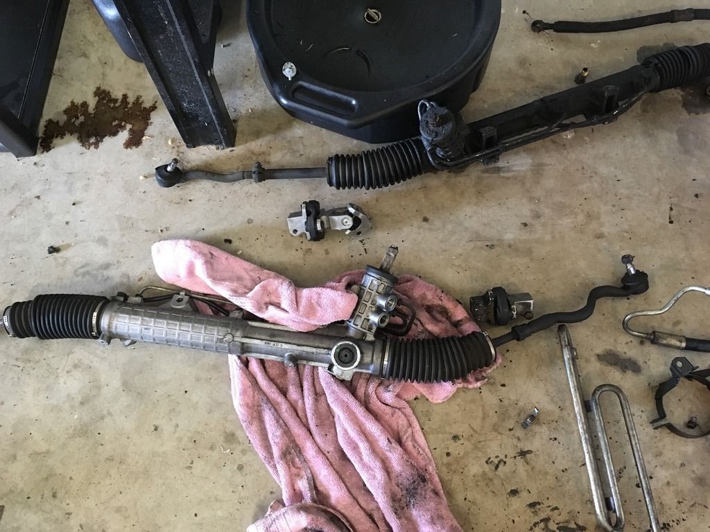

          Started by cleaning new components.
          M3 rack cleaned up pretty nice IMO, decided to reuse existing E36 tie rods on it, since they were in good shape and the rack only has about 90k miles.

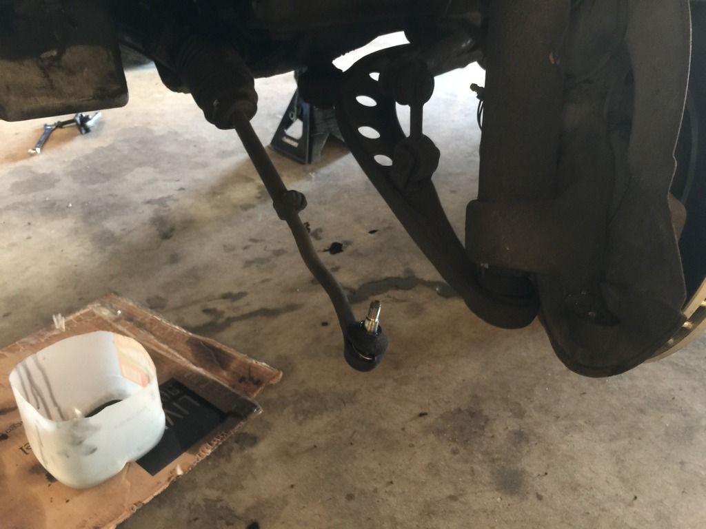

          Removing old, crappy tie rods.
          Free!
          Old vs new

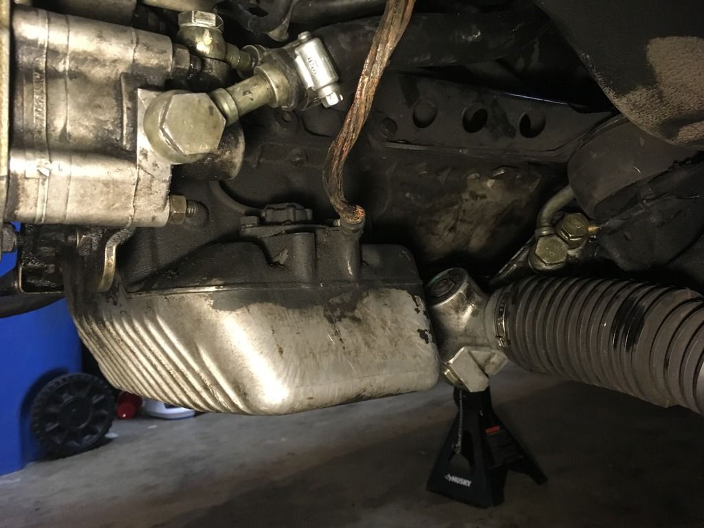

          I decided to use the M3 reservoir with E30 lines. Cleaned up pretty nice.

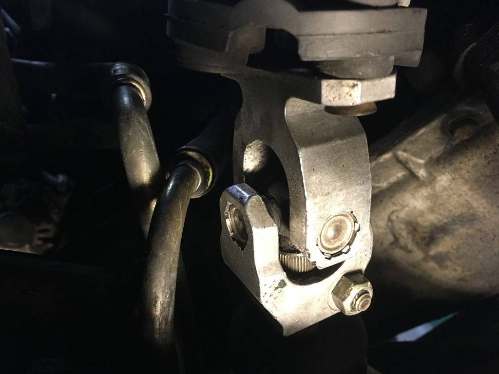

          Then I mounted the new rack into the subframe. This wasn't too bad, just had to wiggle it around enough that it fit properly. Aligning the subframe spacers was tedious, but I eventually got it in. Massaging the column into the universal joint was not too bad actually!
          New rack mounted
          Close up showing the spacer
          So the power steering lines were a nightmare... Its impossible to tighten down the banjo bolts and have the lines align properly. I had a horrible time with this, ended up using the E36 line for LP.
          Here is my setup (man I need a new ground cable)
          Had to bend the PS hoses a bit, because they were hitting the universal joint!

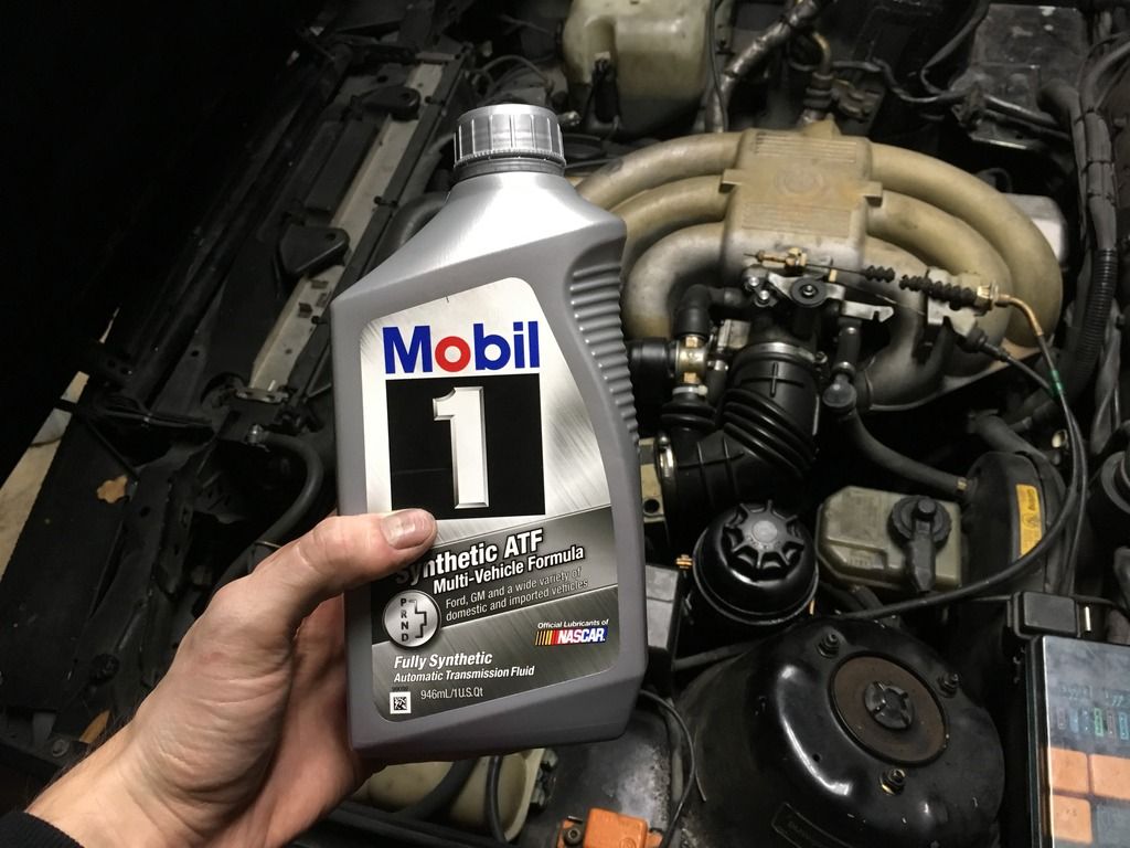

            Filled the reservoir up with Mobil 1 ATF
            Turned the car on and turned the steering wheel back and forth to circulate PS fluid. Checked for leaks, and refilled ATF.

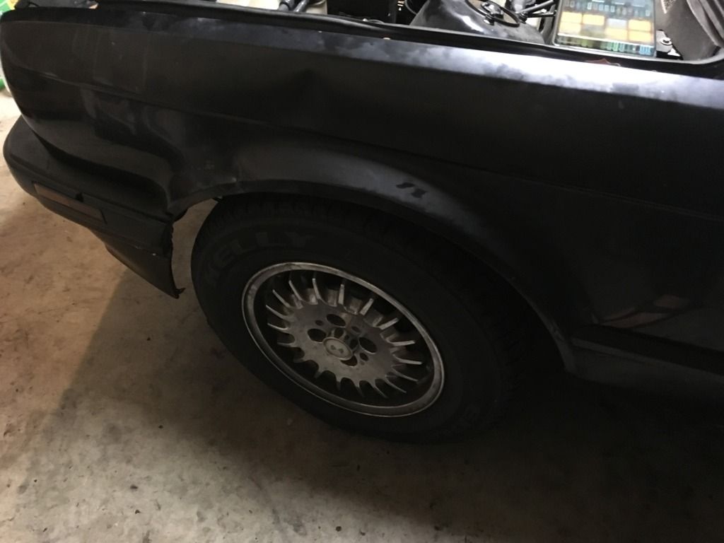

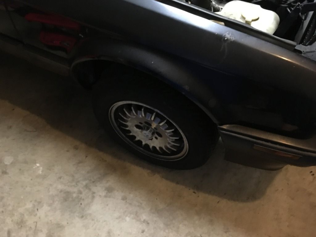

              Took the car to the alignment shop and was told that my wheels are mismatched, so they are unable to do a proper alignment job on the car. I have never noticed this (never really paid attention), its a huge bummer! The guys over at Hinson's Tires in Morro Bay were super nice though and helped me at least eyeball align the wheels so the car is not a complete wreck to steer.

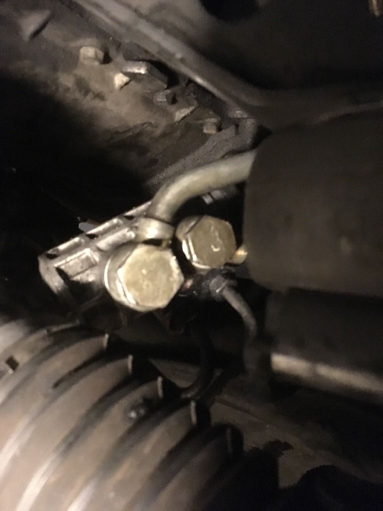

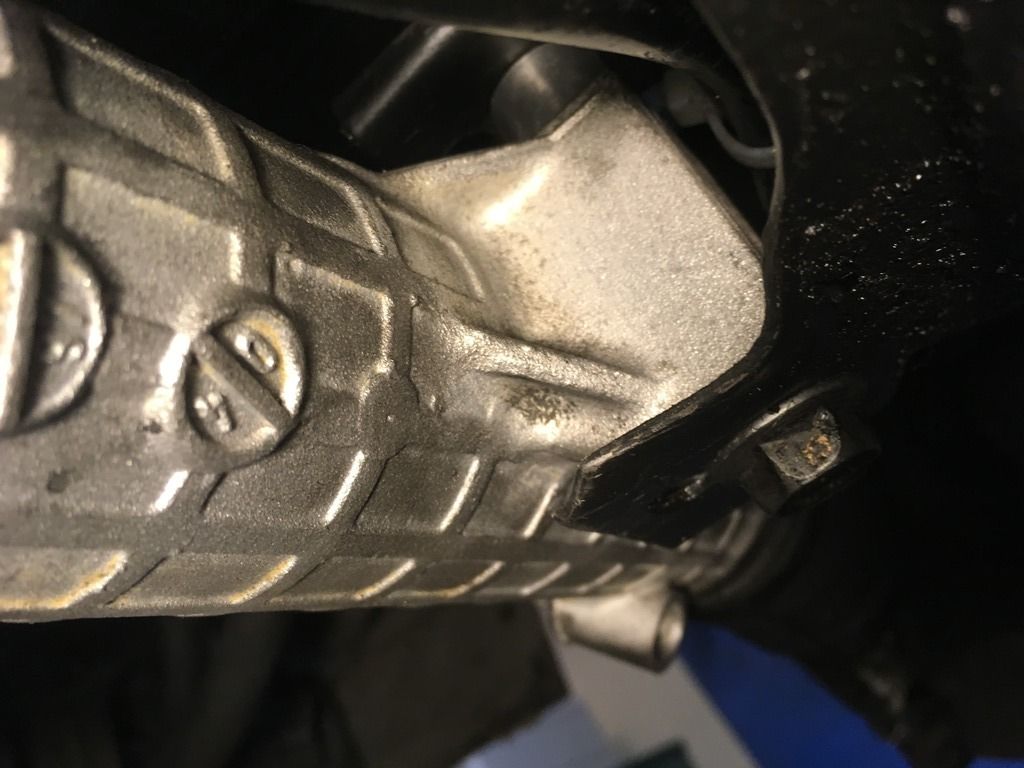

                Went under the car this evening to trace down the power steering fluid leak and found that it is leaking from where the Banjo bolts thread into the rack. It is my stupid mistake, because I re-used the washers I had...
                I don't know how well it can be seen, but ATF is seeping out on the bottom of the bolts. Anyway, I placed on order on rmeuropean.com for the right washers, they should get here soon.

                  For a couple more dollars you can get stat-o-seal crush washers for those. They never leak!

                    Installed the new crush washers that I ordered from RMEuropean and I am happy to report that the rack is not leaking anymore.
