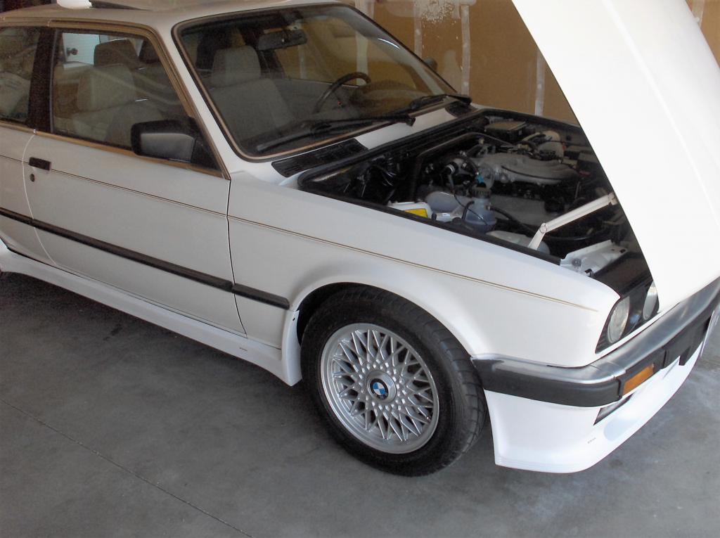

      euro weaves
      I was able to get a really good deal on a set of 5 euroweaves. They were in much better condition than the pictures showed. So I just cleaned them up a bit and put some 225/50/15 tires on. Really made a huge difference in the look of the car.
      This picture shows the m-tech kit on the car, but that is ok:)

            We have nearly identical cars. This gives me a good idea of how mine will look. I'm going with the other style side skirts though. I noticed you didn't trim the passenger side bumper trim in the pic. I thought that was necessary to fit the M tech spoiler?
                Good eye on the trim. The picture is an early test fit. You do need to trim the side trim for it to fit. If you don't it just sticks out and does not tighten down right. I was thinking about leaving it, because I was going to get some chrome euro bumpers. But now I might just go with having the m-tech bumpers chromed....at least look into the cost vrs getting euro bumpers.

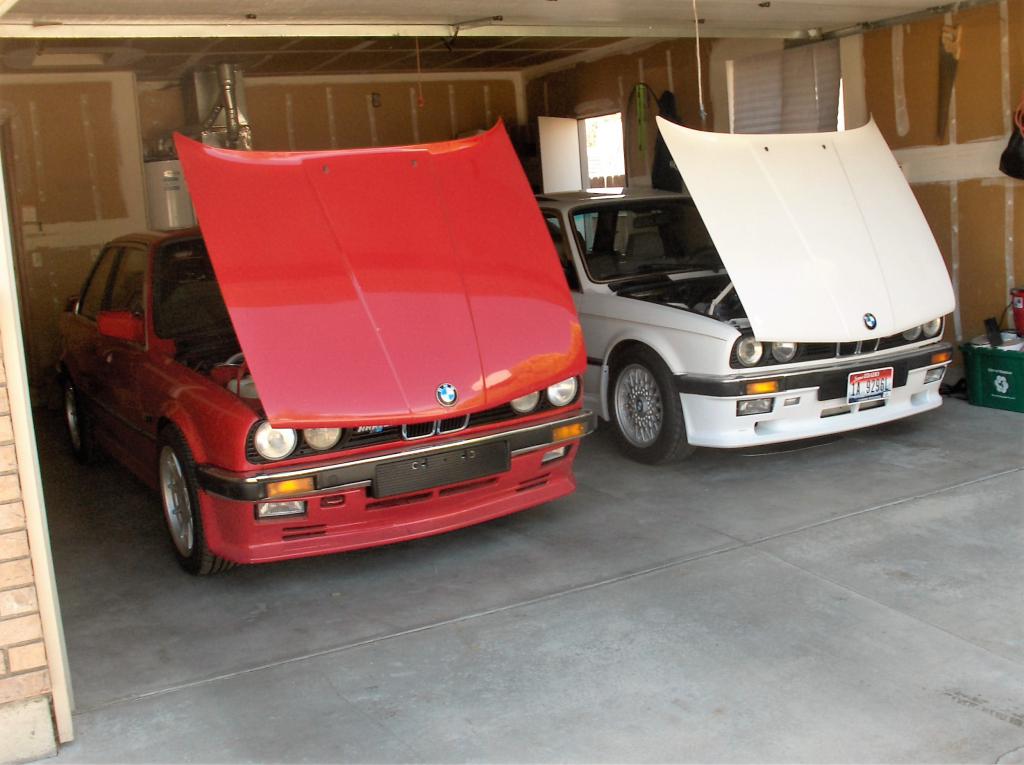

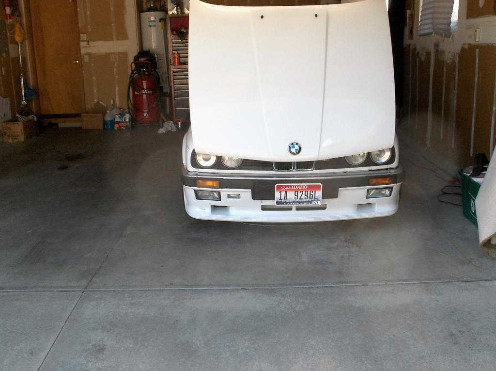

                        The next step was to put the euro headlights in. That was easier than I thought, and the city lights are so nice! Of course my picture shows the front spoiler being test fitted :) I tried the h23 hartge wheels for a week, but found the euroweaves really look better on the m-tech...and I believe are the correct wheels for the car.
                        The euro lights really change the look of the front...now it was time to fit some of the m-tech 1 kit on....lots of fun:)
                        jm

                          current pictures
                          So now I did a test fit of everything, and the rear valance has to come back off. It is sitting about 1/2 inch too low. Have to adjust the brackets.
                          My new favorite picture of the hartge and m-tech also:)
