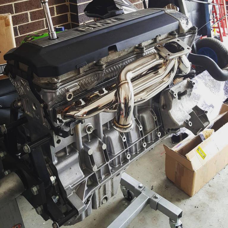

    The plan is to run single turbo on stock internals. To support this so far i have purchased the below:
    - CES copper spacer and cutring gasket
    - Raceware head stud conversion (ARP dont make any for the M52 aluminium)
    - PTE 6262 turbo .82 A/R
    - Tial 44mm Wastegate
    - Good n Tight manifold

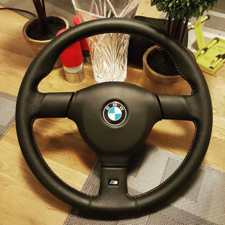

    I managed to source an Mtech2 steering wheel for a decent price and had it re-covered and thickened up slightly. These are becoming incredibly hard to find.

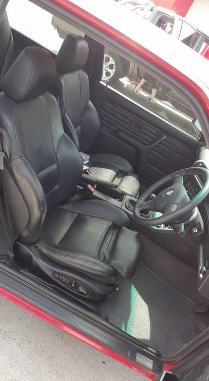

    Following that i also picked up a complete set of electric seats (front and rear) from an e46 coupe. Fabricated custom mounts for the front seats to use the factory mounting holes - none of this dodgy drilling through the floor which is apparently pretty common.
    Rear seats required cutting the mounts out for the stock seats and relocating to suit the new. Also had to trim some of the foam on the lower half and re-trim the leather in order to fit within the width of the e30 chassis.
    All in all took me about a day to do and i'm really happy with the end product:

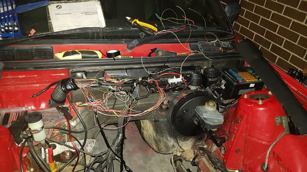

                on Wednesday i started with the wiring. Stripped out the old engine harness and commenced sorting it.
                Started with the e36 harness for the new engine as well, and unfortunately found it had been rather butchered at the DME end. At some point a very old Unichip has been fitted. i thought it would be as simple as just removing it and matching up the wires that had been intercepted and rejoining to the main harness.....not quite. There were multiple cuts, different wire colours used in various place for the same sensor etc.Had to bust out the multimeter and do some tracing with the pinouts for the dme connector but eventually had a restored to stock harness.
                Then i commenced laying it out in the engine bay, trying to figure out where all the relevant wires need to be placed, i.e passenger side, drivers side etc. This took a little time and the e36 harness places certain wire bundles together that do not make sense/work work in the e30 such as the diagnostic port and the coil power connector are bundled together, however the diagnostic port needs to go where the original e30 port was next to the fuse box, but the coil connector needs to be over on the drivers side in order to be able to reach the coils.
                After getting it all sorted i trial fitted under the stock e30 wiring covers and was pleased to see it all fitted relatively well.

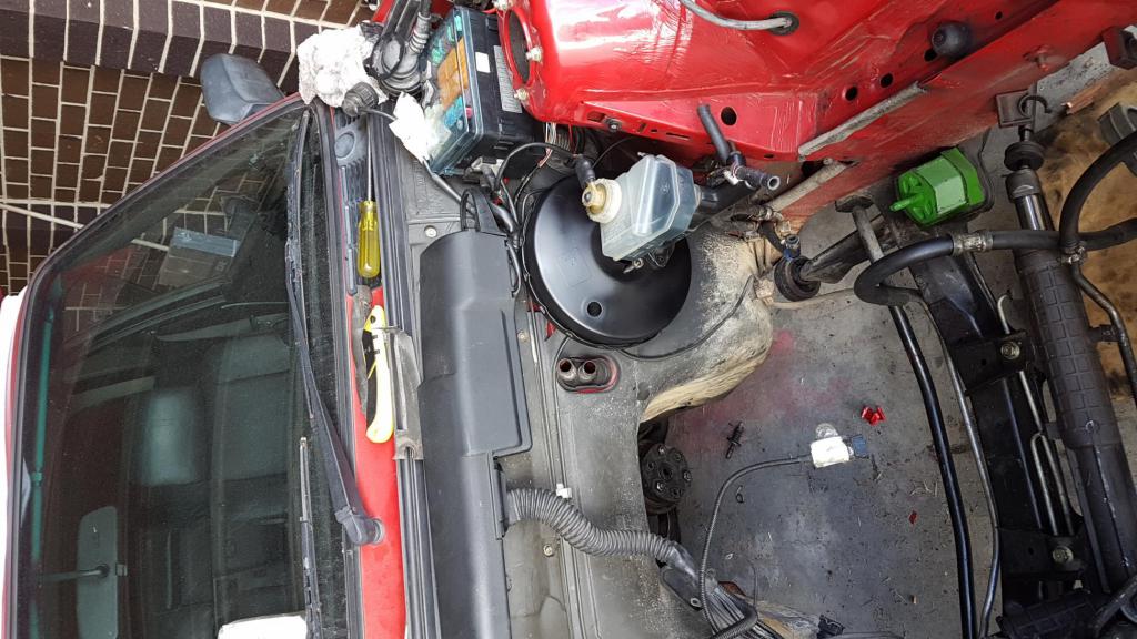

                        Today I decided to fit the Renault Clio booster. This is pretty much a straight swap, however the clevis on the clio booster was about an inch too short.
                        To fix that I just took the clevis off the E30 booster and welded it to the Clio booster at the required length.
                        I also had to cut some of the insulation off the firewall to enable the booster to fit all the way in, the mounting bolts were shorter than the stock E30 so this was require to enable enough thread to poke through the firewall.
                        Finally the rod from the booster sat 20mm inside the booster compare to the rod sitting flush in the e30 booster. To fix this issue just cut a rod of steel to the missing length and put it inside the master cylinder.
                        After that it was all done. No need to bleed the brakes, and the lines just needed a little bending once installed.

                            Wasn't happy with the previous efforts at fitting the wiring under the existing covers, and needed to cull it down to fit the additional M3 wiring cover.
                            started pulling it all apart, trimming unnecessary length, re-routing common wires together etc. While i was at it, i mounted the diagnostic port for the new harness in the stock e30 location next to the fuse box. This pic is the work in progress.
