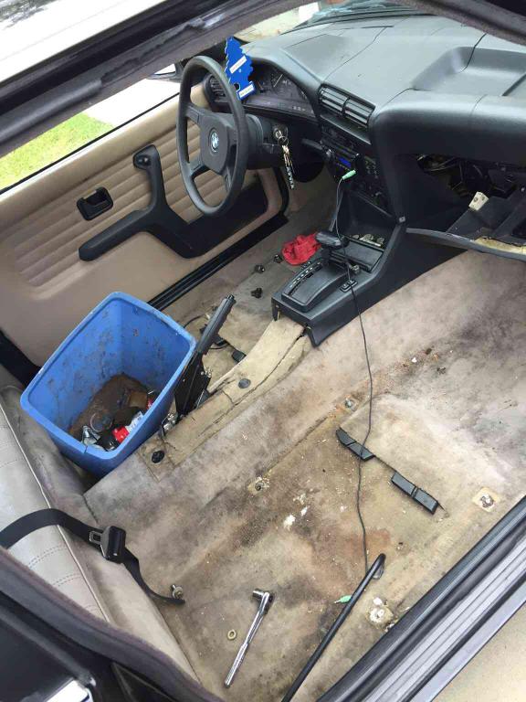

    Already did a deep cleaning on the interiorClick image for larger version

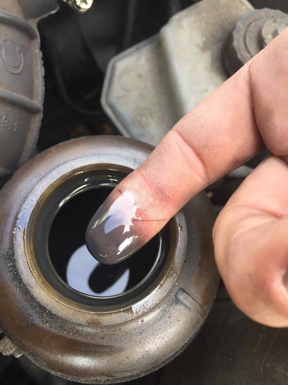

              noticed the power steering reservoir was filled with grey fluid. Click image for larger version

              will be flushing that out tomrrow as well as replacing front brake pads

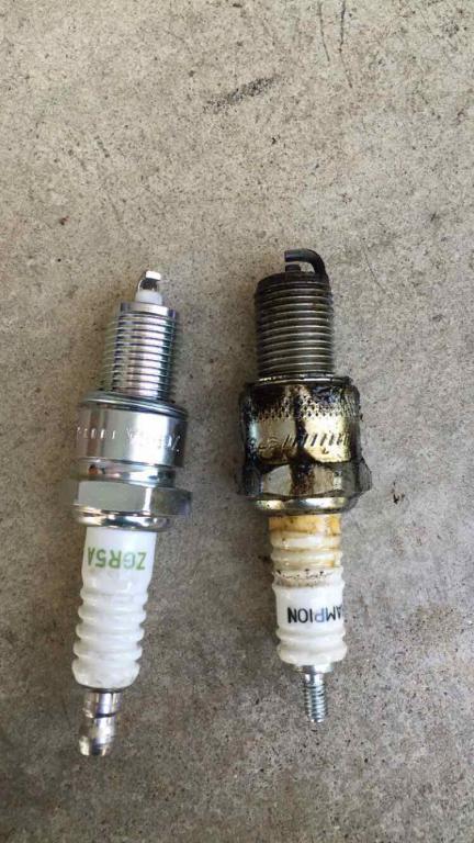

              replaced the spark plugs with NGK ZGR5A, the platinum ones...misfire at idle is gone, but im still getting a loss of power and not sure what to check next
              maybe: dirty throttle body? clogged cat? bad ignition coil? bad ignition rotor/cap? she runs and drives like a dream, but i can feel like shes not getting all of her power out. i can feel that theres more in there haha.
              Also have a ghost leak that I can't seem to find...engine oil on the tranny crossmember. Only wondering because my exhaust is burning it off and it's enough to make some smoke
              any suggestions appreciated
