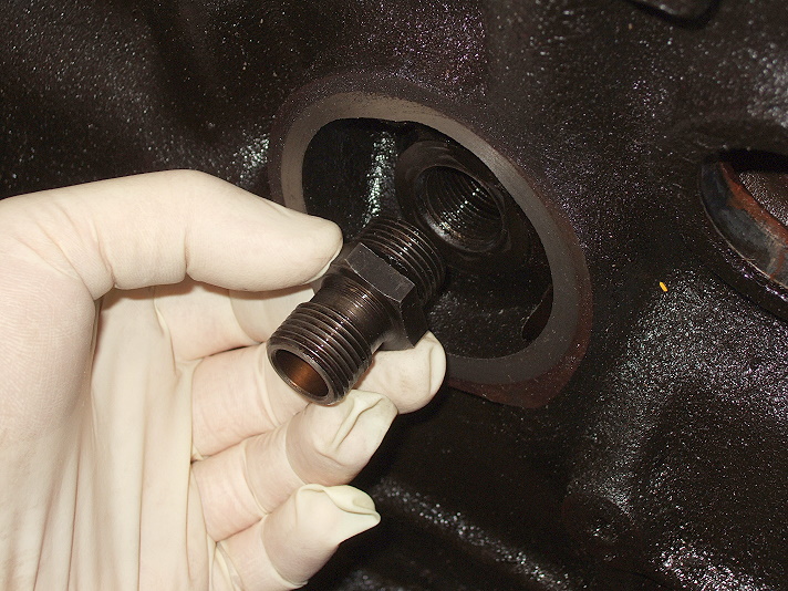

                          Here is how I relocated the oil filter. simple L bracket, 325e oil nut, and the summit relocation kit. It didnt occur to me till after I made the lines that I forgot to incorporate the oil cooler.... the lines will be redone in AN fittings soon. I really want to get 90's on there so its away from the exhaust manifold.
