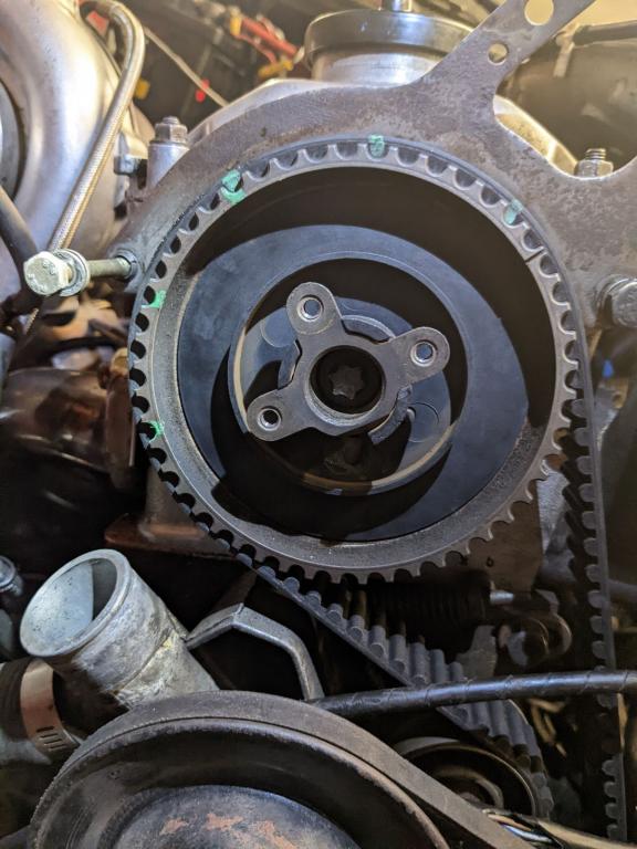

                      • Kelso840
                        • Oct 2016
                        • 49
                        Belt jumped about ten teeth. Guessing it's because I didn't turn it over by hand and let the tensioner take up the slack. Since I'm a lazy person, I stopped halfway through disassembly and reset the timing. Fired it back up and it's.... ok?
                        Sounds surprisingly normal after hearing the valves hitting the pistons yesterday. Need to put the cooling system and exhaust back together and let it run longer. Probably down a couple compression points but that's what the turbo is for.
