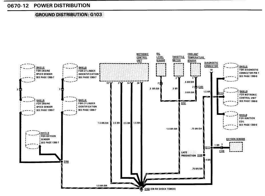

                            Gang,
                            I'm pulling my hair out trying to figure out why my car is no longer running after a trip to the exhaust shop. I haven't called to ask them if they welded anything with the battery on, but I'm running out of ideas as to what my problem might be.
                            I'm attaching 2 logs:
                            7-18-20 was a day or so before it went to the exhaust shop. It was driving nicely considering the open downpipe and my general inexperience with MS tuning.
                            8-5-20 is a log after the car was towed home from the exhaust shop for clutch related reasons. The slave cylinder was failing and leaking out during the week it was at the shop. I did hear the car run at the exhaust shop, so I can't be sure when exactly the operational state changed.
                            The car is an e30 with a hodgepodge turbo kit, used MS2PNP, and was running on TRE 80lb injectors.
                            I'm also attaching the tune it was running at the time. There's bound to be major issues with it, so feel free to laugh.
                            I've since tried a fresh base map, spare crank position sensor, adjusting the variable resistor on the MS board, sent test pulses to both banks of injectors, checked fuel pressure, confirmed spark at the coil and all cylinders, swapped in a spare distributor rotor and housing, etc...
                            One thing I don't fully understand is seeing 12V at pin 19 on the DME connector with the key in the "On" position where I expect to find continuity to ground. Unless that's a DME controlled ground?
                            Do y'all offer some kind of testing service? At this point I'd gladly toss the MS2 in the mail and pay you guys some money for peace of mind.
                            I know I'm throwing a lot at you. Trying to get it all on the table for digestion. Thanks for taking the time to read, and I eagerly await any thoughts or test suggestions I should consider.

                              +12V on pin 19? Pin 19 goes straight to the strut tower ground, G103. Is it possible this was disconnected from the strut tower and placed on the battery terminal? That would be unfortunate. Verify allpower and ground connections in that area because they are easily confused, putting G103 on the battery or a black power wire on the strut tower usually burns the harness at least partially and would likely damage the MS as well. Brown grounds and black positives; gotta love the Germans. The chugging of the engine running on one or two cylinders reminds me of what happens when the wrong spark A output pin was selected in tunerstudio on a car I tuned once, but that is unlikely to be your issue if no tune edits were made.
