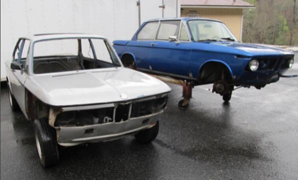

    Hey All,
    I thought I would start a project thread to keep track of the work I've done on the car. This is the first build I've done and am learning a ton. I would also like the communities input so I know when I'm doing things wrong.
    After searching far and wide for a Volvo 142 I settled with the BMW 2002. Similar styles and much more in my price range. I found what I thought was a good clean car on Craigslist about two hours from me and pulled the trigger. Hey it came with a parts car so it couldn't be too bad right?
Name:	Screenshot 2016-11-03 at 8.45.25 PM.jpg
