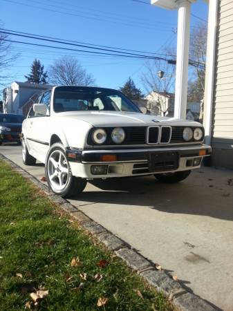

    In December 2015 I stumbled upon a listing on craigslist. This was the main listing photo
Name:	C__Data_Users_DefApps_AppData_INTERNETEXPLORER_Temp_Saved Images_00L0L_1UM9VK7TLbK_600x450.jpg
    The car looked pretty straight and clean, but the list price was over 8 grand. Pass. Come January the car was still listed with now an OBO. I went over to the guys house after work and checked the car out.

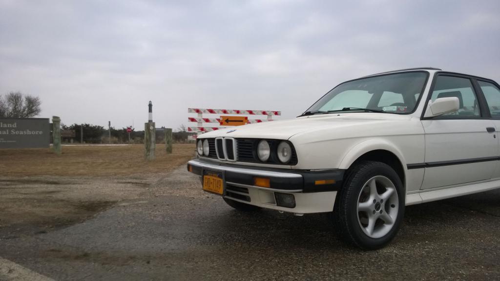

    Walking up to the car I was shocked because the body was just as clean in person. The car did have a bunch of oil leaks and the diff and trans were sweating too but I was undeterred. These were things I wanted to learn how to fix. We test drove the car, and it felt pretty decent. My heart was telling me "BUY THIS CAR NOW." I took a few days to think about it, but I knew I was buying the car. A few days later I called the owner back and we worked out a price. I ran to the bank, took out the cash, sped to the DMV and picked up the car a few days later.

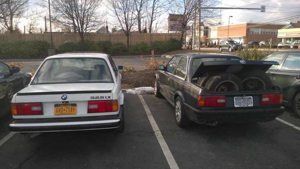

    I drove the car directly from the previous owners house to work. Rich, the mechanic who owned the 325ix that got me hooked on these awesome little boxes, had his E30 at work and I had to park next to him for a photo shoot.

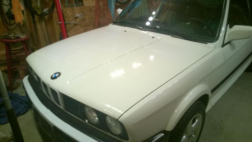

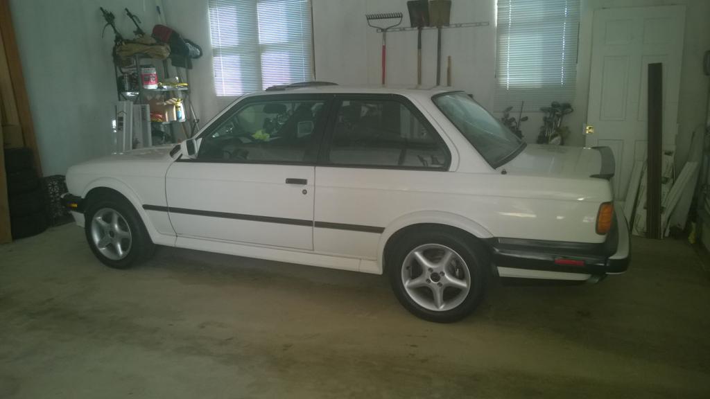

            I cleaned out my garage and rolled the girl into her new home. This was the first time I could look the car over as an owner and not a prospective buyer aka the enjoyment was over :P.
            Here she is resting at the new home

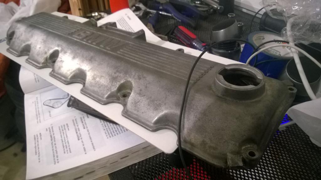

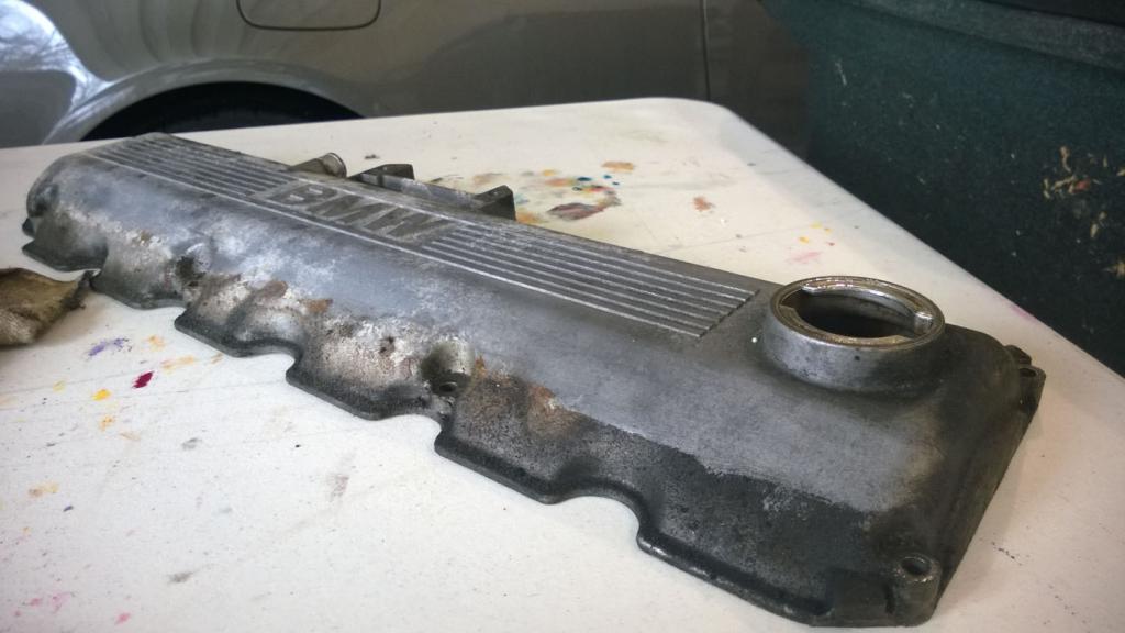

            Remember those oil leaks we were talking about? Well the first one to tackle was the valve cover gasket. The oil leak was bad enough that the cover was covered in dirt and oil
Name:	Windows Phone_20150208_14_14_08_Pro.jpg

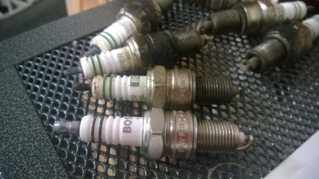

            I pulled the spark plugs while I was in there and found them to be pretty fouled out. New plug can be seen in the foreground

            Soaked the valve cover in degreaser and scrubbed with a metal bristled brush. Finished it off with a brillo pad and more degreaser and sopped up the liquid mush with paper towels. End Result
Name:	Windows Phone_20150211_18_45_50_Pro.jpg

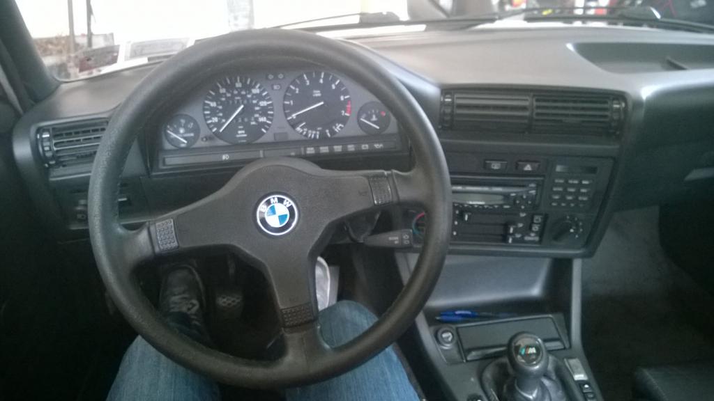

              I had only learned how to drive stick the summer before buying this car and was struggling to get used to the clutch bite point and rev matching on the car. But it was making a very good first impression. Since high school my daily driver has been a Ford Fusion 4 Cylinder Automatic. A bit overweight, very floaty and not a very engaging car to drive. This was the opposite and was everything I was looking for. Maybe a bit slower than I would like but for road use, it is plenty fast.
              I drove the car twice a week for the next few weeks and put 500 miles on the car. In that time I found out the horn was inop (blown fuse, easy fix), the 12 button computer backlights were burnt out, the coolant temperature gauge did not work, the driver and passenger seat adjustments were binding, the ac was not cold and I was losing coolant but had no visible coolant leaks.

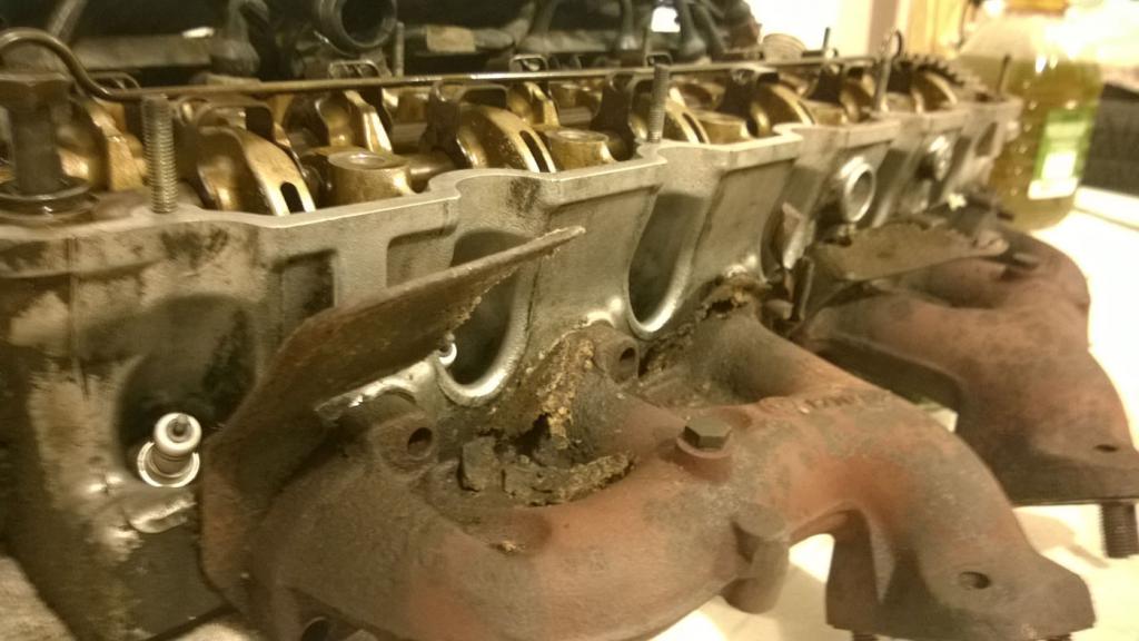

              The coolant loss was getting worse and I occasionally had some very white smoke in the tail pipe so I assumed it may be the early signs of a head gasket. Especially with the temperature gauge still not figured out I went ahead and ordered a head gasket kit. The engine was covered in oil, the belts were very old and it was just time for a general refresh. You can see here how oily the engine head was and how torn up the heat shields for the exhaust were.

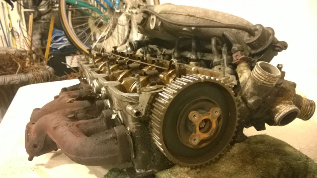

              The pistons had a decent amount of carbon buildup and there was oil leaking out of every oriface. I spent days with degreaser, wire brushes and brillo pads cleaning the block before going any further. I replaced all the oil seals and gaskets on the front of the engine, replaced the timing belt, drive belts, cap and rotor and water pump.

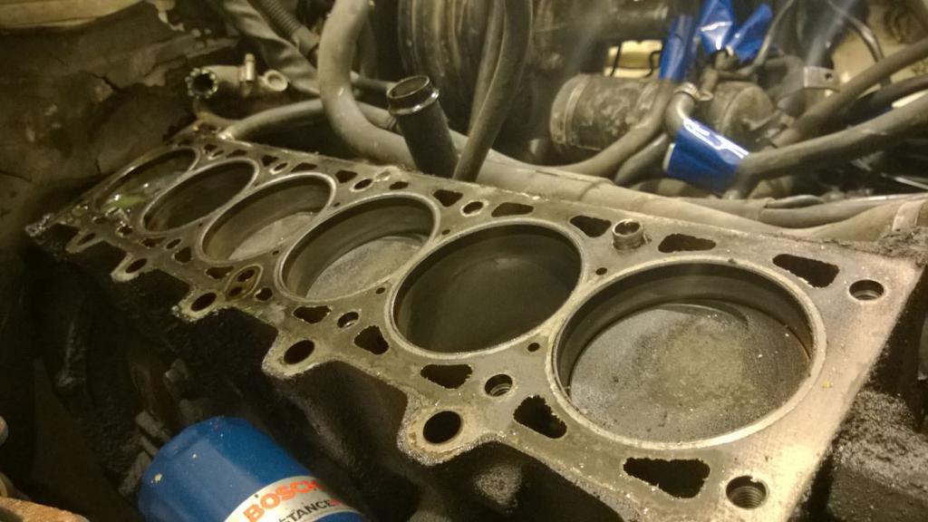

                From Here I cleaned up the carbon build up on the top of the pistons and inspected the cylinder walls; still had the cross hatching and no score marks, so looking good.
                [ATTACH]112491[/ATTACH]
                Inspecting the head, looks like the previous owner was liberal with his oil changes. Free of sludge and only a nice even golden sheen on the inner walls and mechanicals of the head.
