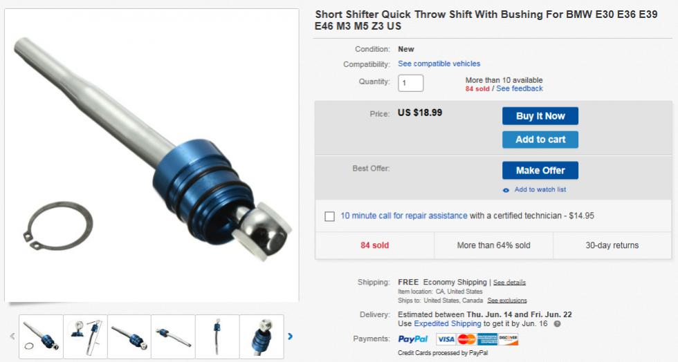

                          Well, I was content to leave my shifter as previously shown for the foreseeable future but I came across a cheap ebay shifter (pic attached at bottom) that I bought a long time ago that I completely forgot about. I figured I would disassemble it to see if I could use anything with it and turns out the plastic cup is the exact same size as oem BMW shifters!
                          I did have to cut a bit a bit off of the bottom of the blue cup mount but this could be a perfect way for those with a super short shifter (e.g. this lever and Z4 and others) to raise there pivot point even to the rod joint to be able to use a straight dssr.
                          The cup fitment was a little loose so I drilled a couple holes with some set screws and that seemed to hold it in place really well.
                          Rod is now applies the force straight into the joint.
