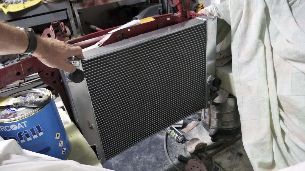

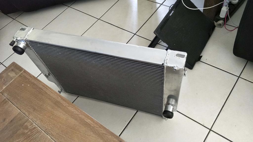

I have been able to buy a couple of things that I don't need quite yet but just trying to get them so they are there ready to put in when I do need them like gaskets and seals for the engine, e36 m3/z3m aluminium radiator, brake bias control knob, tie rod end links, and an m62 intake manifold and throttle body which is a much better design than the m60 manifold.

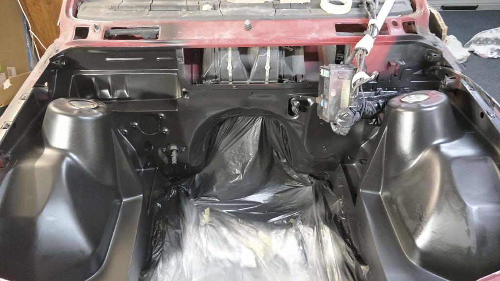

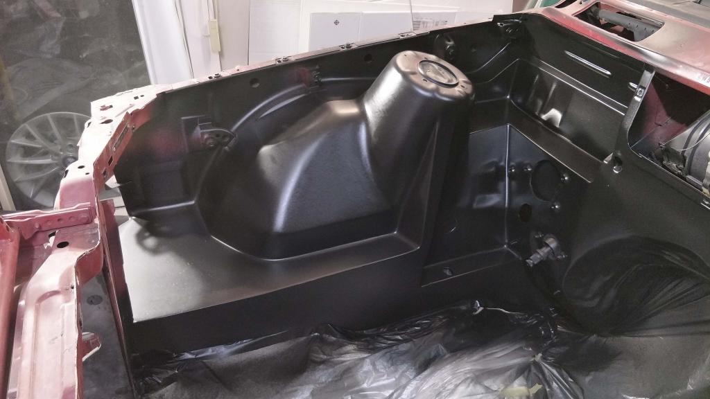

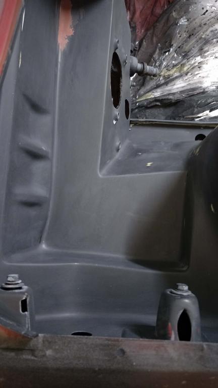

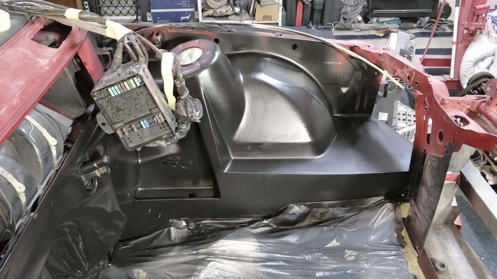

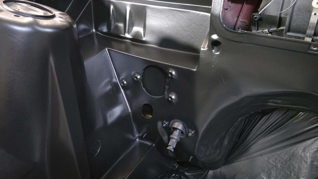

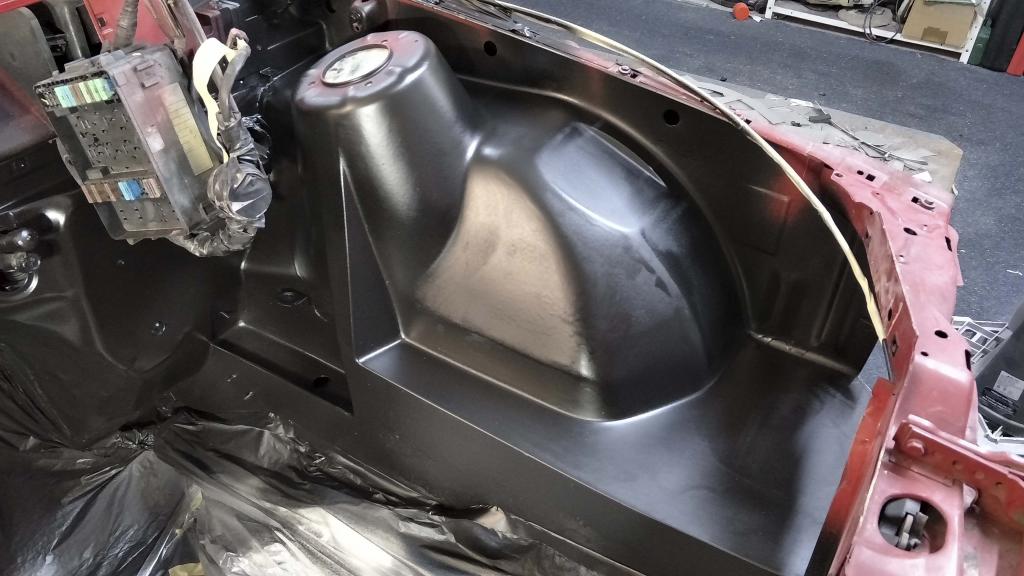

Once I get the engine bay painted things should start to move along pretty quick. I can then secret wire the bay and try and hide the brake and clutch lines as well. Then build the engine, flywheel, clutch, and pressure plate in and get the whole thing in place. Then it will be time for prepping and painting the exterior panels and putting all the interior in. I have a few things to find yet to finish off the interior and I would like to re-trim the seats and door cards as well.

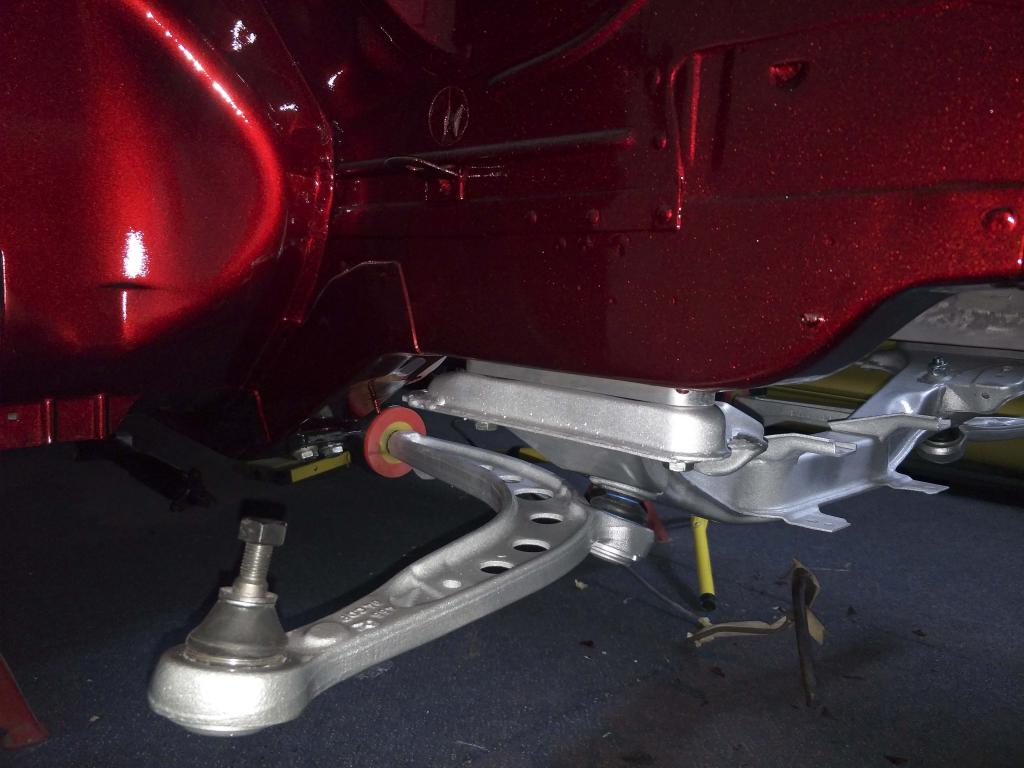

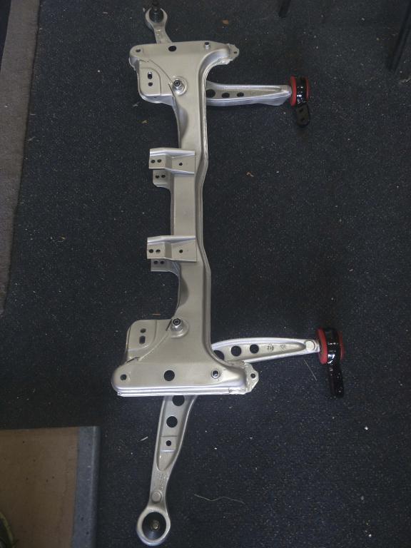

Front crossmember painted in bright silver metallic
Tie rod end links. Don't need the little ones as I have BC coilovers going in

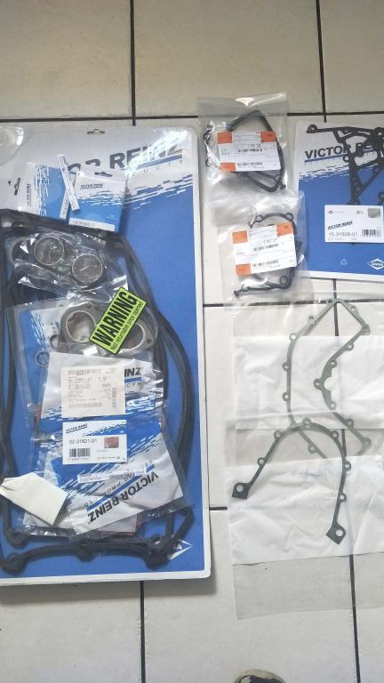

Just some of the gaskets and seals for the engine

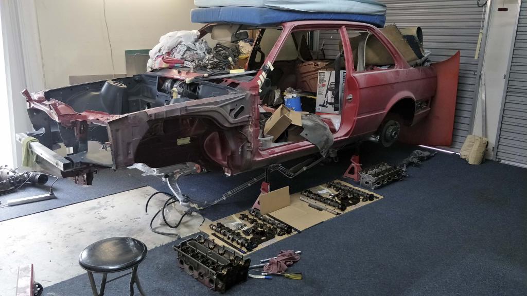

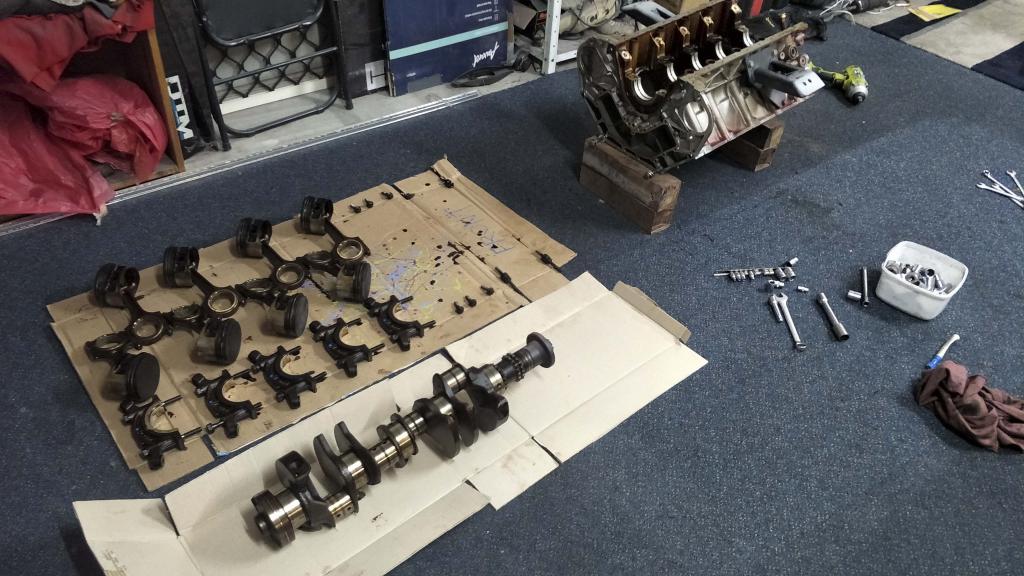

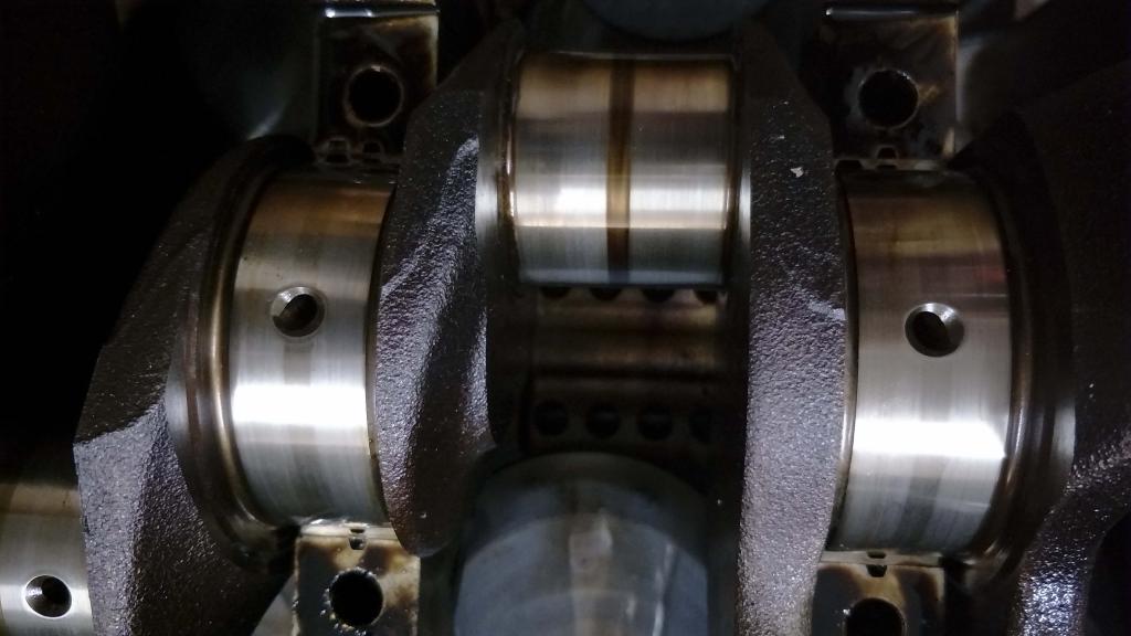

Started pulling the engine down to do new bearings and rings. Heads will be re-built with new seals and guides checked.
Cams are in good condition.
[ATTACH]120619[/ATTACH]
Timing chain guides were in pretty good condition too but they are all being replaced along with the chains.
