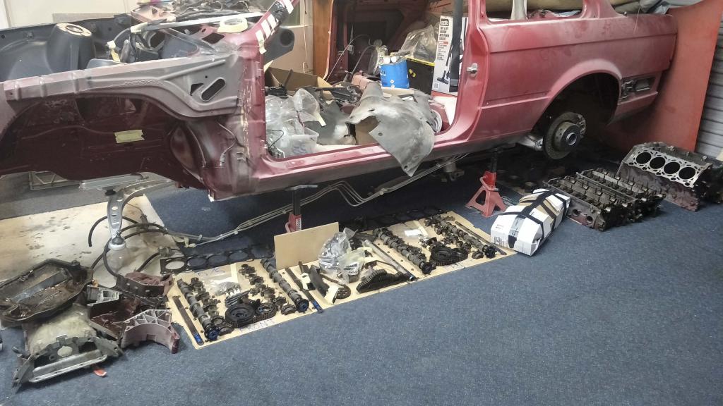

    Couldn't believe how good the main bearings looked.
    [ATTACH]120626[/ATTACH]
    [ATTACH]120627[/ATTACH]
    [ATTACH]120628[/ATTACH]
    5 broken bolts in the valley pan. This will be fun getting these out I'm sure.
    [ATTACH]120629[/ATTACH]
    [ATTACH]120630[/ATTACH]

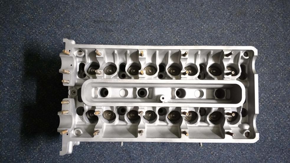

      All ready to take to engine machinist.
Name:	E30 - 25.jpg

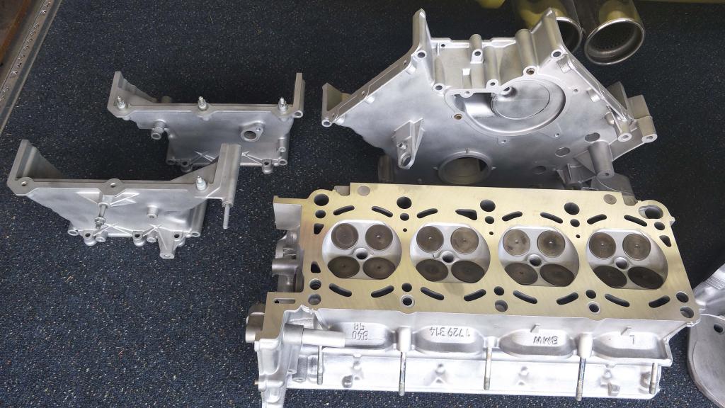

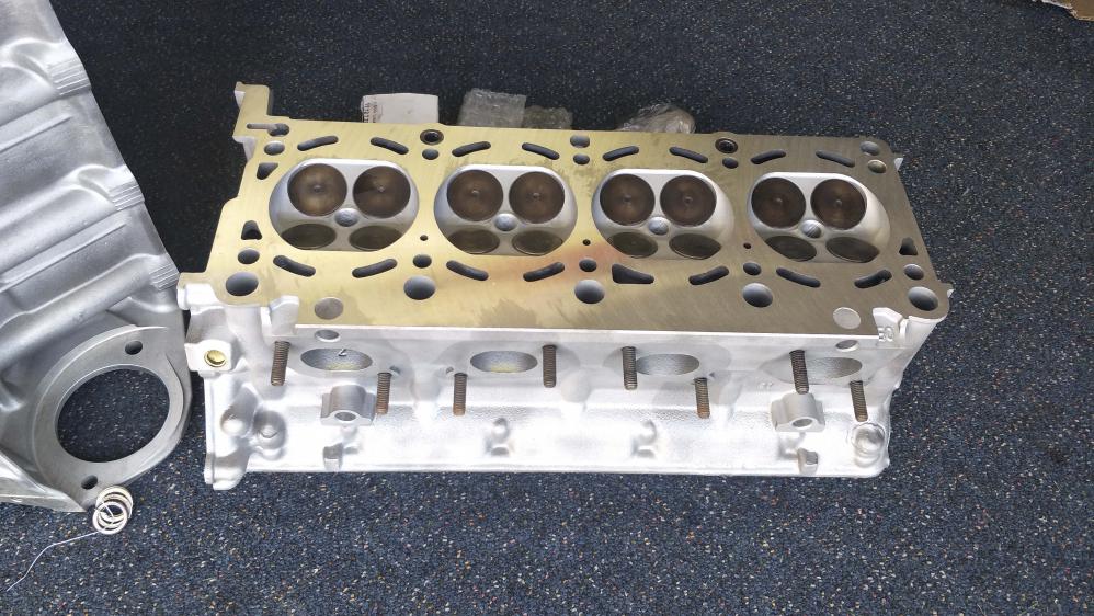

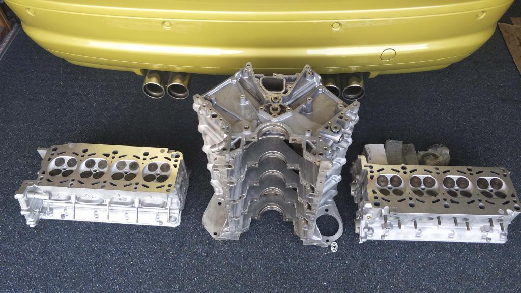

      And a few days later I picked it all back up again. All nice and shiney and new looking.
      Heads and block were skimmed, heads had the oil and exhaust galleries cleaned, valves re-seated and new valve seals put in, They were also pressure tested. The bores on the block were not honed as the engineer said they were in great condition. Oil galleries were all cleaned and new plugs put in.
