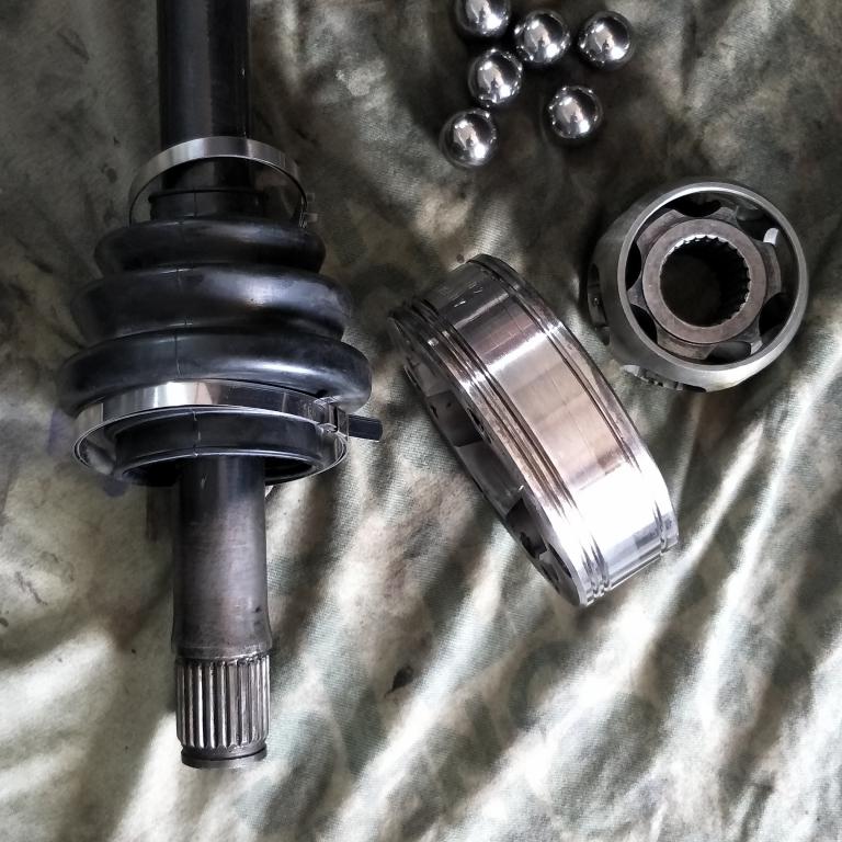

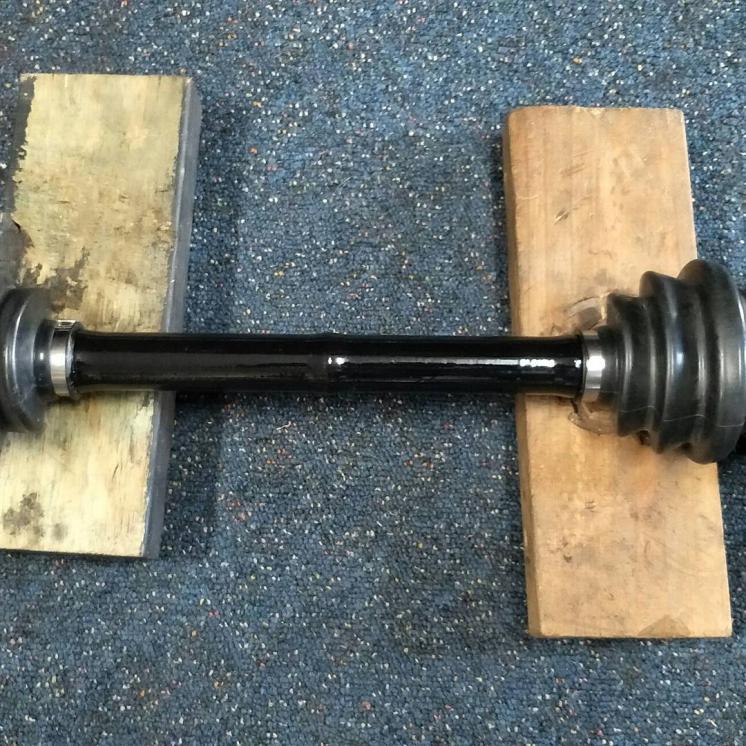

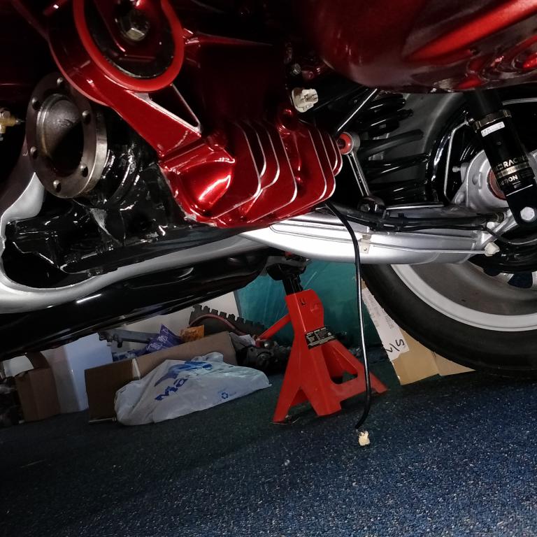

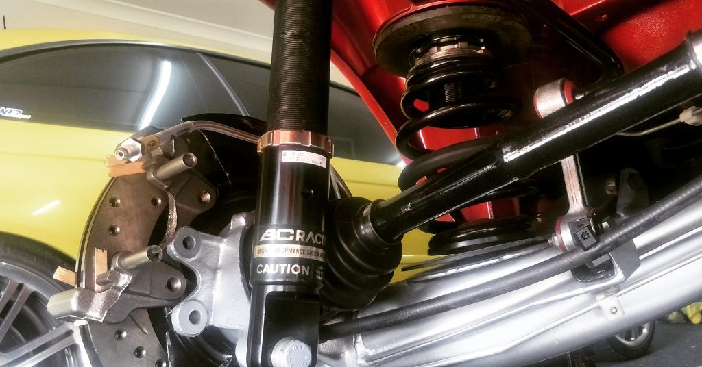

                        Update
                        Been a while since I posted but have done a few things lately.
                        Finally found a tailshaft after so much trouble. Didn't want to pay the ridiculas prices to get one from USA but they are so hard to find here. I know I could get a e30 m3 one, or a 325e, e36 328i or any of these front halves and put with any manual back half but they were just not available. I finally found a 328i one here that had been separated and then painted and put back together without being lined up. I will get this balanced this week.
                        I have nearly got all the rear end back together and I'm working out the brackets for the e46 rotor and caliber upgrade I did now.
                        I also got my headers back from being ceramic coated and to say that I'm wrapped with them would be an understatement. Had them made in 4-2-1 configuration and the fabricator also made them so I can take them off again without having to take the engine out. I can also remove the starter and steering knuckle too without having to pull the engine.
                        I'm hoping to get all of the underside completed by Christmas with the exception of the cover plates and exhaust. I just put new ball joints in the M3 lower control arms I got as I decided not to go with the stock ones and SRS brackets. These and the front crossmember need to be painted and the underside will be finished.

                              Oh my. Everything in here is amazing.
                              Are they stock driveshafts?
                              Also interested in a set of your E46 caliper adapters for the rear
                              (clicky on piccy to get to thread)
