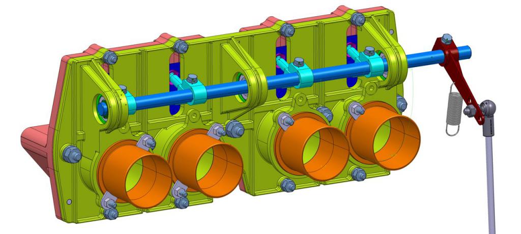

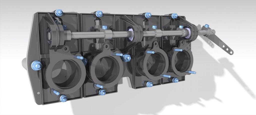

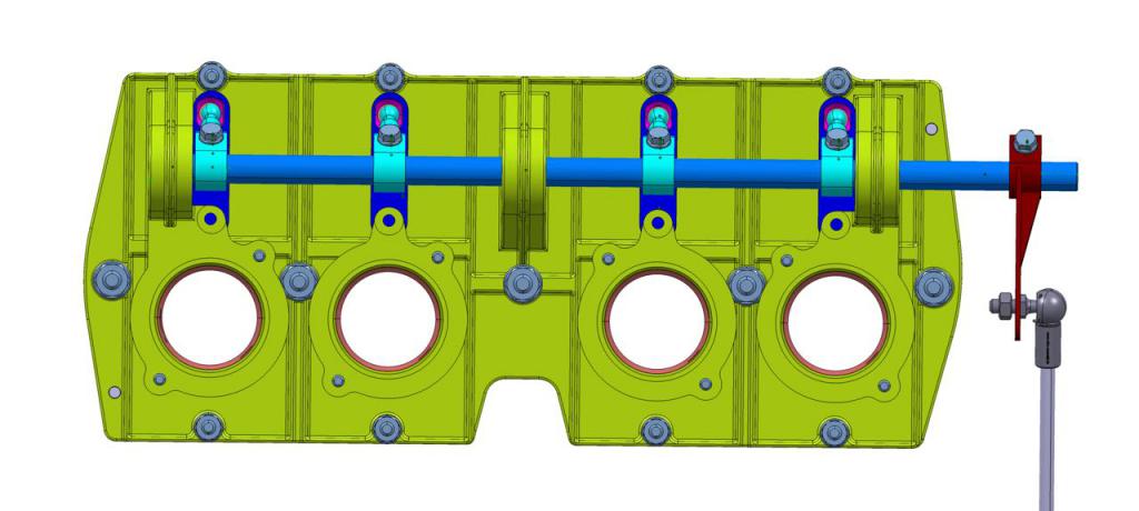

                        #686
                        Adam -
                        This project for a "guillotine" intake on an Alfa 1750 GTAm monosleeve block reminded me of some of the intake development work you did. It's essentially a sliding plate throttle.

                          #687
                          *!Build of the year candidate!* Strange PNW Build: E30+Volvo
                          Originally posted by LateFan
                          Adam -
                          That’s pretty bad ass. I always wanted to design a rotating “camera shutter” (aperture) style opening throttle body. That would flow pretty well I’d think.
