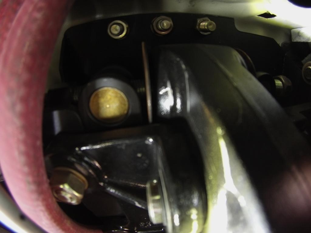

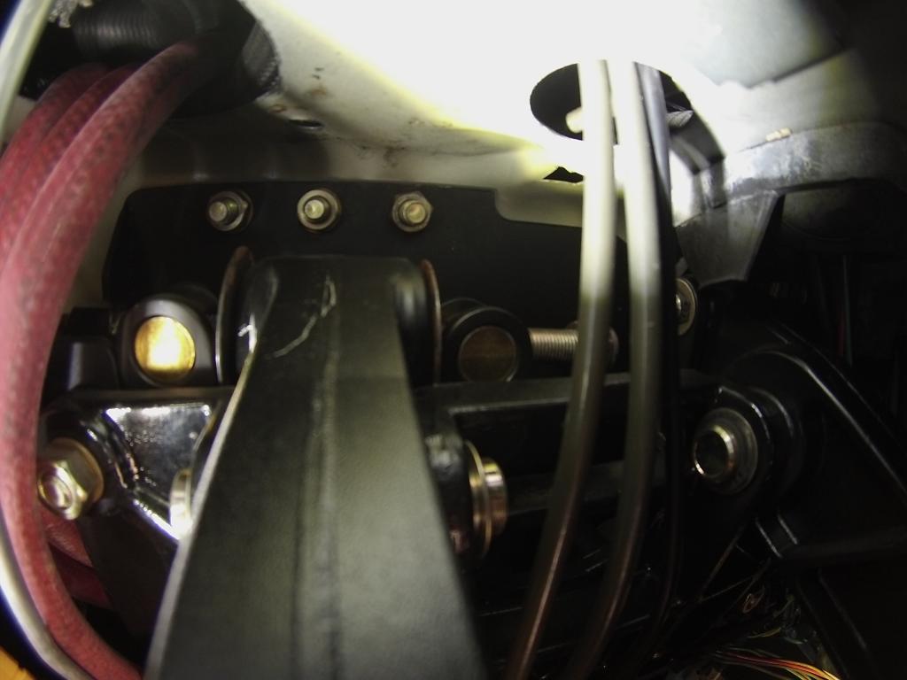

          Not sure if I got a bad bracket here, but the clevis of the wilwood pedal assembly IS touching the mounting bolt of the bracket.
          I'll need to run this by Garagistic to see if this was a bad batch or what, but it's too close to my liking. You can see I actually had to file a corner
          a little bit to make room for the corner of the clevis here. I had to also move the nut that goes on the balance by to the other side, it usually would be on the right most side of the balance bar as thats where you'd connect a remote bias bar cable (can't do it here, as the design of the mounting bracket does not allow it).
          Garagistic - can you guys compare your latest batch of brackets and check for clearance there?
          If there is one recommendation I can make to make this bracket better, and not have interference with the moving parts of the pedal assembly it would be to re-design the side of the bracket or at least that one corner to go UNDER the wilwood assembly and not OVER. This would prevent the clearance issue with the clevis that in the resting position is touching the bracket itself.

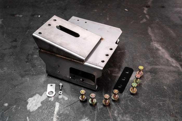

              I am using the pedal box and masters that Garagistic recommends using -
              Wilwood 340-11299 Brake and Clutch Pedal Assembly
              and the compact masters.
              E30 BRAKE BOOSTER DELETE BRACKET (FOR WILWOOD AND TILTON PEDAL BOX) It's no secret. The brake booster relocation is the hardest part of the V8 into E30 swap! The factory booster is in the way. Some choose to use E32/E34 booster setup and relocate behind the headlight. This is costly,

                Update - Got the issue resolved, I think. Removed the pedals again, played with the location and quantity of spacers on the balance bar, shorted the right side end of the balance bar (did not want to risk it touching the Garagistic bracket in it's movement, filed the corner of Garagistic bracket where you can see it was making contact with the clevis. This was causing the interference.
                Pedal now returns fully, and got the clutch bled and pedals aligned to be on the same plane.
                I am concerned with the rubber boot on the MC as it's rubbing against the Garagistic bracket as seen in the photo, this will cause a premature failure of the rubber boot. This is why I think Garagistic should re-design the mount, it should wrap below the wilwood pedal and not sit on the top and interfere with the moving parts.
                Also, wrapping the harness under the column is an absolute must....really tight fit against the bracket on the top left corner under the column. This is even with removing the oem harness holders to try and move/push the wiring as much to the left as possible.
