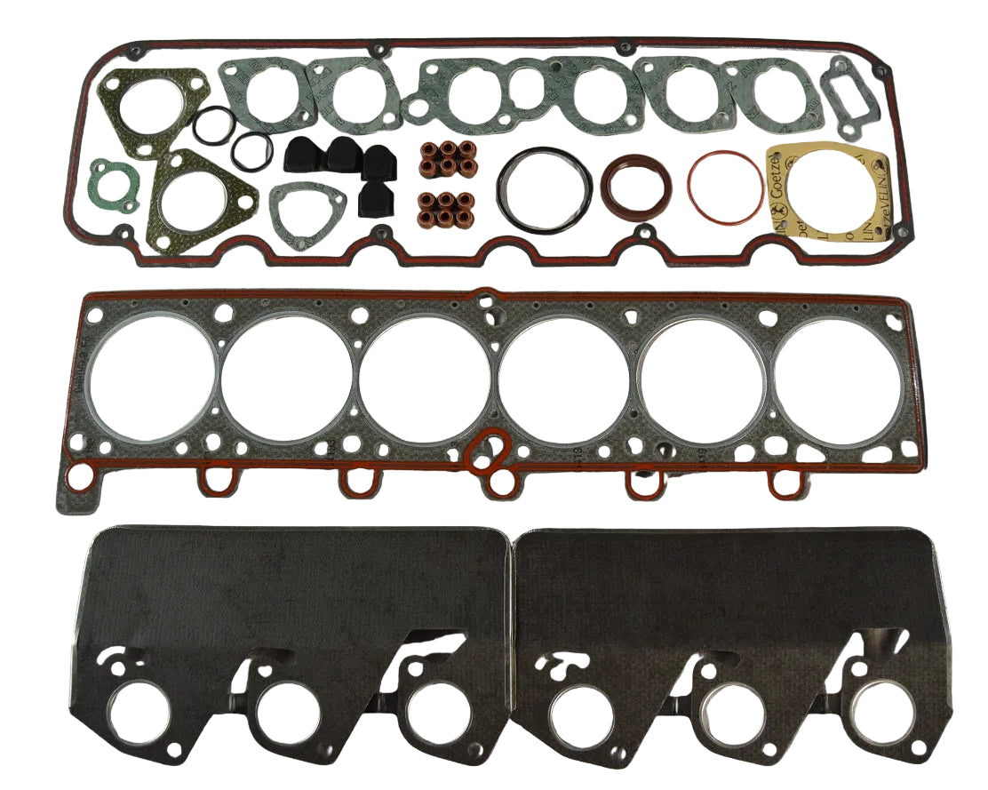

          I’ll be dropping the head off to get rebuilt in the next couple weeks as well as hitting the purchase button on a top end gasket kit. I was looking at the package that bimmerheads offers. Has anyone picked up their “M20 ultimate head gasket set”?
          BimmerHeads exclusive Ultimate head gasket set! Be sure to pair with a set of new OE BMW head bolts or an ARP head stud kit. Both available in our store.
          I see CATuned has a similar set up for about the same price.
          Any suggestions before I purchase anything?

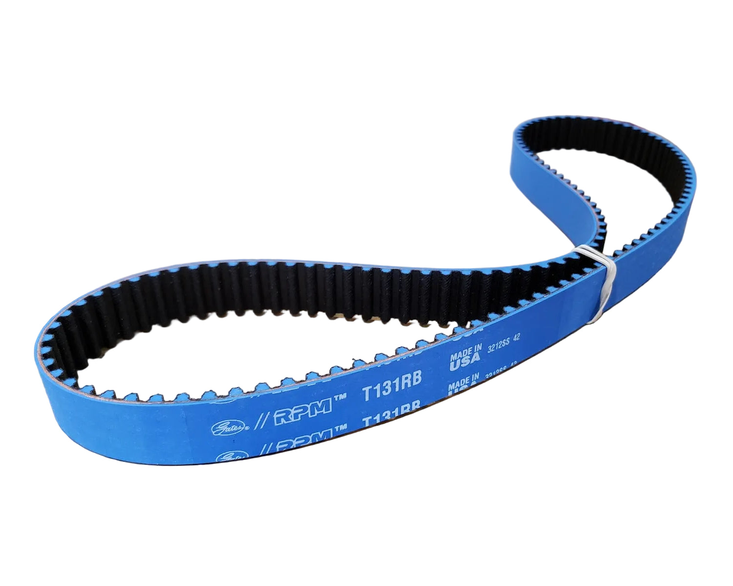

          I also see a price difference in the Gates timing belt but they seem to have the same part number T131RB. Does anyone have any idea if there is any difference in the two besides the vendor?
          Bimmerheads:
          No other belt protects your engine while delivering powerfully high performance like Gates Racing (RPM) Timing Belts. Available with water pump and tensioner.
          Catuned:
          Thanks again always looking forward to anyone’s advice.
