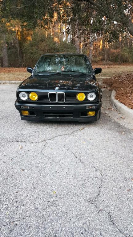

    I am kinda new to the BMW car scene, this is my FIRST Time buying/building a BMW E30 and I must say I am pretty please with everything I've done so far.
    Everything underneath the car I've replaced with some help of my cousin and friend; new engine, struts, rotors breaks, break shoes, break lines, and much much more!
    now it's time to update and refresh the interior, I recently was gifted a NRG wood grain steering wheel and I must say IT'S THE BEST THING EVER!
    I am open to all and every suggestion!
    a few things I need help with finding and fixing would be:::
    1.) door locks for sale? no doors lock
    2.) break light stays on?
    3.) head liner for sale.
    4.) best place to buy rims ? lol
    I've been checking on e-bay just seeing what other options are out there.
    I'd love to see what everyone is working with!

    Thats a good looking model!
    1- Once you have the key Im sending you, you can repin the other locks. Im sending you extra pins too. That link also has a bit of a walk through, so you can at least lock the car!
    2- Brake light switch probably needs to be replaced. If you tap the brake pedal do they turn off? Its a cheap part and easy to replace if you crawl under the dash
    3- cant help ya there
    4- wheel/tires forum here has a nice selection. what style are you looking for?

      Welcome! Car looks pretty good, any more pictures?

        1. probably the central lock relay behind the drivers speaker
        2. brake light switch
        3. post a wtb thread or search
        4. look at the wheels FS section

          Car looks good man! But I can only think of one thing that could make that pic better...

                Great looking car. What are your plans for it?

                  Hey there, welcome to the forum. Great looking car. As posted before, any more pics?
